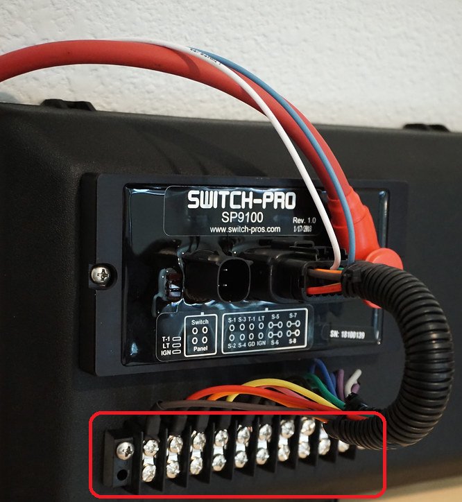

    Caribe,
    This has no bearing on how one chooses to setup the system. This is the factory part to replace 16 pin connector on the harness. This is for the 8100 only. It appears from the pic above they have redesigned the 9100 plug arrangement, possibly separating the control panel harness, so this most likely will not work for that device.

    It sure does. With the terminals you just crimp and insert the wire from the added accessory....
    And it IS the same connector...wiring/pin-out is different.

    Yes, in theory you could do that. I ran my outputs to two separate Deutche connectors and two dedicated harnesses out to accessories. This way I don't have to mess with the connector ever again. The small plastic clips inside the connector that hold the conductors are quite fragile.
