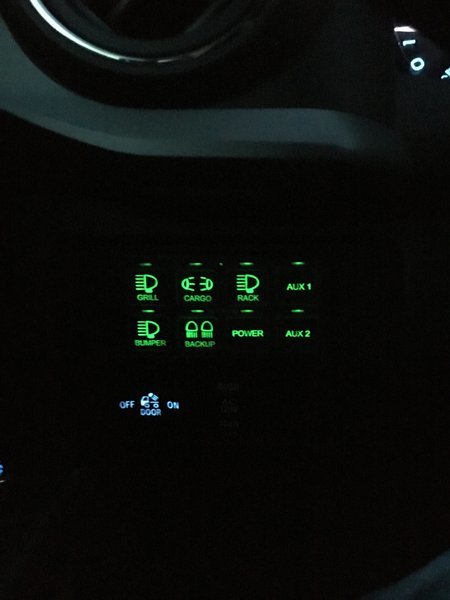

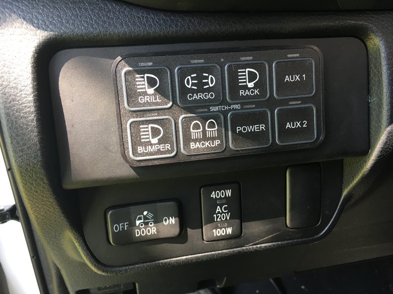

    image.jpg image.jpg image.jpg Mind the finger :)

    Do you have more pictures of how the flush mount panel is mounted to the dash? I've been trying to figure out if you have to cut out a hole only slightly smaller than the switch panel or if it just needs a hole big enough to run the wires through.

    Ordered my kit from @SDHQ OFFROAD via @tubbsisland
    They make a custom panel for the Switchpros controller to mount in cleanly and instructions are very clear.
    Cliff was super helpful and @JerryTaco provided some tips and inspirations from his build.
    Definitely recommend reaching out to these guys if you're looking to install this system!

    We offer a pre laser cut OEM panel for the 3rd gen Tacomas to fit into the location others have posted in this thread. @WhiteBeltBatman is running this exact kit. Shoot me a PM and we can get a panel out for you. We also offer this complete kit on our website for those interested in ordering complete.
    http://store.sdhqoffroad.com/8-switchpowerpanelwithconcealedmountinghardware-1.aspx
