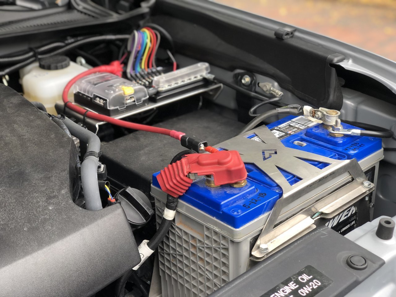

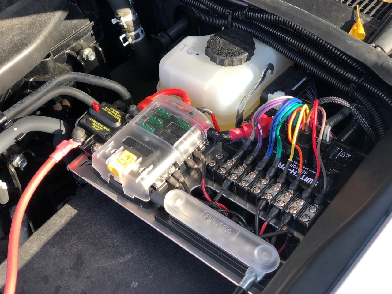

    The best upgrade and money I’ve spent on the new truck so far. Built my own wiring harnesses for everything and it’s all just so clean and perfect compared to my last truck.
    I’ve since cleaned up some wires from these photos, and added the correct terminal strip to the power tray.
    My question is what blue sea breaker and amperage is everyone using from the 12+ to the switch pro from the battery? I want to do away with the inline fuse so I can shut off the switch pro and all added circuits entirely to trouble shoot if I need to.
    Also I love how you can setup things in app like wether or not things will work off the battery or the ignition.

    1) Has anyone else had problems with water mounting the SP horizontal? It seems like most people go that route and I have only seen 1 person with corrosion problems from mounting horizontal even though the company says not to.
    2) I read no wiring winches to it in the manual but saw a few people had done so- guessing that’s a bad idea?
    3) It’s programmed as an on/off switch so I should be able to wire an anytime camera to it easily correct? Has anyone done this?

    Can’t answer your question about the winch but I have mine mounted horizontal. I’ve had it that way for about a month now. Saturday I was under the hood re-wiring a few things and I did notice what looked like a little spot of discolored water/corrosion on the module right around the 12+ connection from the battery. I cleaned it off and I’m going to keep a close eye on that. I was starting to think some water was laying in my hood scoop and when I opened the hood some time before it ran back and dripped right over it. But not for sure.
    As far as the backup camera, yes! You can wire it to the switchpro just like any other switch. You’ll need the little diode thing a gentleman sells on here to install behind the radio if you’re trying to run the anytime backup camera mod if you don’t have it already.
    I haven’t done this but it can be done easily. I had a 2016 with that and I never needed it much so I didn’t add it to my 17 build.
    (Edit) I’m thinking about adding some washers between the rear two mounting bolts between the switch pro module and the power tray a lot of us use just Incase any water does get on it it won’t lay and will run off. The switch pro module is kind of cup shaped slightly.
    If you zoom in on my photo under the 12+ to the module you can kind of see the cloudy stain.
