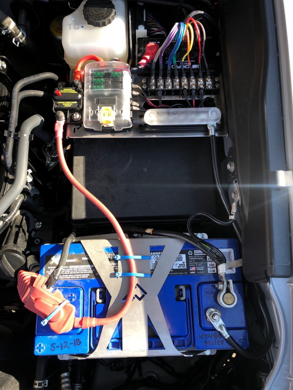

    The light blue wire calls for ignition. Which I tapped in below the power tray into the replay box with a mini fuse tap to the injector fuse.
    The white wire is tapped into the same box under the low beam fuse with an add a circuit as well.
    If you want to use the trigger wire for anything it is pink and you can use a mini fuse tap (add a circuit) for that as well to whatever you want.
    The extra fuse block is for things not wired to the switchpro like my 12v bed plug, volt meter and bed light under my badrack and tent.
    https://www.amazon.com/dp/B00I0MWPXU/ref=cm_sw_r_cp_api_Q8I6Bb8P2K2MP
    I cut a little notch under the lid to pass the blue and the white wires through. Going to hook the trigger wire up to the high beams to active the roof bar sometime just for fun.

    So I followed your tap locations last night and they worked perfectly. But this morning I was having some issues with the panel not sensing ignition while driving. After some troubleshooting I figure out that tapping the 10A AC fuse only works for ignition if the AC unit is on. Swapped the Ignition tap to the 10A injection fuse and no more issues.
