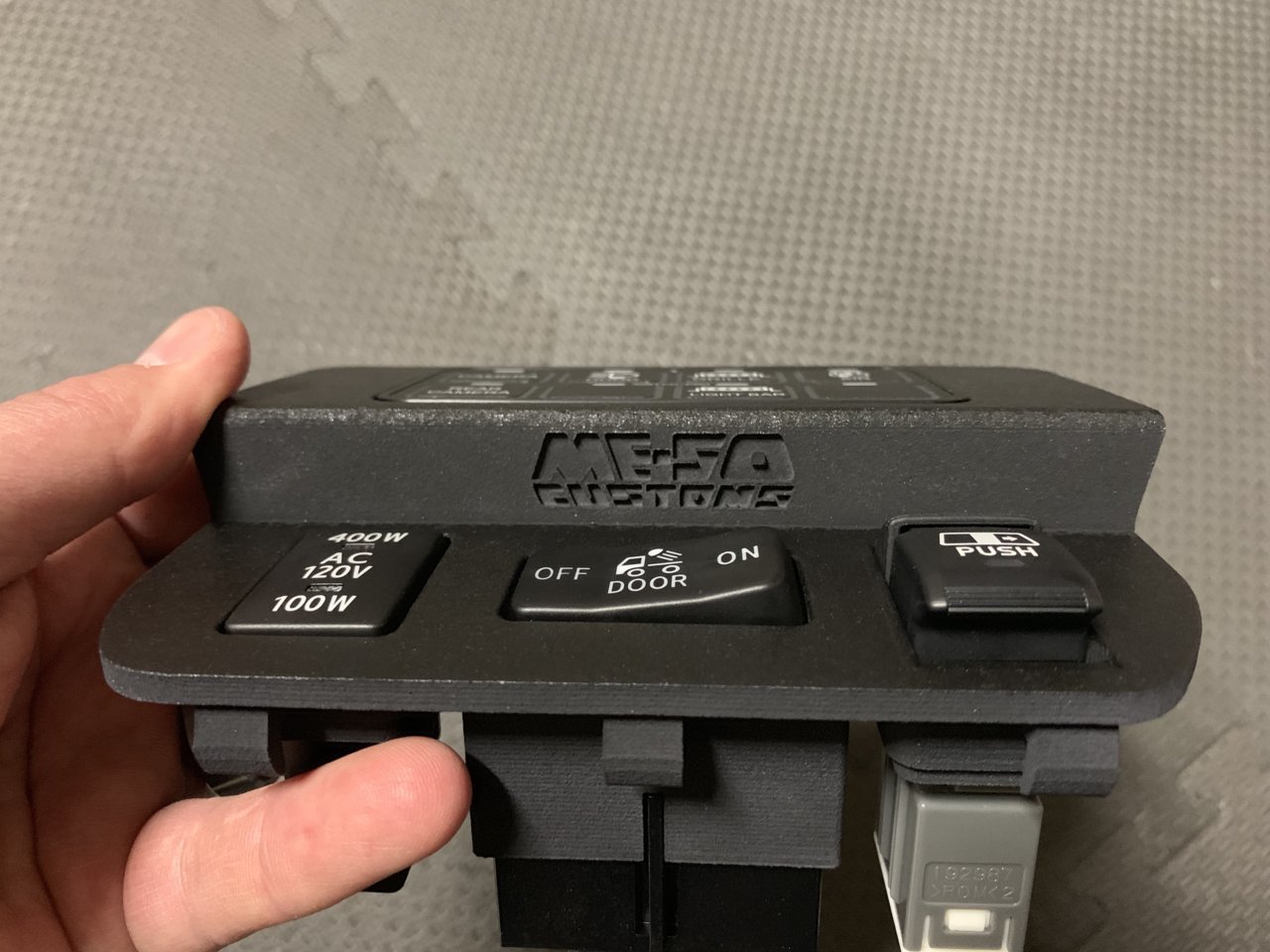

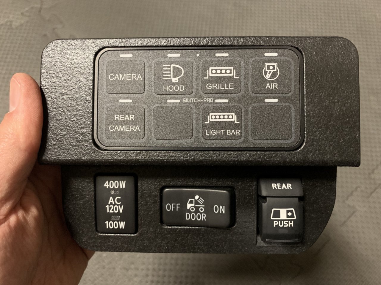

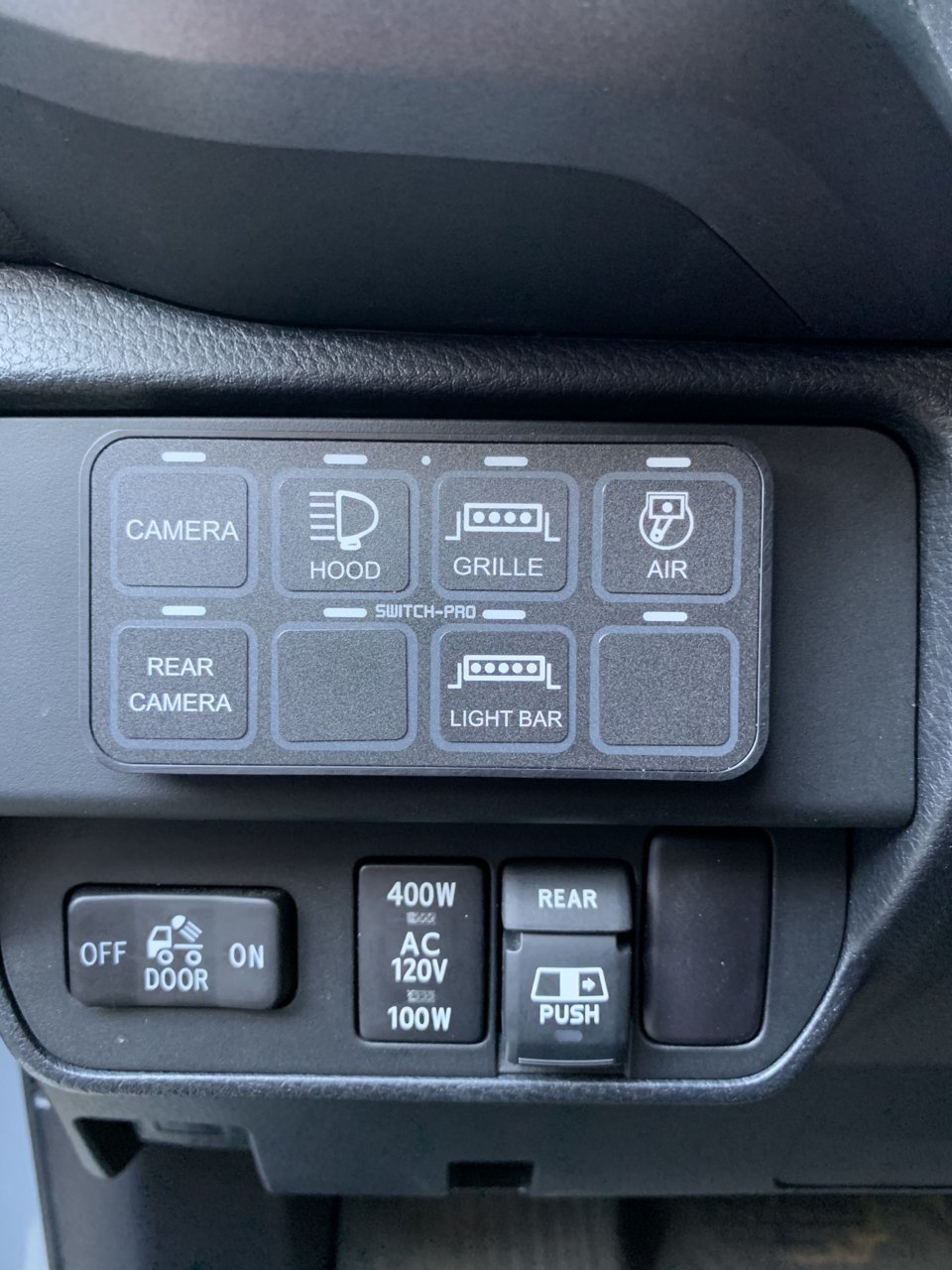

    It comes with a camera button and a rear camera button.

    Same. Cant believe no one is making customs for this yet.
    Want one that says front camera. Have not gotten around to installing yet but in the manual it says you can configure as a sp3t switch. But no information out there. Ideally id love to have 1 press camera power. 2 press rear cam. 3 press front cam. Doubt it will be able to configure that way however.

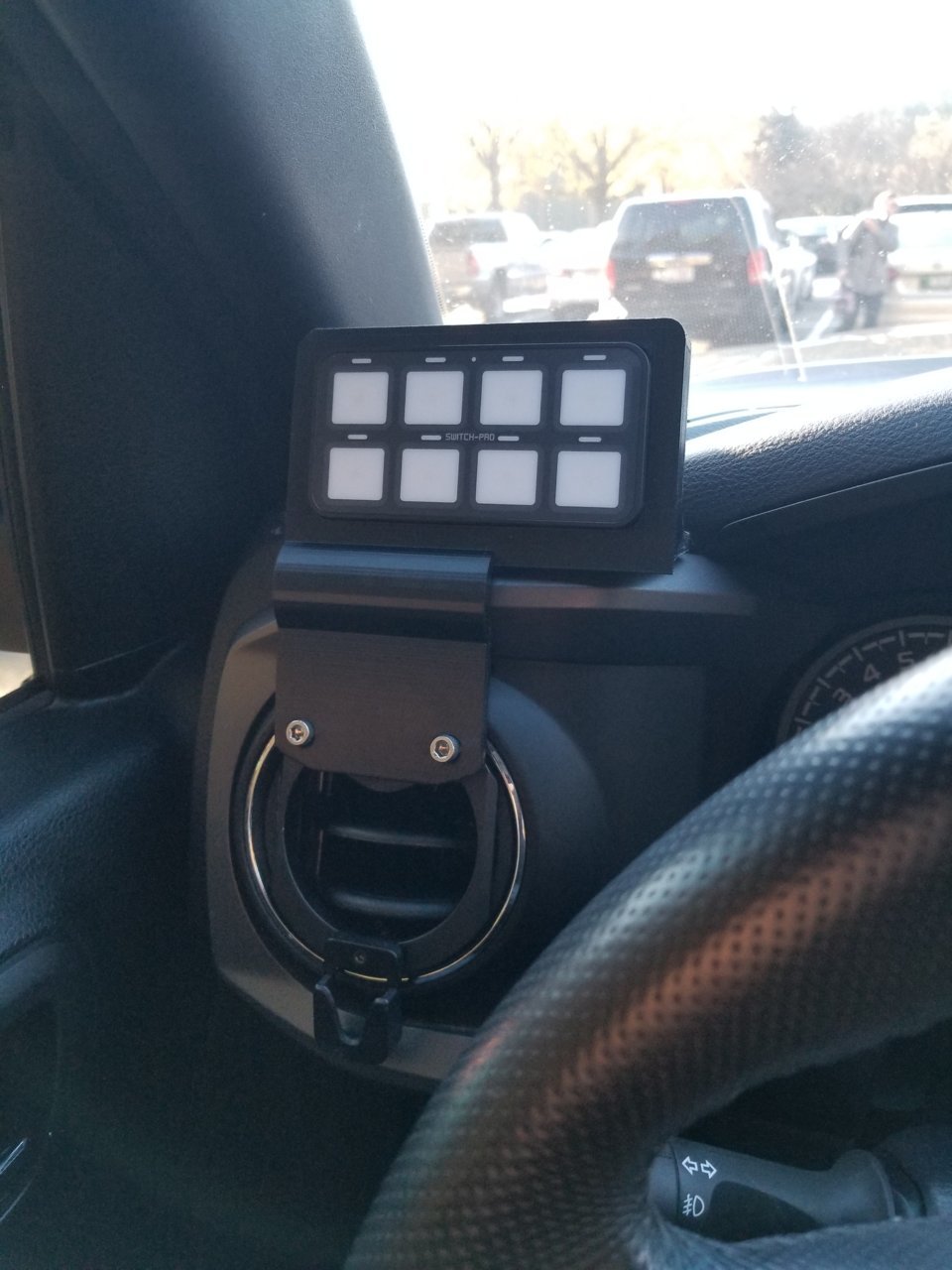

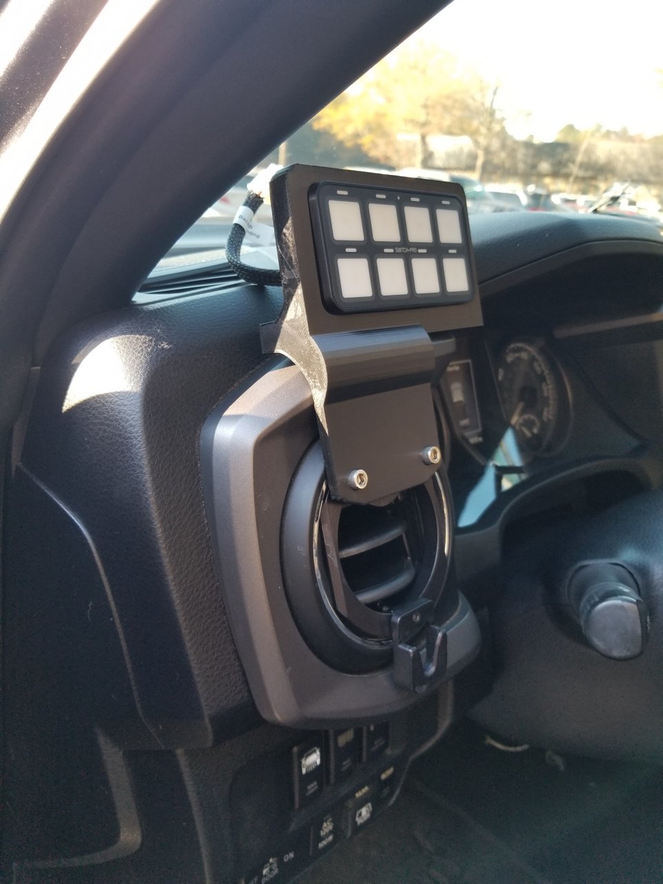

    What do you guys think about this alternate placement for the switch panel. Still waiting on the powertray to come in for my install, meanwhile looking for how I want to mount the panel. I have a sunroof trd offroad, I like the upper near the center console but I really want to avoid drilling holes in the headliner. Also, the lower left switch panel I also dont like, the steering wheel blocks view of half the switches (have a 3 switch panel there now and I HATE the placement). Giving this route a try, still not 100% there yet, still playing with matching the contours of the dash and perfectly fitting the switch panel flush. With piggybacking off of the hondo unholey mount no adhesive or drilling, pure bolt on. Also with longer screws can still run a RAM ball. Curious everyones thoughts on the concept, still a ways off till I think its perfect.

    How are you going to run the wires from the panel? I personally change the direction of that particular vent quite a bit... but maybe that's because I have the Hondo mount on the right side of the steering wheel and that vent is essentially locked in place.
    I know what your saying about the switches being blocked by steering wheel. I tried to overcome this by placing switches that I'd be likely to turn on while driving to the far left, and then ones I'm likely to turn on while stopped to the right.

    I dont think itll be a problem sneaking the wires through a gap somewhere near the A-Pillar / Windshield area. I plan on using all 8 switches most likely, and the 35A switches are on the right directly blocked from the steering wheel. I have accidently turned on my rear lights while fumbling for my rock lights switch or any of the others and completely blinded the wheeler behind me on many occasions. I just hate the placement down there.

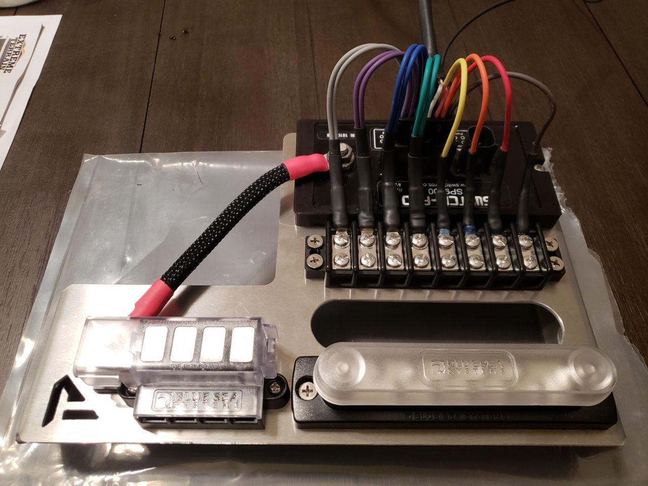

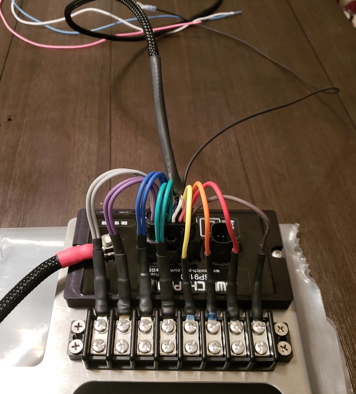

    Finally got mines installed. Still working on how/where I want the final resting place for the switch panel to be, but I am fully functional finally.

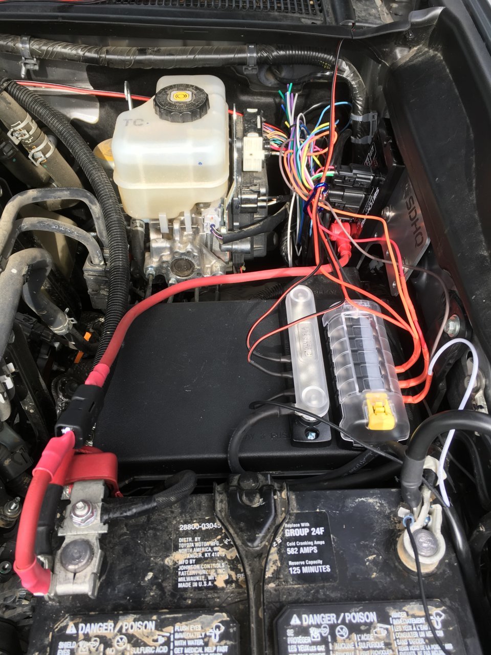

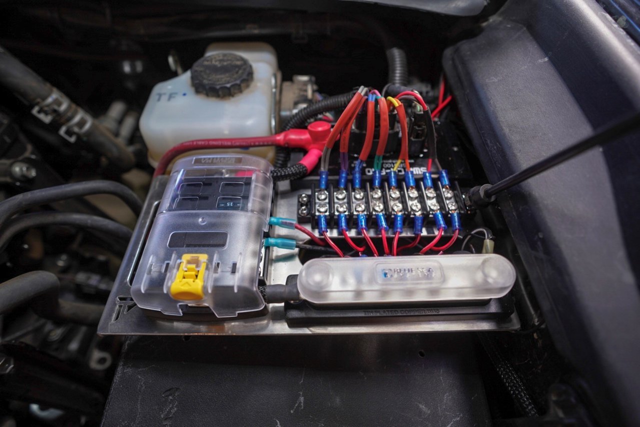

    I finally got my Powertrays mount and Blue Seas accessories to upgrade my under hood setup as well:

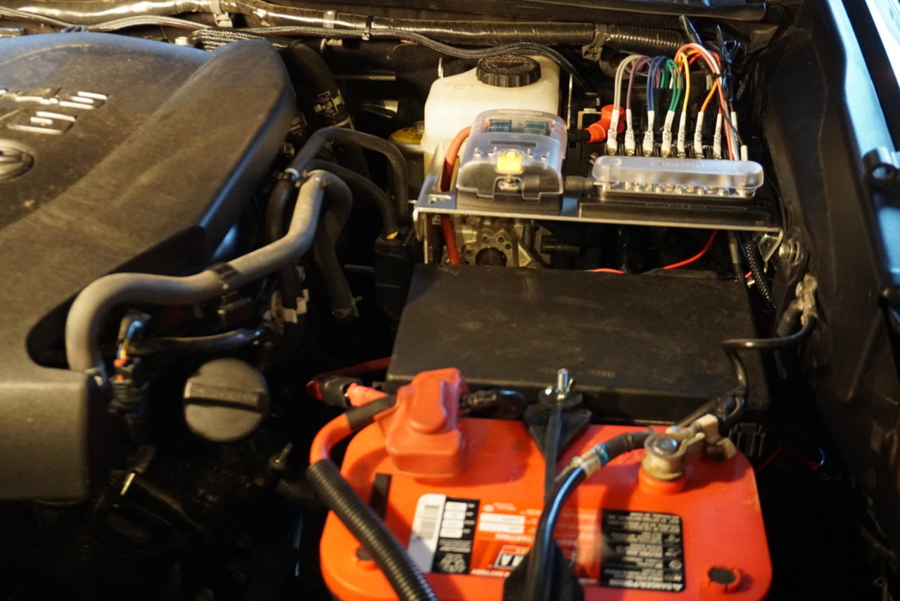

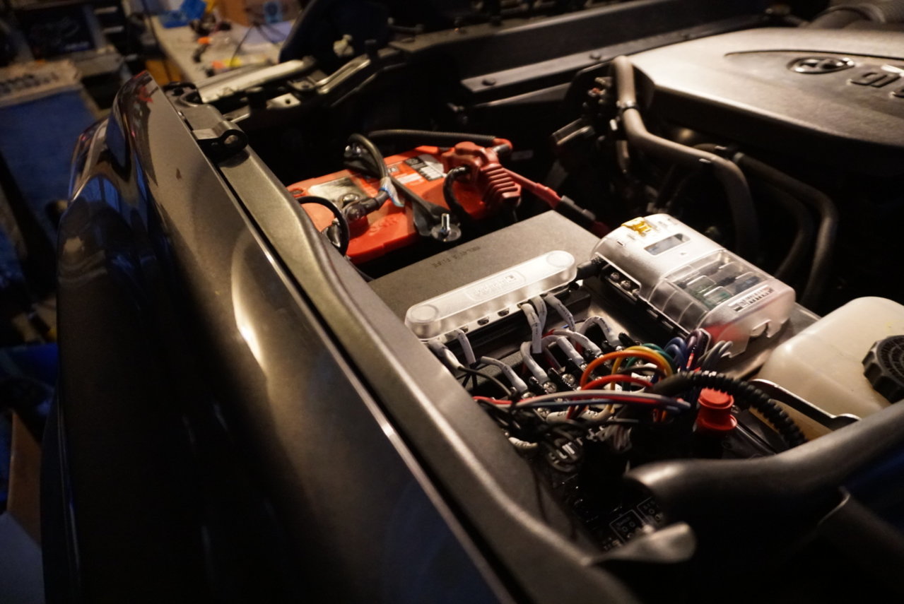

    Went with SDHQ fender mount. Blue Seas ground block and independent fuse block. Got it up and running was a win for me. Now to cut the 5-8 wires to length. Chose to marry up the switch wires to load wires and anchor. I can to be redundant and use the fuse. I’ll separate and use the 6 circuits. Plus it may be prettier. Only using switches 1-3 right now.
