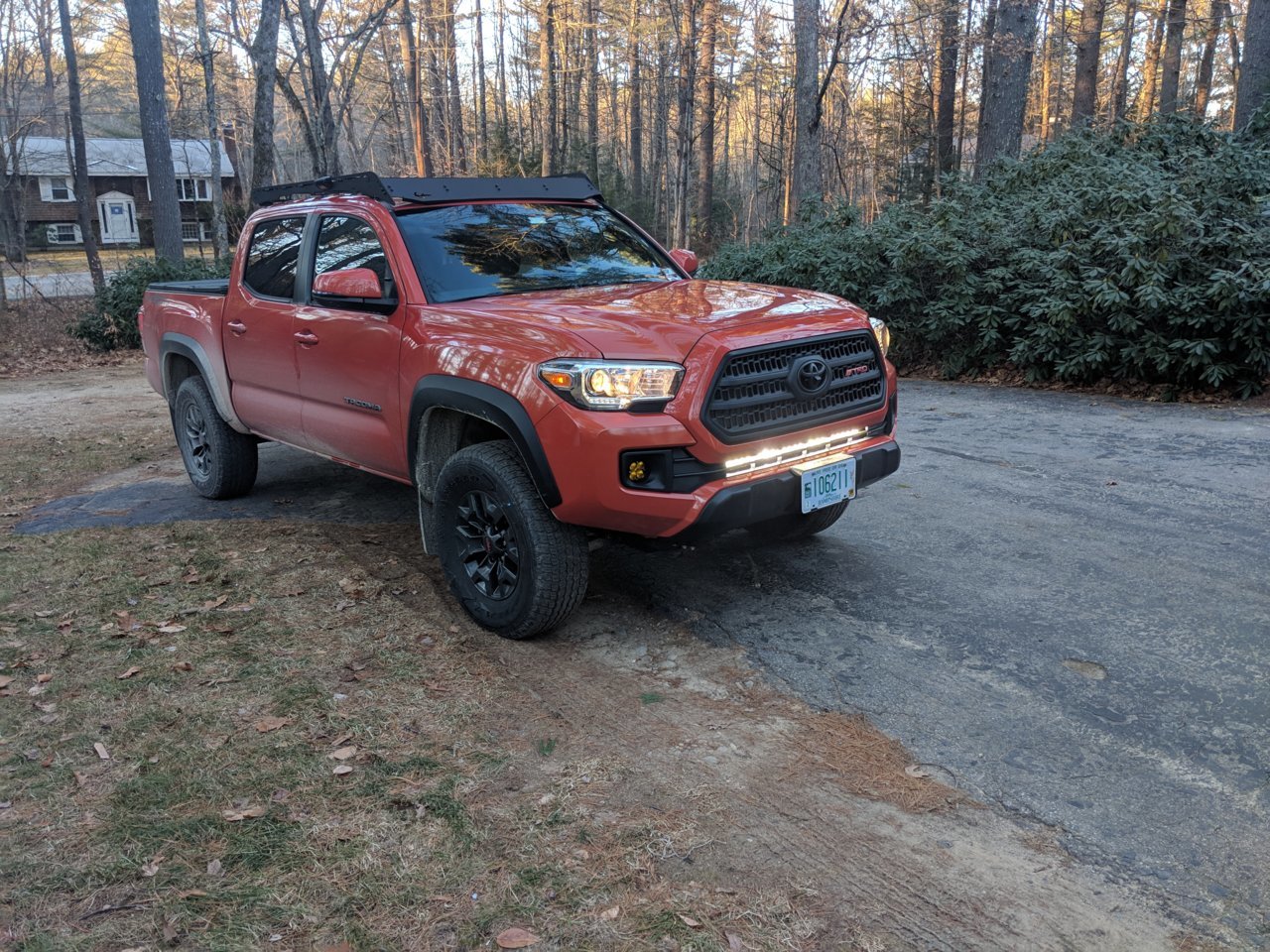

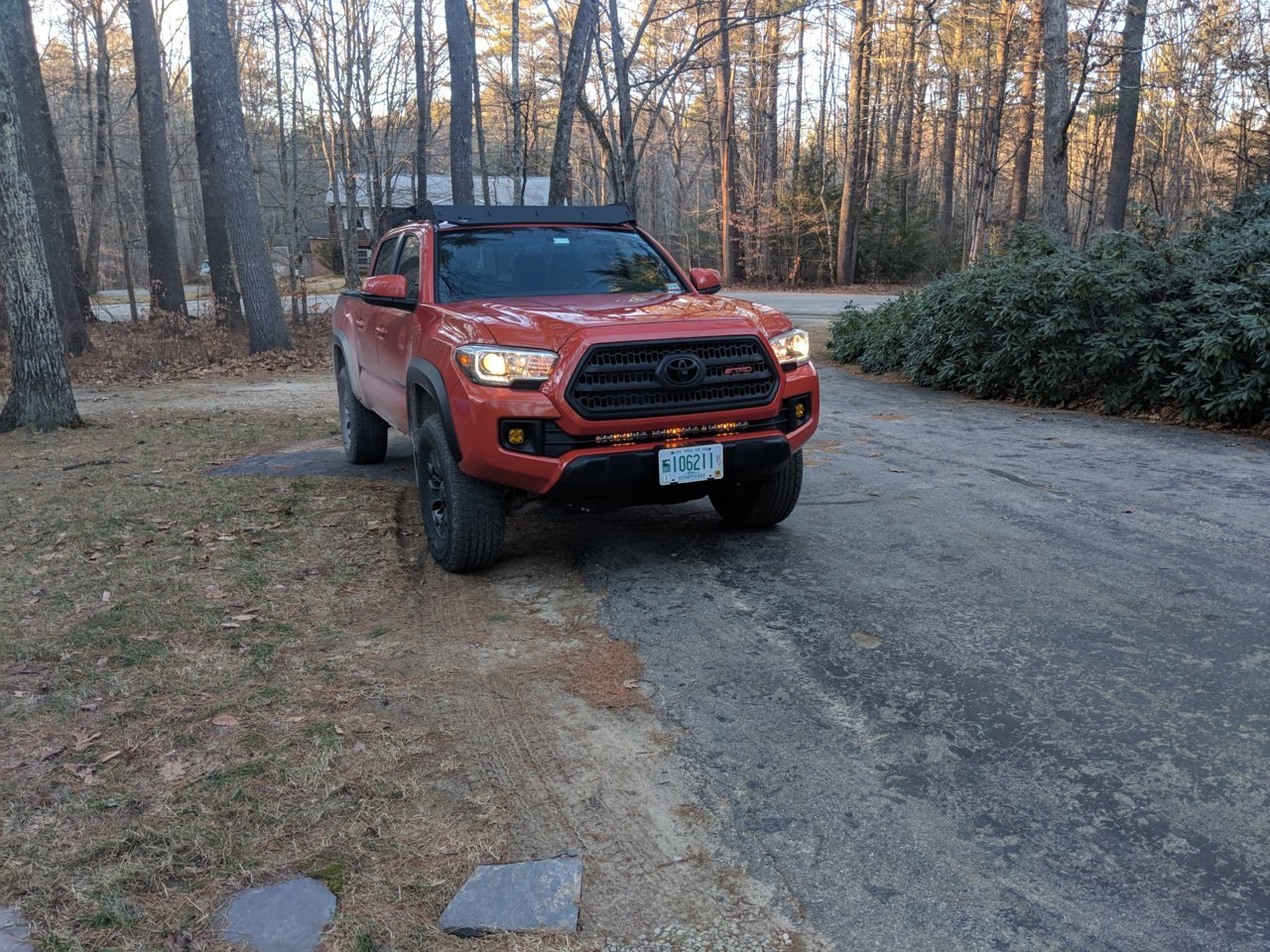

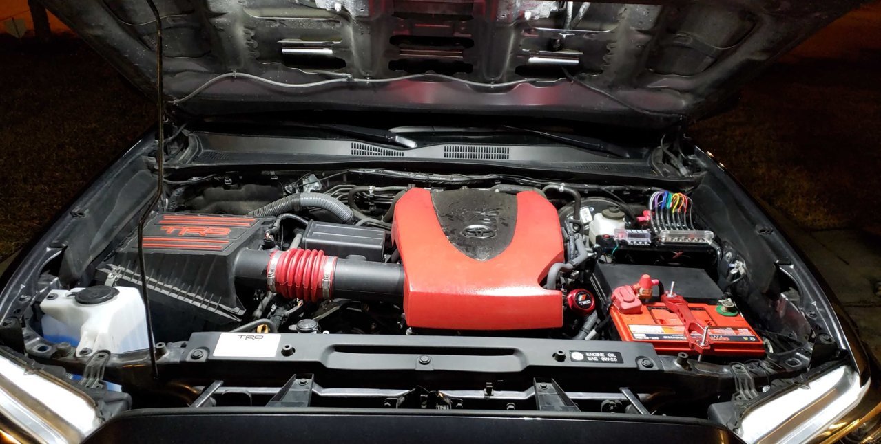

    IMG_20181223_152236.jpg IMG_20181223_152258.jpg Installed a Baja Designs 30" S8 today. It has a amber back light that I also put on a switch pro switch (for now). With the memory function set to in and set to ignition, it comes on like the drls.
    I still haven't hooked up the pink trigger wire to anything but am thinking of triggering the light bar with high beams. I assume there's a high beam fuse in the engine bay fuse box, as I think I used a tap a fuse on the low jeans for dimming the switch pro brightness.

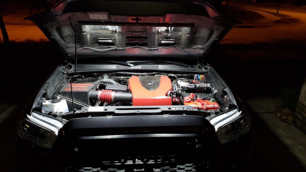

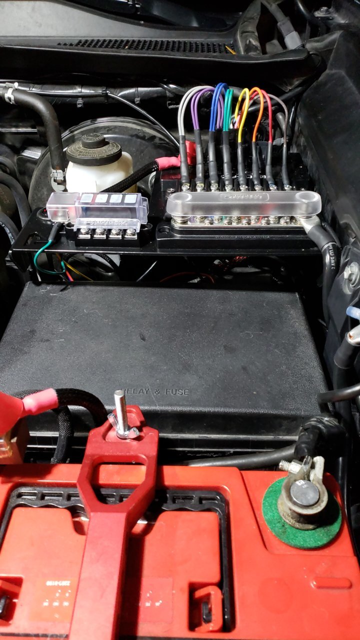

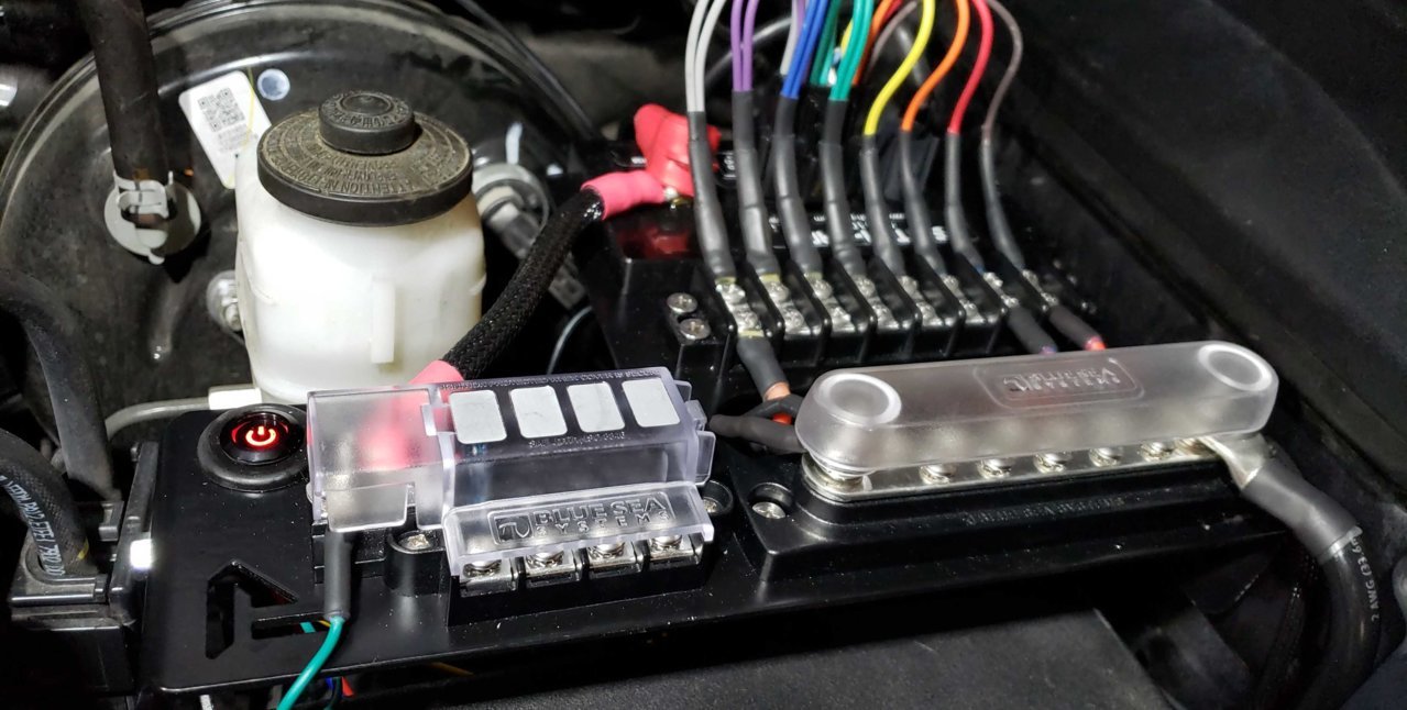

    Finally got mine all wired up! I also installed a set of KC Cyclone LED lights as engine bay lights. I mounted a flush mount push toggle switch to my PowerTray by drilling out a 3/4" hole and putting a rubber grommet in. I am sure you can see it in the picture below. I powered that using the fuse block.

    Looks good
    Parker315[QUOTED] likes this.

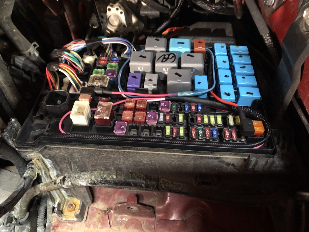

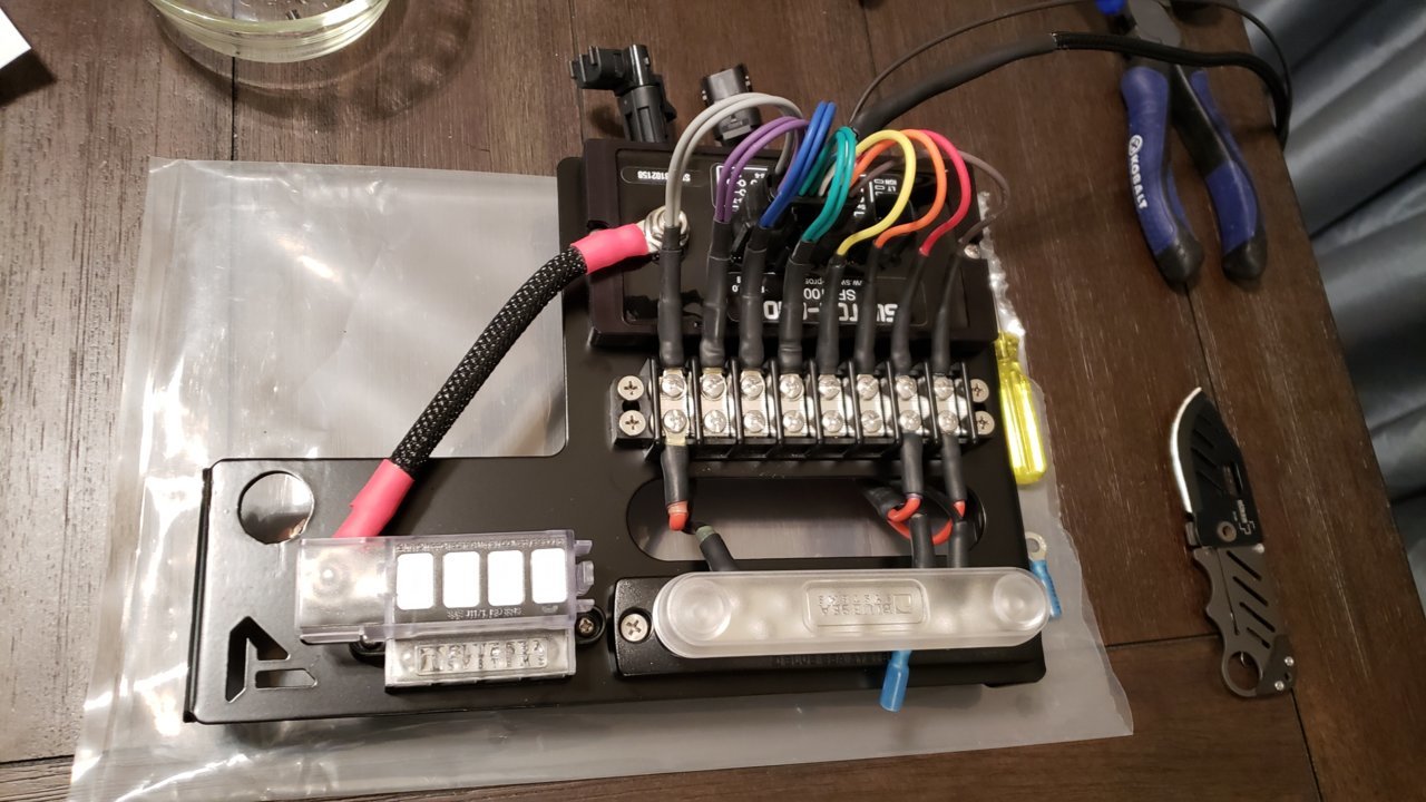

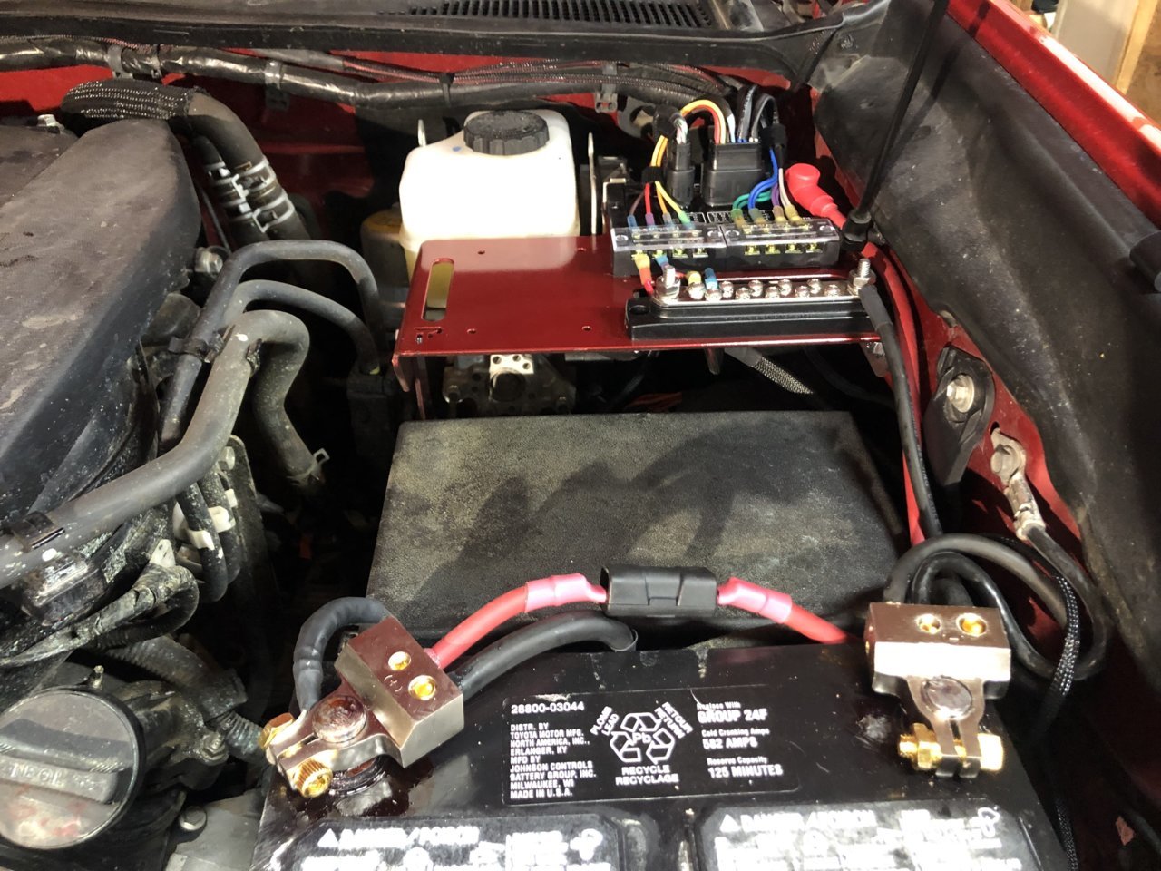

    Did mine last weekend, best pic I’ve got at the moment as I’m not completely done.

    Wow, excellent job man. The panel paint job looks really good as well! I REALLY like your Terminal blocks. What brand and where did you get those. I like that they have a cover.
    What did you end up tapping into inside the fuse block for the white, blue, and pink wires? I did the Blue to AC/Ignition, White to High Beams, and Pink trigger to reverse.

    I found the terminal blocks online via Amazon, used them and just used small self tappers to hold them in place. I did the blue and white white for now, pink one is just coiled up in there as I was I undecided for trigger use at the moment.
