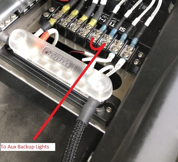

    I've read through a couple threads on this now (and others looking for light switching options) I believe the SP is the answer.
    My primary desire (as far as function) is as follows:
    1. Light bar on with hi-beams, off with low beams. (Seems easy enough using the trigger wire.) I've got no use for the light bar if the hi-beams are off, so this one is easy.
    2. Backup Lights.
    a. off all times
    b. on with reverse
    c. on anytime
    So, using the two trigger legs (one for hi-beam, one for reverse) I can accomplish this. I understand I lose "lights on panel dimming" by using both trigger points for this.
    I want to be able to enable the hi-beam trigger and backup trigger when off road, so these lights only come on with hi-beam (in the case of forward facing lights) or reverse (in the case of backup lights).
    BUT, I also want to be able to easily hit a button to bring on backups at any time for boat launching & retrieval / camp duties / nighttime firewood cutting without having to toggle out of the "off road hi-beam / reverse" function in order to enable the straight on/off mode for the backup light switch.
    In this instance I'm fine with taking up two switches to accomplish this since the backup lights will pull double duty as area / work lights. Being able to have them come on automatically in reverse, while also being able to easily "one push" turn them on and override would be very convenient out in the sticks.
    Any problem with wiring the load side of the terminal block as follows? (Forgive me for borrowing a pic here).
    So in this instance, switch 3 would be controlled by the trigger mode (reverse), and switch 4 would operate the backups (anytime on) independently of switch 3.
    Sorry, long winded way of saying I don't want to screw with toggling the trigger mode on and off just to get the backup / area lights to work anytime I want, while still in the "reverse trigger" mode and having that convenience of the backups coming on automatically when I throw it in reverse.
    I'm taking up 2 switches to run one set of lights, but I'm good with that in this instance if it's not going to create any issues.
    Hope I'm making a lick of sense....it's almost 2:30 and I've been up far too long tonight.

    I don't know for sure, but I THINK the switches can be programmed for trigger AND push button. That way you'll save a switch

    I don't have one to mess with yet, but from what I was reading, it appears (could be quite wrong) that the "trigger mode" enables the switch operation. Push the switch, lights come on anytime hi-beams activated. Push again, and lights stay off with or without hi-beam activation.
    If there was a "hold button to override" feature on the button, that would work, but I don't think it has that (other than just toggling off the trigger via holding center button and #7 switch. Kind of a pain just to get a light on...especially with gloves on.

    On the bolded... I don't think that's how the triggers work. If you hook a trigger light to the high beam circuit, and program it to turn on a bar when the high beams turn on... it'll always do that logic. You can also turn on and off the led bar independently of the high beams (also... if you turn on your high beams, your LED bar will turn on, and you can then turn it off wihtout turning off the high beams).
    But the trigger overrides the switch panel's state for the linked switch.
    I think. unless there's some advanced programming of the 9100 I don't know about.

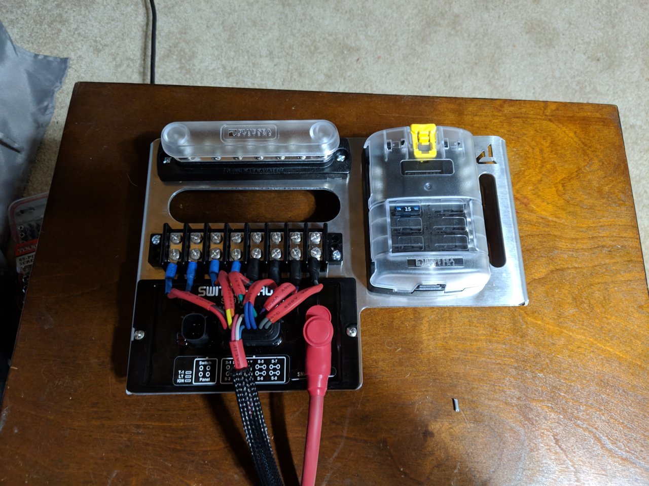

    Well, picked one up and am gathering parts to do a nice install. Going to set this thing up on the bench and start landing wires possible this weekend.
    Playing around with it tonight. Got some test lights and a bunch of jumpers to test out all the functions. It will do just what I want.
    So, say the light bar and other lights are set to be triggered by hi beams:
    Ignition on, switch off, low beams on, light bar off.
    Ignition on, switch off, hi beams on, light bar automatically comes on.
    And of course the SP switch will manually turn them on or off. But I don't want to have to toggle the off road lights off every time I hit the hi beams on the highway, and don't want the super bright backups coming on every time I throw it in reverse in town.
    I want the convenience of "all off" (light bar and squadrons) as soon as I back off the hi-beams off road, and "all on" automatically when the hi beams are switched back on. (Same for backup lights with reverse trigger).
    So I thought I might use another switch with "memory" engaged to control a DPDT relay to enable and disable the trigger switches. Played around with that tonight, and it would work beautifully. But what do you know, as I read and played with it, I learned the SP has the capability already. Hitting "menu" and #7 disables hi-beam trigger. Hitting "menu" and #8 disables reverse trigger. And this feature "latches" or holds memory regardless of ignition on / off status. Hold menu button and tap both #7 and #8, and both disabled / enabled until you manually change them again.
    Slick.

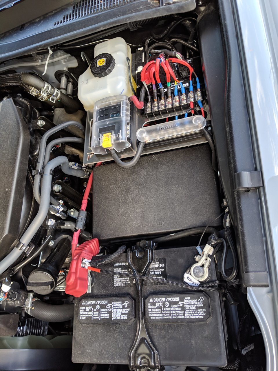

    Just got my switch pro installed. Problem I have now is when I use the remote start the lights I have connected (ditch lights, and bed lights) turn on as well. How do I make it not do that?

    Got it figured out, it was a setting on the switch pro itself.

    Your truck wakes itself up every once in a while to run essentially a diagnostic. When it does this, it activates the EFI circuit momentarily. That's why it comes on.
