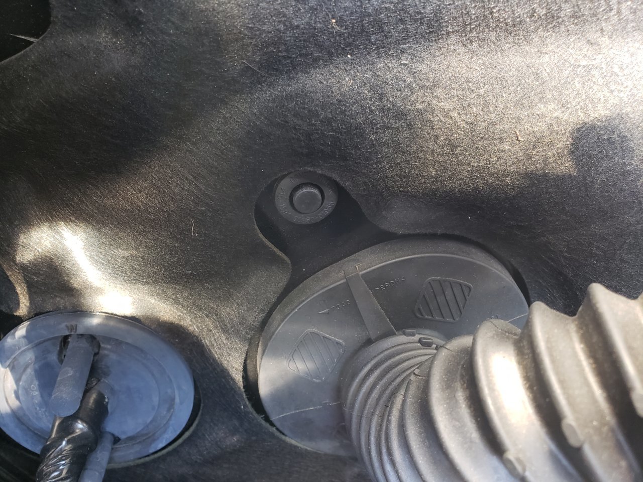

    Best place to put wires through firewall in 3rd Gen?
    Decided to go the switch-pro route

    There is a small rubber plug right behind the brake fluid tank, use a needle nose pliers to pull it out and punch through the firewall material. It will look like this:

    Here's some pics of the plug from my 2019 along with where it will come in.

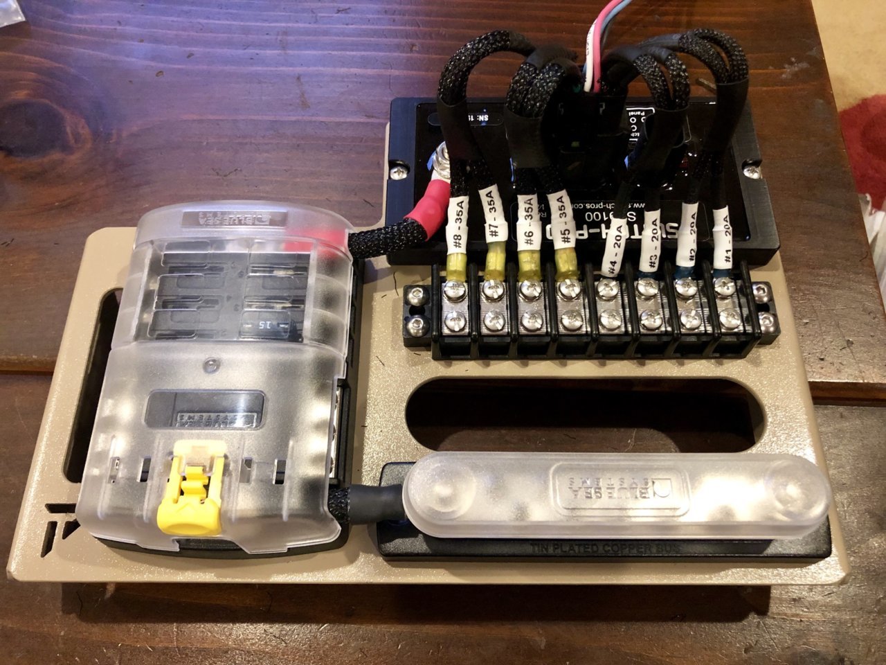

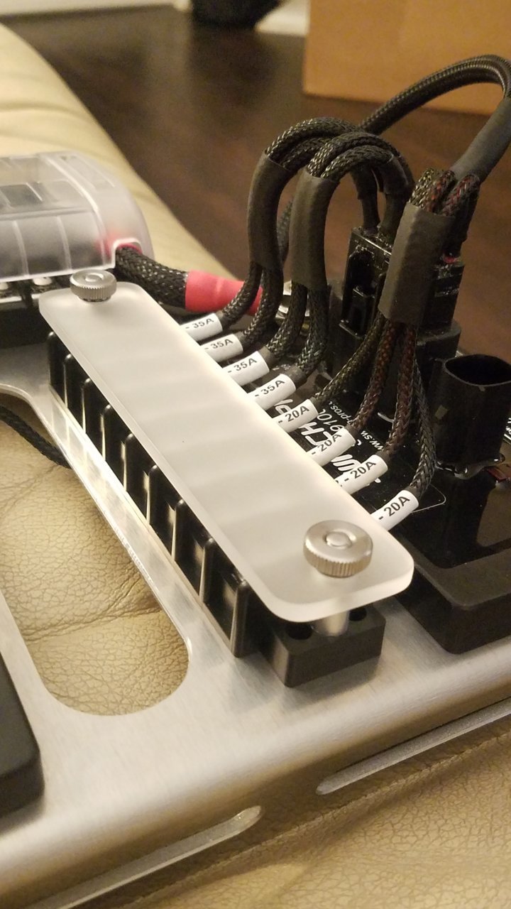

    Interested in those wire labels. Did you custom print those?
  6. Mar 25, 2019 at 8:14 AM
    #406
    sagexp
    sagexp Well-Known Member
    Feb 6, 2017
    #209799
    512
    Back home, AZ
    2002 Tacoma DC 4X4 2017 Tacoma DC 4X4
    Yes, following the lead of @taco_pnw back in the first pages of this thread. Dyno label maker and 1/2" heat shrink tube.
    I've got one of the high end Dyno lable makers in storage in a different town and didn't feel like driving and digging for it, so just purchased a cheapie for $20 off of Amazon for this project, and it worked just fine.
    I'd recommend it. When all is said and done there will be a lot of wires running around that area (and a few tapped into the fuse block), and the labels will make things much easier in the future should the time come to move things around or troubleshoot. Plus it just flat out makes for a nice and clean looking install.

    that plug is right behind the clutch bracket on manual cars, its a bitch to get thru. I did it anyways because I felt like its still better than tearing a hole in the larger rubber grommet for the main harness lower down.

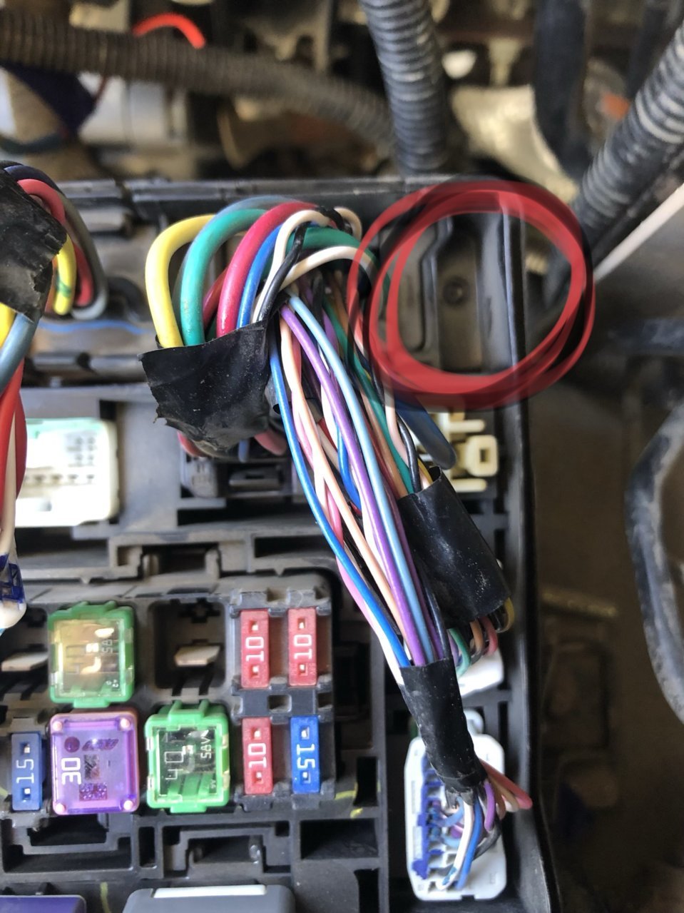

    So what’s the best wat for putting the three (blue, white, pink) wires through the fuse box?
  16. Apr 9, 2019 at 12:28 PM
    #416
    HiProofProducts
    HiProofProducts Well-Known Member
    Mar 28, 2019
    #288305
    207
    NE Ohio
    2017 Tacoma TRD Sport
    Looking at the fuse box from the drivers side I carefully drilled a 1/4” hole in the right rear corner from top to bottom. Once the wires were in place a dab of silicone sealant made everything watertight once again. Watch other wires as you drill, caution is advised.

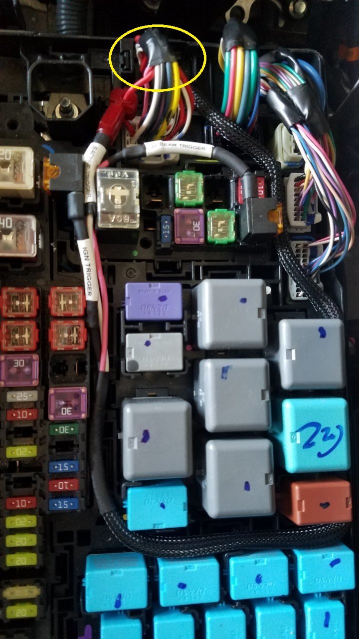

    I went through the factory fitting here:
    It required undoing a clip, pulling that bushing out, cutting through the tape at the tail of the bushing so I could open it, then inserting the wiring for the SP, snapping it back closed, and using a rubber tape wrap to re-wrap the bushing around the wire bundle.
    Not as bad as it sounds, it will make sense once you look at it. Worth the minor hassle to keep things nice, splash proof, and factory like.
    Edited to add: I went through the additional trouble of doing it this way since I'll be under warranty for a while yet. With the various electrical gremlins that pop up on these vehicles sometimes, I did not want anything which wasn't completely reversible or which could in any way be suspected as a contributing cause to a ECU or other electrical type issue.

    Not sure on which clip you’re talking about.
  19. Apr 9, 2019 at 12:59 PM
    #419
    sagexp
    Feb 6, 2017
    #209799
    512
    Back home, AZ
    You can see it at the left area of the yellow circle. It was either a clip, or a small rail for the bushing to slide down onto. I don't recall exactly, but it wasn't too hard to get out. It pulls straight up.
    Once you get it up and can take a look at it, you'll see how it is a split bushing wrapped with tape. Carefully slice or pull the tape away, and the split bushing pops right open. Insert your wires, snap it back closed, re-wrap with rubber tape or electrical tape, and push the bushing back down into its socket / post.
    Probably goes without saying, but make sure you have the battery disconnected when poking around in there!

    Shout out to @sagexp and @HiProofProducts for helping out! @sagexp way is cleaner but I got frustrated on trying to do his way and drilled but now after a few PM’s I understand how to do it.
    Drilled through here and filled with silicone after wires & loom went through.
