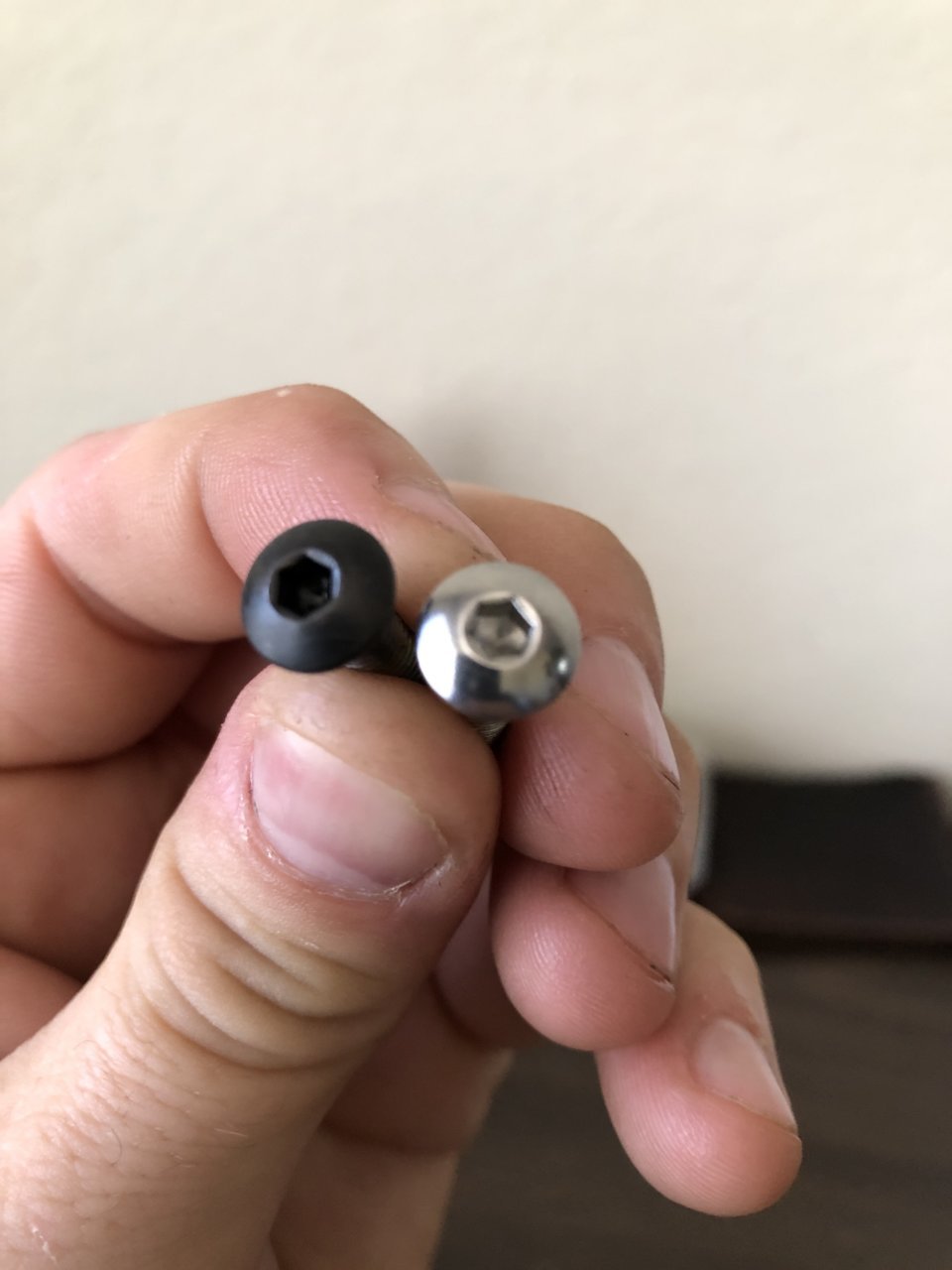

    Btw if you guys forgot to order black screws like I did, grab a torch and heat the screws up to cherry red and dunk them in olive oil. It will turn them black and give it a protective layer. A little trick I learned from a welder.

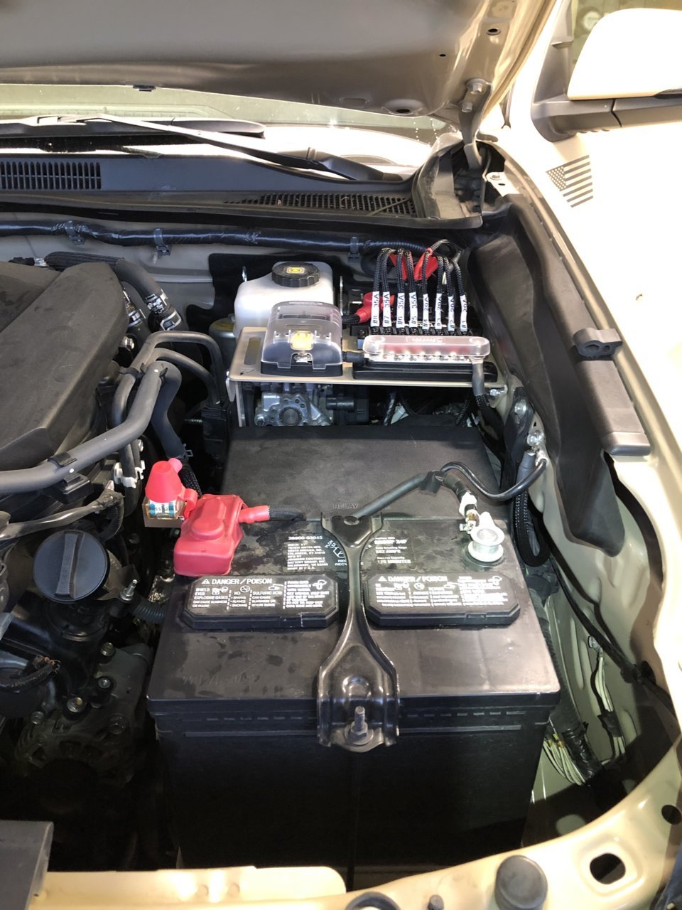

    Finally install it in my truck. I’ve had this switch pro sitting on my desk for 1 full year and now it’s finally in my truck

    Nice and clean! Love the powertray! Maverick does really well with them.
