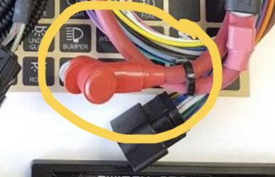

    Looks good, only thing I could add is to try and get the positive terminal cover on your power connector. This little guy upload_2019-7-14_9-37-53.jpg
    I used my heat gun to expand it just enough to get it off and on to my other cable.

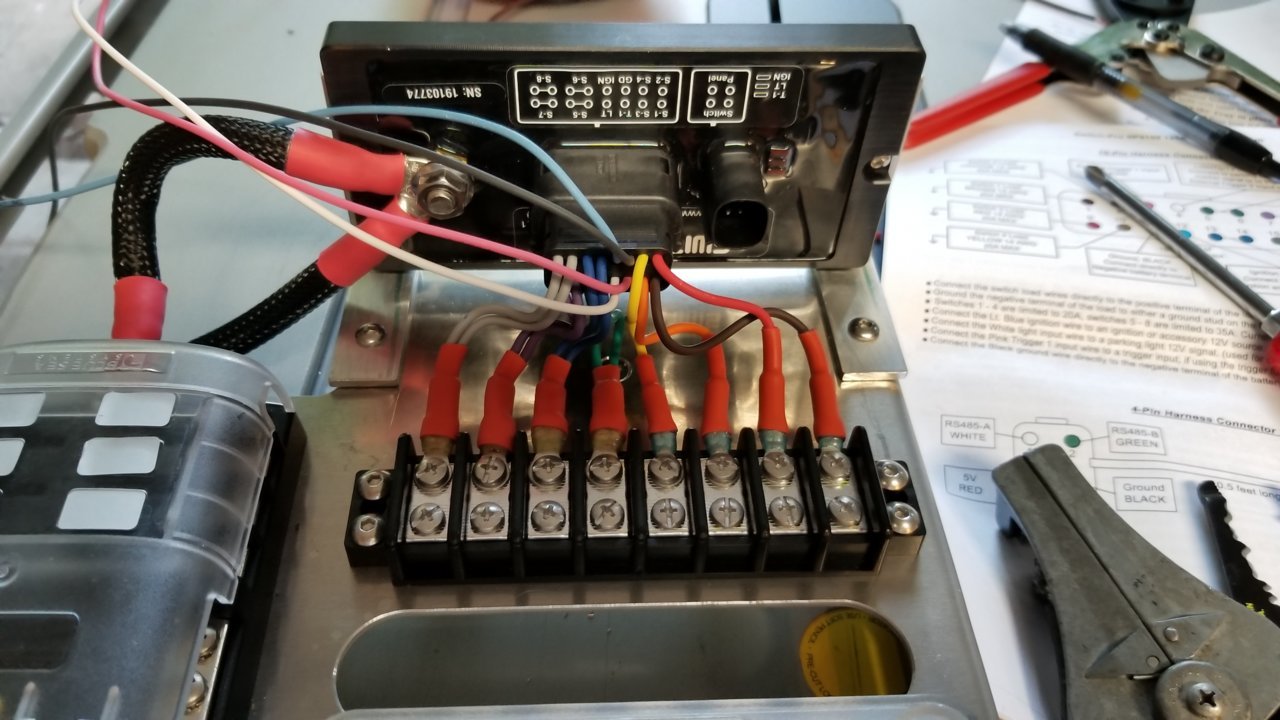

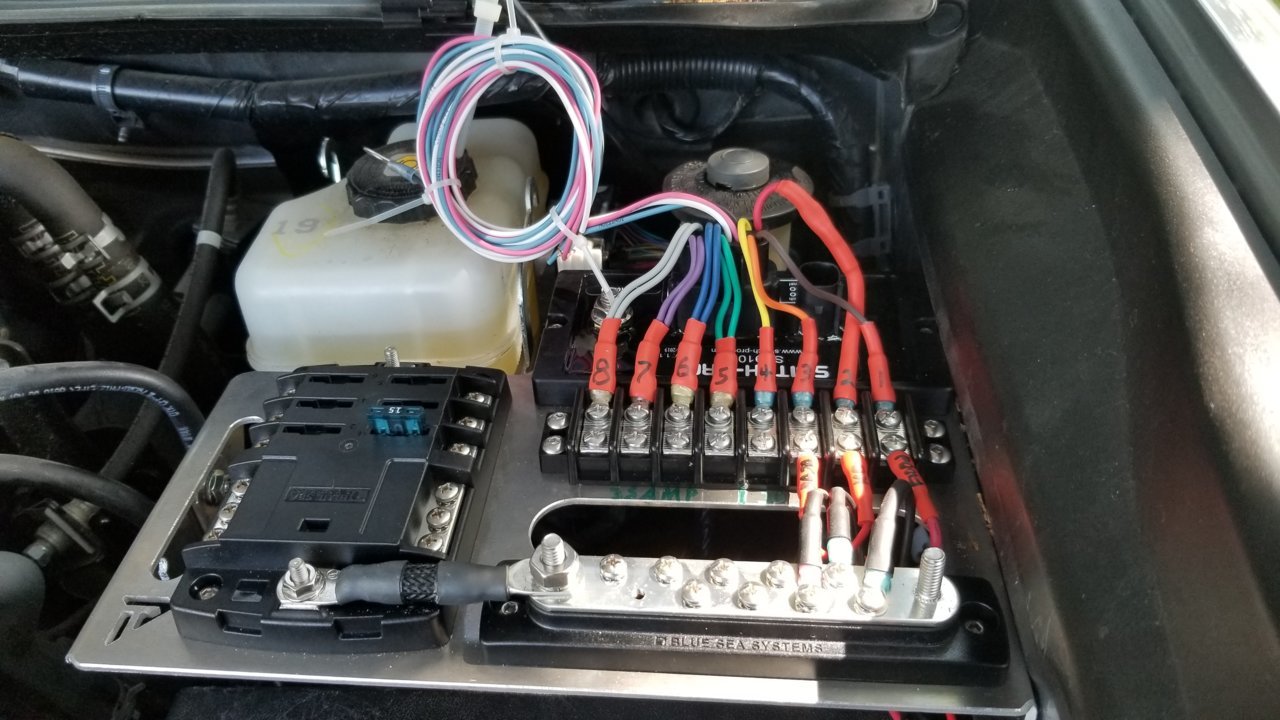

    I got my install about 3/4 done today. It's not powered up but I'm closer. One issue I had was my vertical brackets. My truck is a manual and I never removed the clutch fluid reservoir to test fit. Needless to say there was a ton of interference so I scrapped it and went flat. 20190714_131946.jpg after that it went pretty well. Since I had cut the wires for vertical mounting I did have to splice an inch or two onto the #2 wire as it had more tension on it than I was comfortable with. The others were still ok. Lots of cussing and more blind work than I wanted but I found all the fasteners I dropped and even my 10mm socket. Also I cut some of the tray off on the front left side to make clearance to put the fuse box lid back on. I highly recommend that! So much easier.20190714_160713.jpg

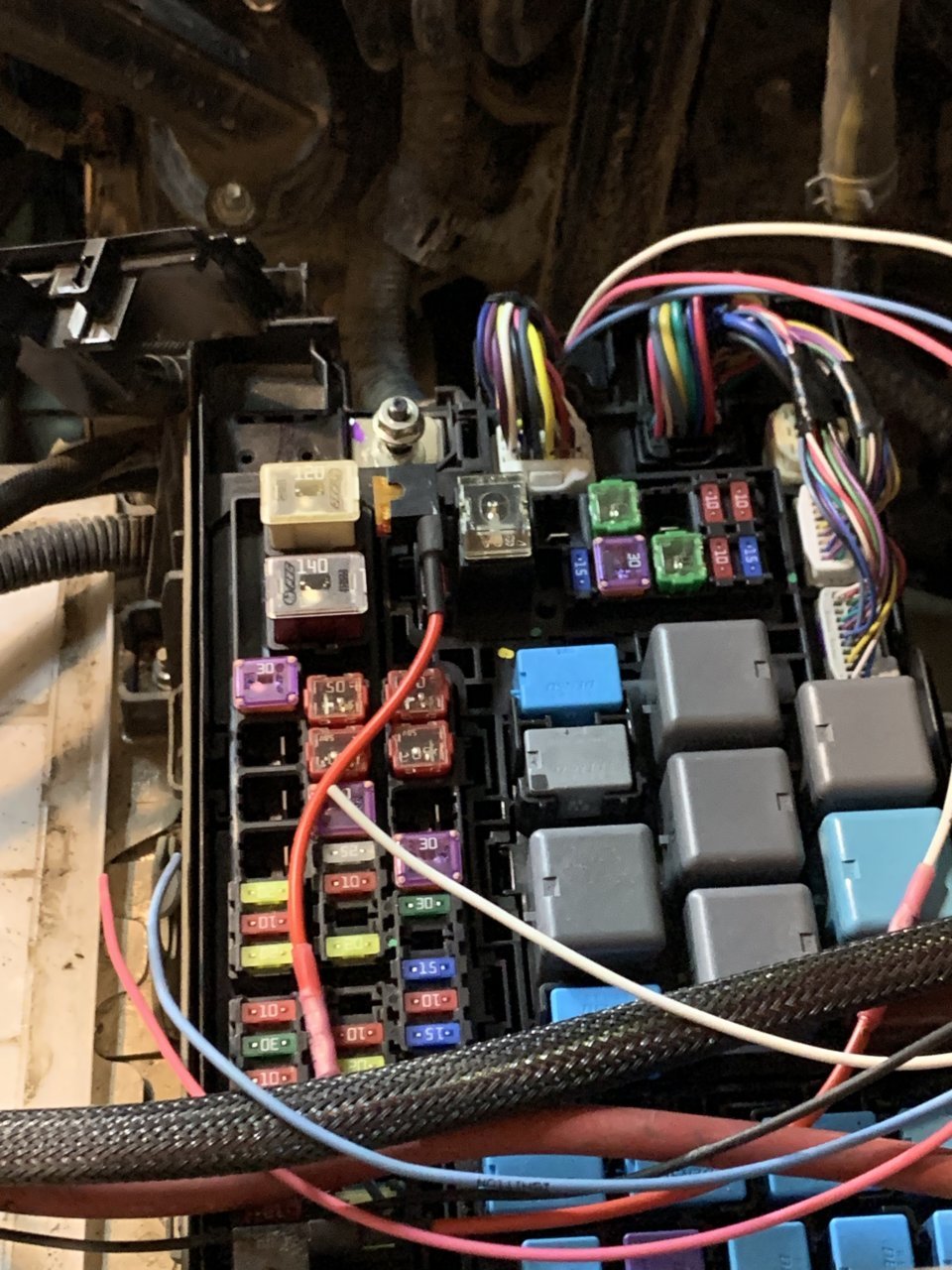

    @Shellshock is there a punchout or something to get the wires into the fuse box? I didn't see any access into mine. Curious how you got the 3 wires in there.

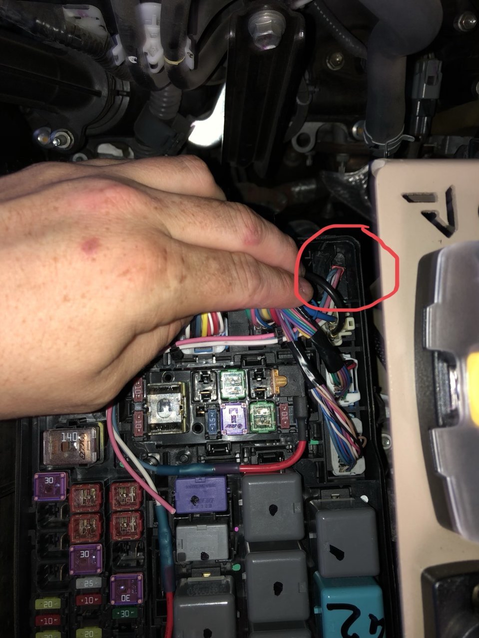

    I’ll take a picture of how I routed mine in the fuse box right now

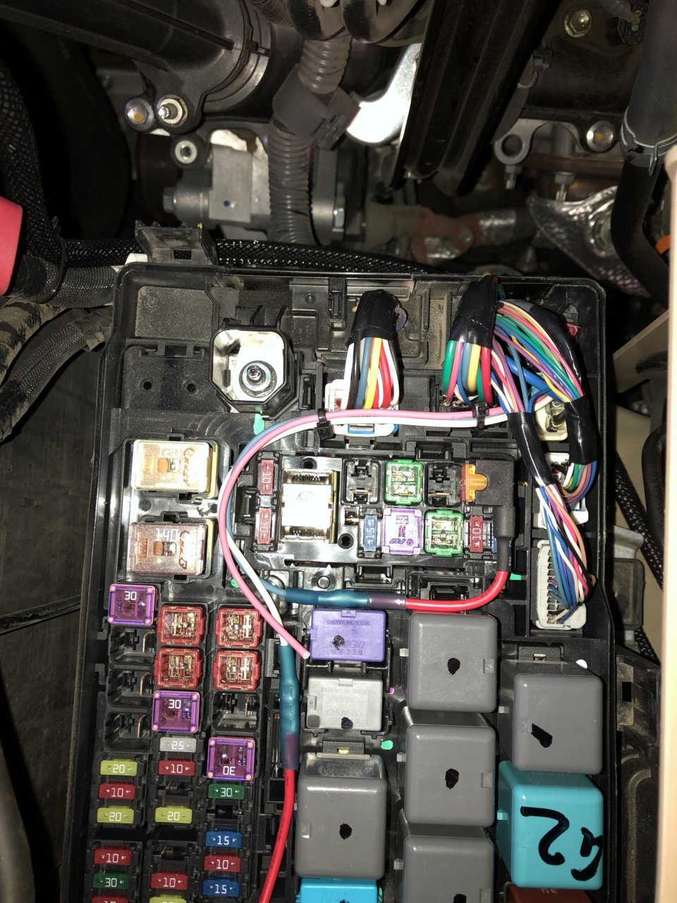

    Right in the corner where the red circle is. I didn’t a 1/4” hole with a dap of silicone

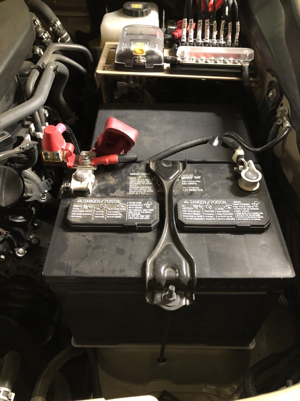

    Did you cut the ring terminal off on the positive side and reterminate? I bought the SDHQ terminals as well but looking at the stock length of the positive lead, I don't think I can cut the ring off and reterminate without running short........cheap Toyota bastards.

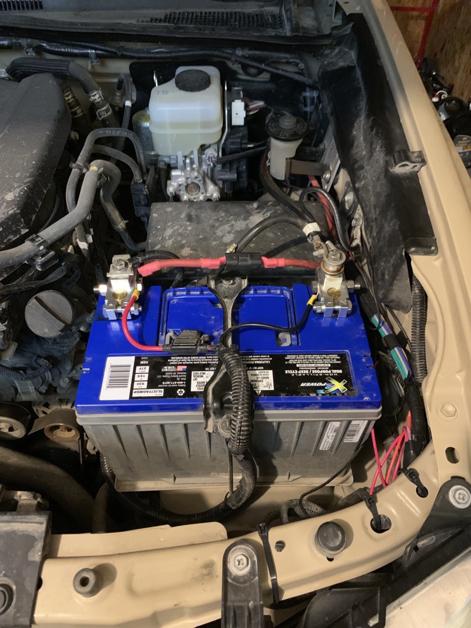

    How do you have the positive side hooked up to the terminal? I don't see a top post mount like you have on the negative side.

    You take the bolt out of the factory positive and the ring comes off. You can then attach the factory wires directly to the SDHQ terminal. The negative side they include a post or a new end that you can use for connection. I went with the post because it was easy and I didn’t have to cut the factory wiring.
    The switch pro Positive is connected to the connection point on the rear of the SDHQ terminal.

    I was able to connect to the original Toyota terminal without replacing the terminal connectors if that’s what you were talking about

    The positive should have a post you can attach to and the negative I attached to the ground that’s attached to the frame. It works with no problems. When I have more time and want to get into it I’ll probably replace the terminal connectors with the military type.
