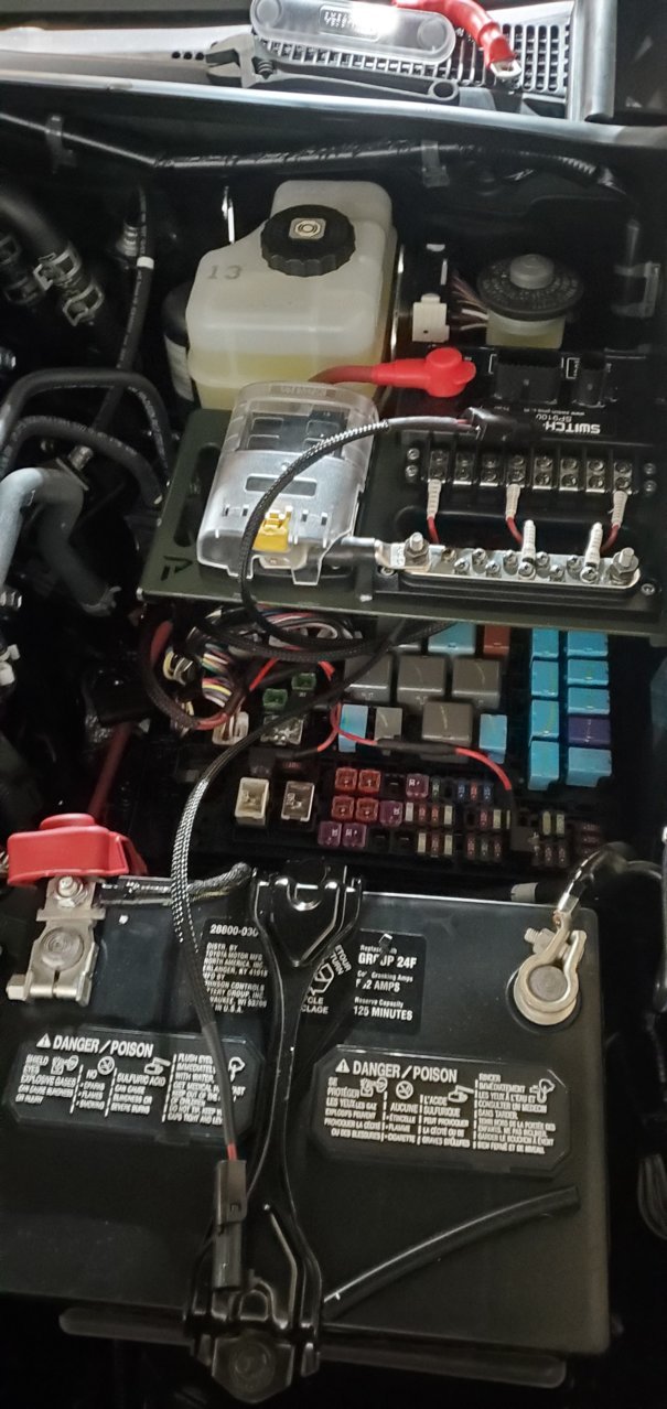

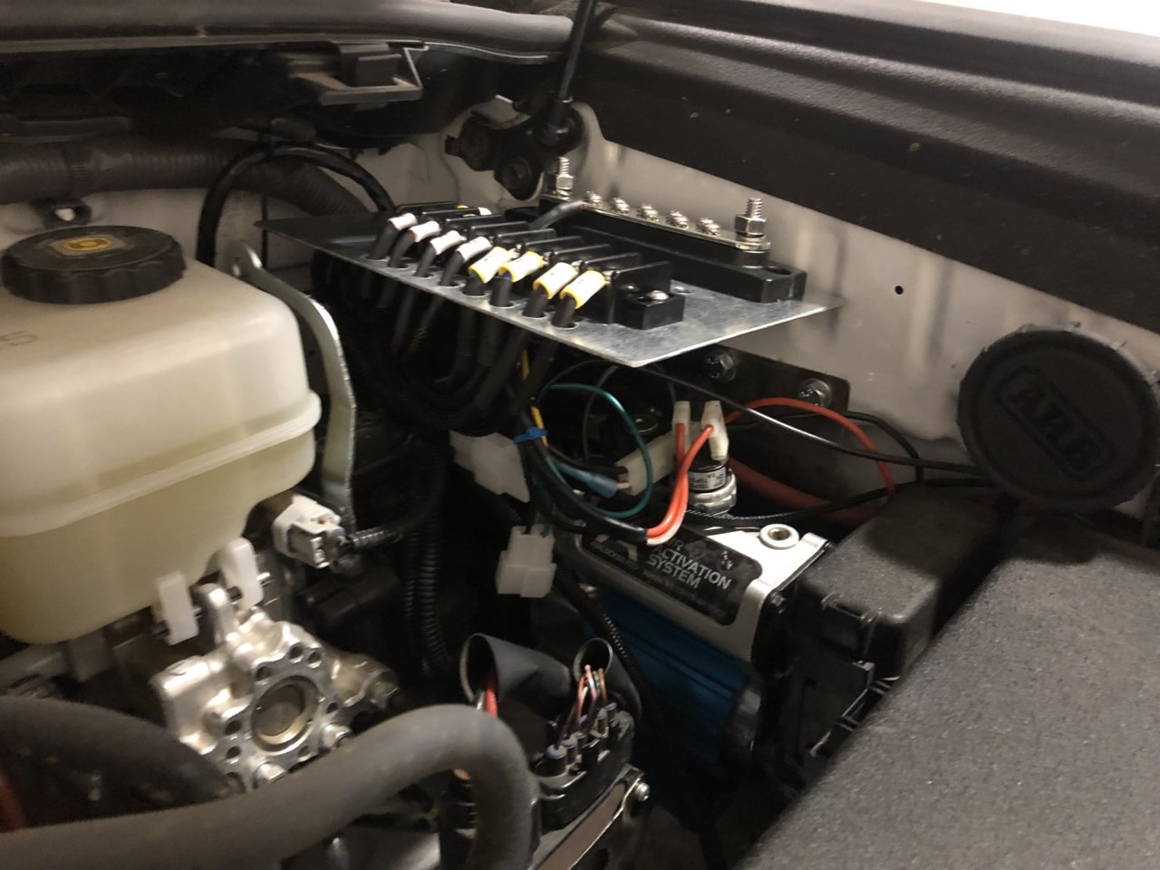

    Nothing compared to what some of you guys have built.. but just finished mine up a few days ago.. just thought I’d share. A7A7A5D3-C866-41C0-8BA7-2C15A0BB627C.jpgC61E9B42-A0E1-4E39-ABA5-8FAC5E9AB6E9.jpg

    I was gonna do something similar but the stupid clutch reservoir is in the way so I just used the SDHQ mount and hard wired everything

    Yea I originally was going to hard wire it all but just wanted to clean it up a bit more to make easier for adding more... I know Switchpro does not recommend bussbars...
    Here’s also a 4Runner mount I did.. compressor mounted under the mount

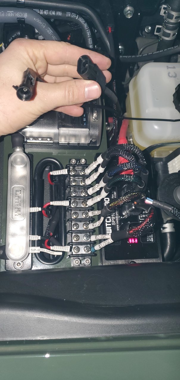

    Stupid question: how are you doing the wire labels?

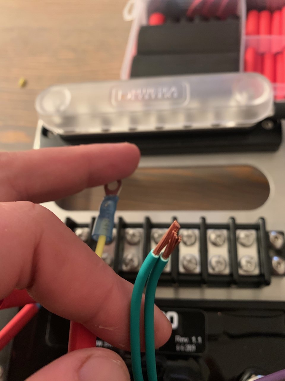

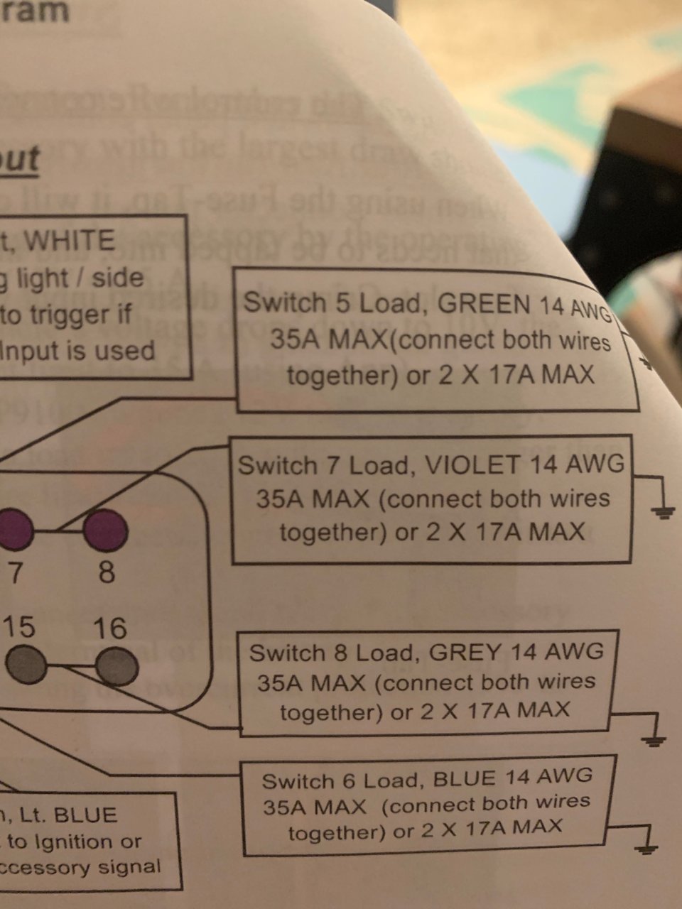

    When it says connect the two wires together does it mean intertwine the copper or just stick them side by side into the connector and crimp?

    I have them stacked on a busbar.

    as far as sticking them into the fish eye connector, are the two wires copper intertwined or just side by side? Does that make any sense?

    either one just as long as they both end up in there solid. I gave mine a slight twist to fit them in the connector

    cool, figured, just wanted to make sure! Thanks for the quick response

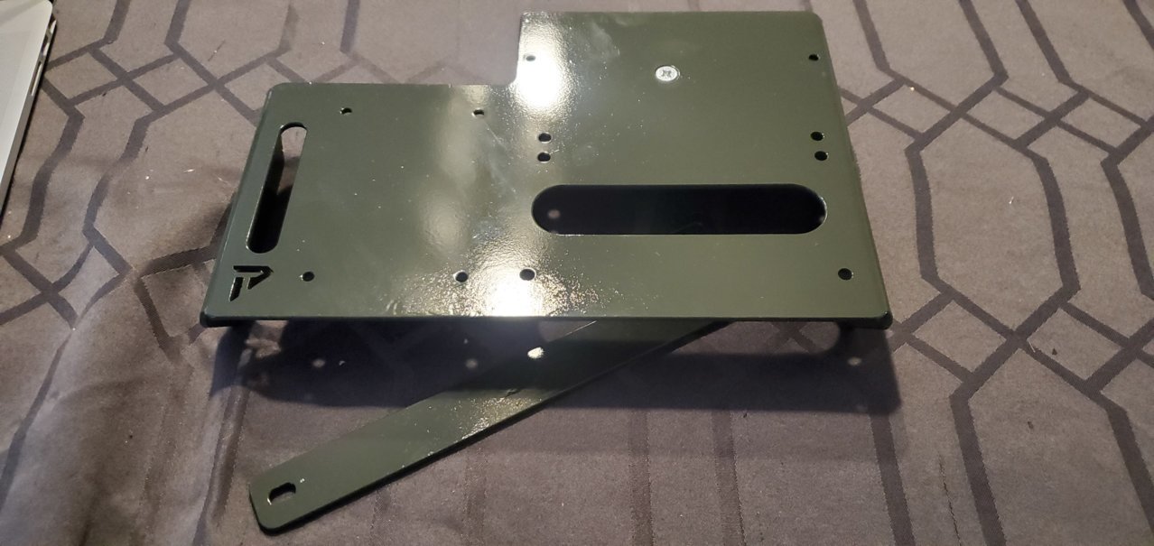

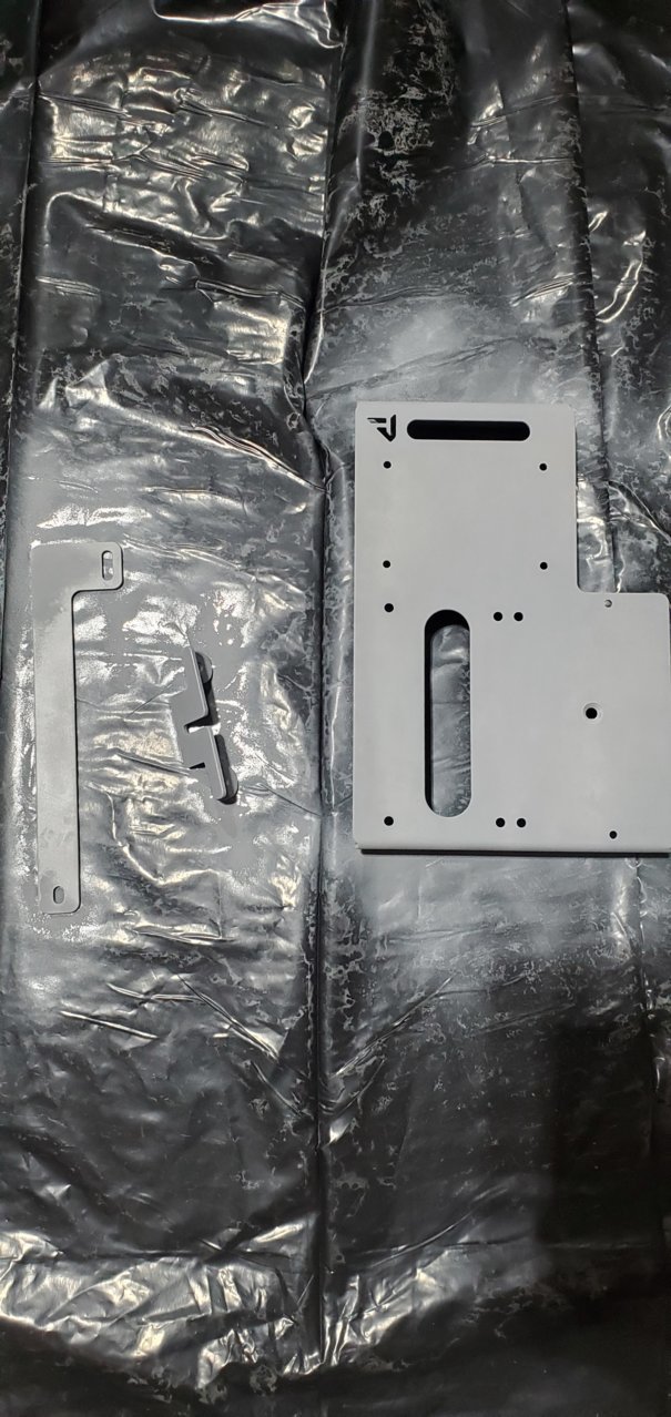

    Got my PowerTray painted up and starting wiring pigtails to plug and play when accessories when they get here!

    I heard that SDHQ wont warranty a module that is mounted other than vertical.

    I bought manufacturer direct. I also have a plan in work for the vertical mounting. More to follow.

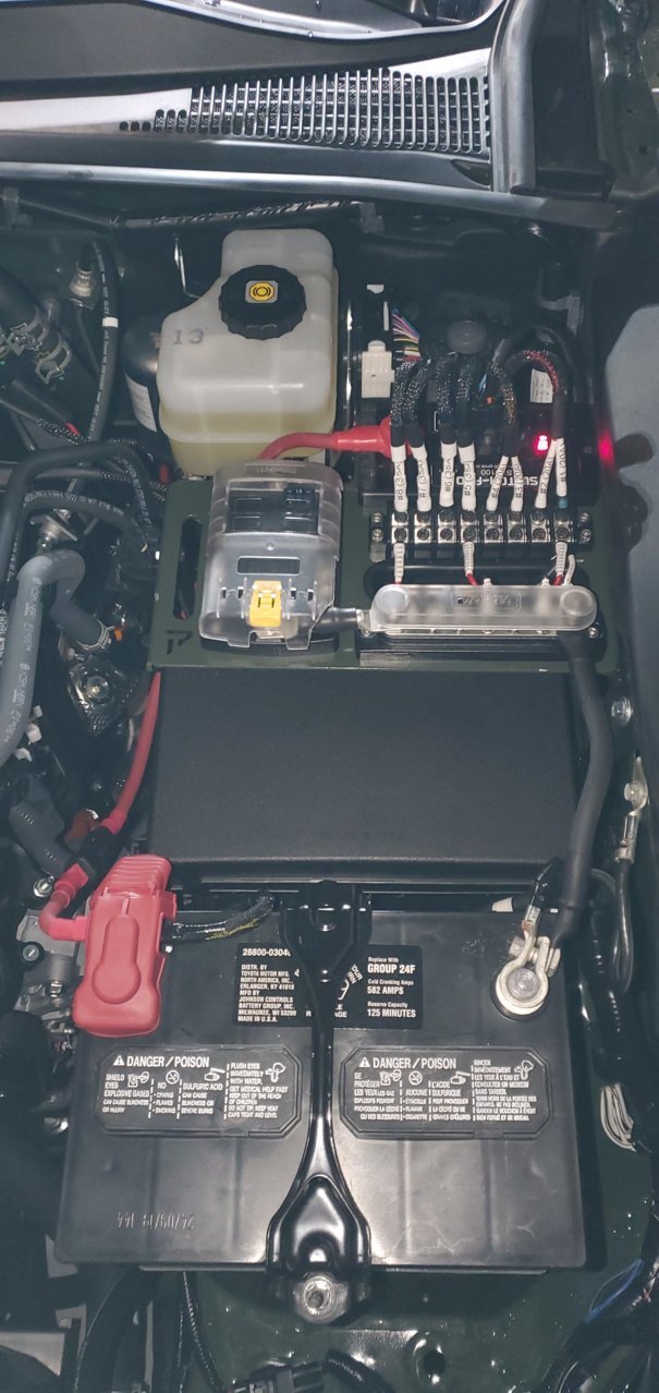

    Got everything in the engine bay wired up. Still trying to come up with a novel solution for the Switch Pros, but in the meantime, added some liquid tape to the harness to prevent water intrusion.
