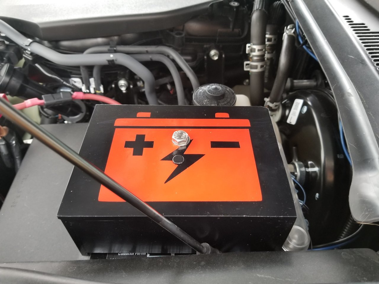

    I built a cover out of acrylic to go over the main module. It was pretty easy to do.

    4,125
    Aaron
    Murrieta ,CA
    2019 DCLB Cement OR 4x4
    Details please...

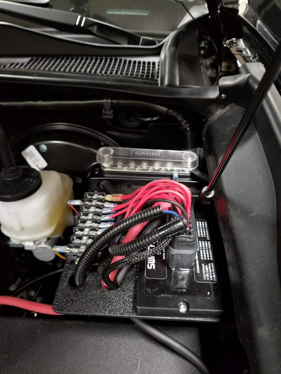

    I have my module on a mounting plate. I bought some clear acrylic and acrylic glue. Made some measurements and cut the pieces for the box. The glue works fast and strong. Then I took some joiner nuts and put them together with a threaded stud. Bolted that to the mounting plate from underneath, drilled a matching hole in the bottom of the box. Ran a bolt through the box and into the topmost joiner nut. It's pretty rudimentary, but it works. I'll have to look for some photos.

    Shazaam! If you try this, put the box together one side at a time. Ask me how I know this.

    Do you have a picture?

    Look up, sir!

    Page hadn't refreshed when I sent that! Haha Looks good. You don't get any temperature issues with the unit by covering it up?

    I figured. No worries! I've never had a single heat issue with it like that. It doesn't completely cover everything; there's enough room for wiring to go to the bus bars at the bottom. It's been through a few water crossings without issue. I have the mounting plate slanted a little so any standing water will run off.
    It's not that nice, but it works as far as I can tell. I wish my wiring was as pretty as everyone elses'. I need to get in there and do some cleaning up of that mess.
    I just realized this is the 8100 and wanted to say one last thing: I had the cover off one day and it rained. The 8100 had a complete meltdown. I have no idea if it was caused by the rain or something else. Switch Pro replaced it with the 9100, but never told me if they could figure out what was wrong. The 8100 got hot enough to melt the epoxy between the plug in and aluminum base. Also drained my battery. Coincidentally enough, Switch Pro started saying it could only be mounted vertically with the introduction of the 9100. I'm not casting blame or pointing fingers, just stating the facts.
