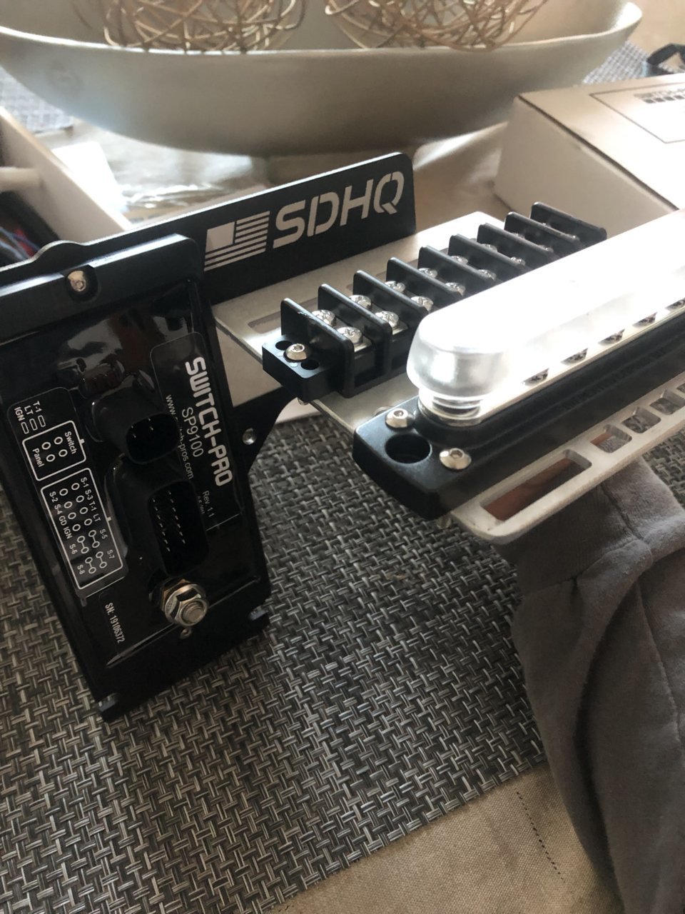

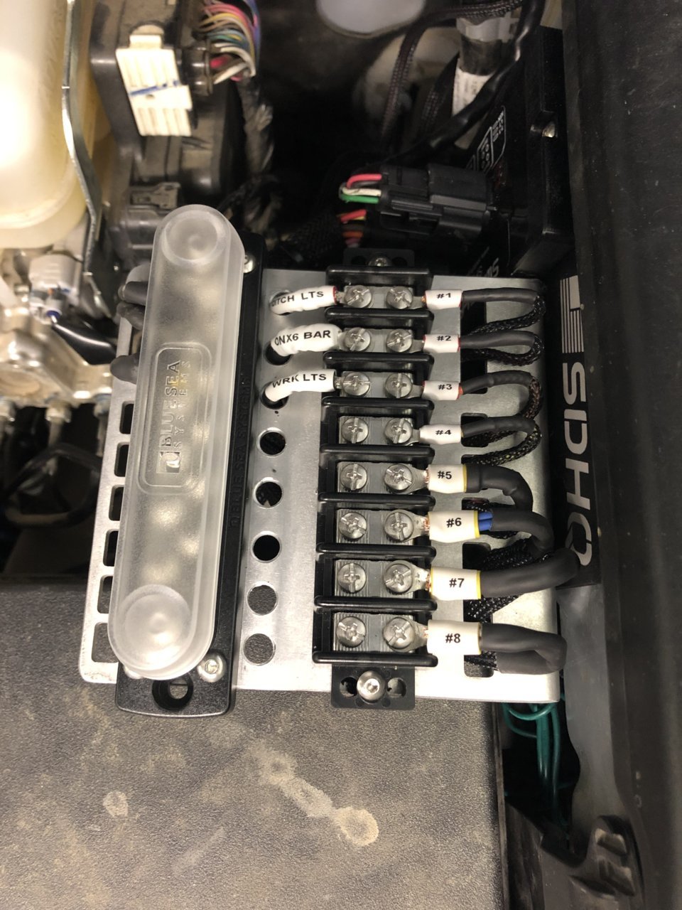

    You should make more of these. I’d buy one, love how clean it is, and since switchpro says don’t have the unit face up like a lot of others this is a great design. But real I’d like to buy one if you ever made more.

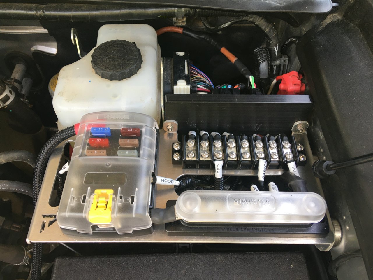

    What is the fuse block for? If you have the switch pro what do you hook up to that?

    The new vertical PowerTray fits nicely. See here for more installation photos.

    Probably a dumb question. What is that other fuse block used for?

    Accessories that do not require or would be inconvenient for SwitchPro switching. Hood lights, seat heaters, aftermarket horns, HIDS, cargo lights, etc.
    The PowerTray includes space for the fuse block and it is wired completely independent of the SP. It really tidies up your engine bay accessory wiring.

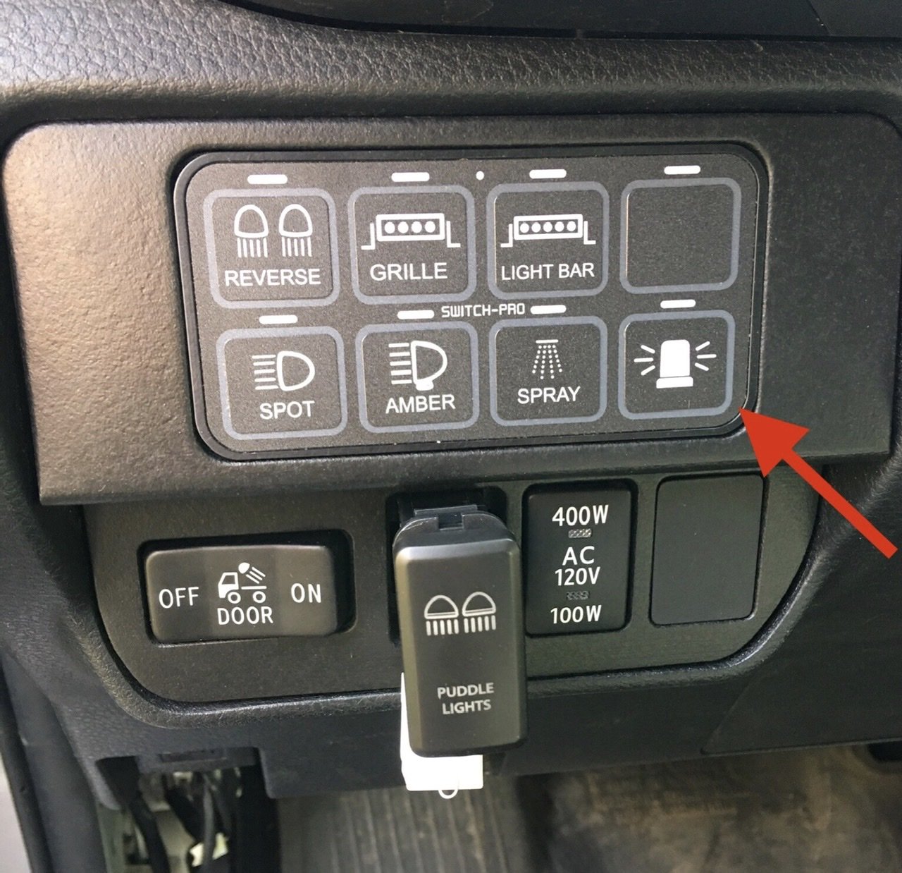

    Anyone know where to get a plug/cover for the small sized switch hole (like the one just below the red arrow, below)?
