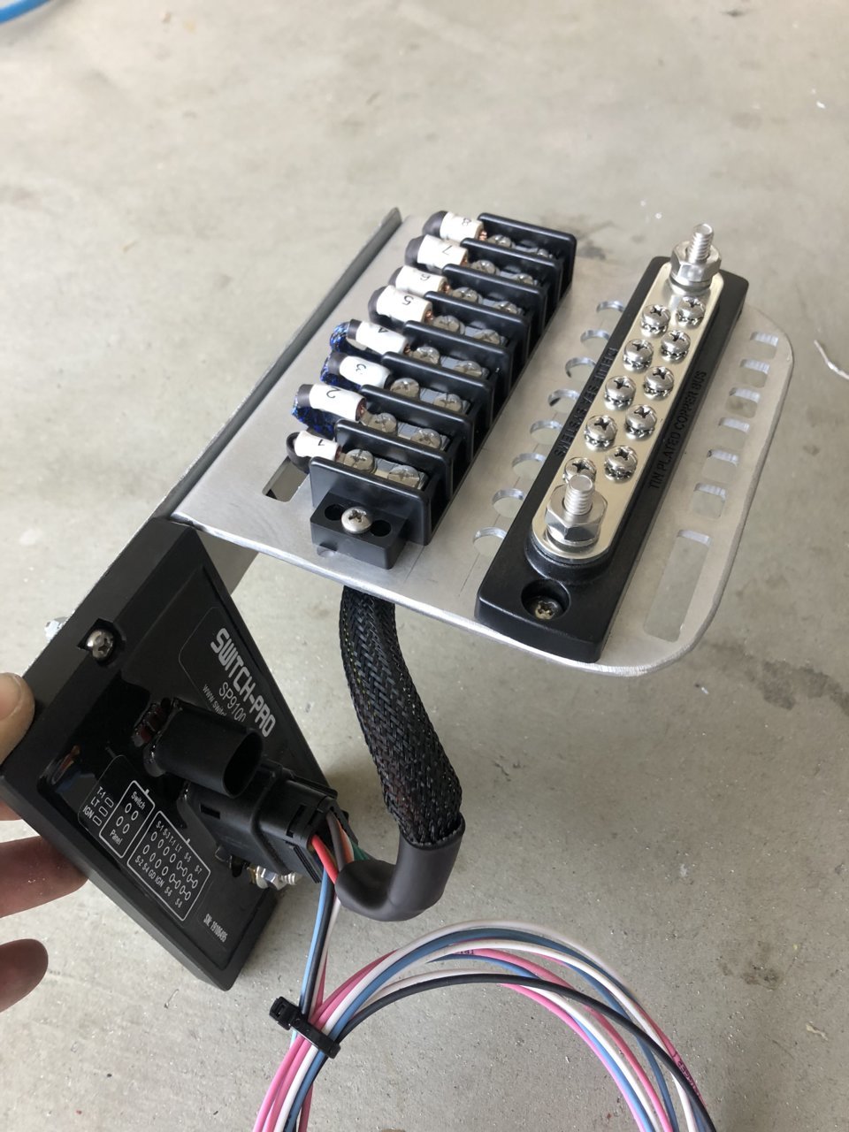

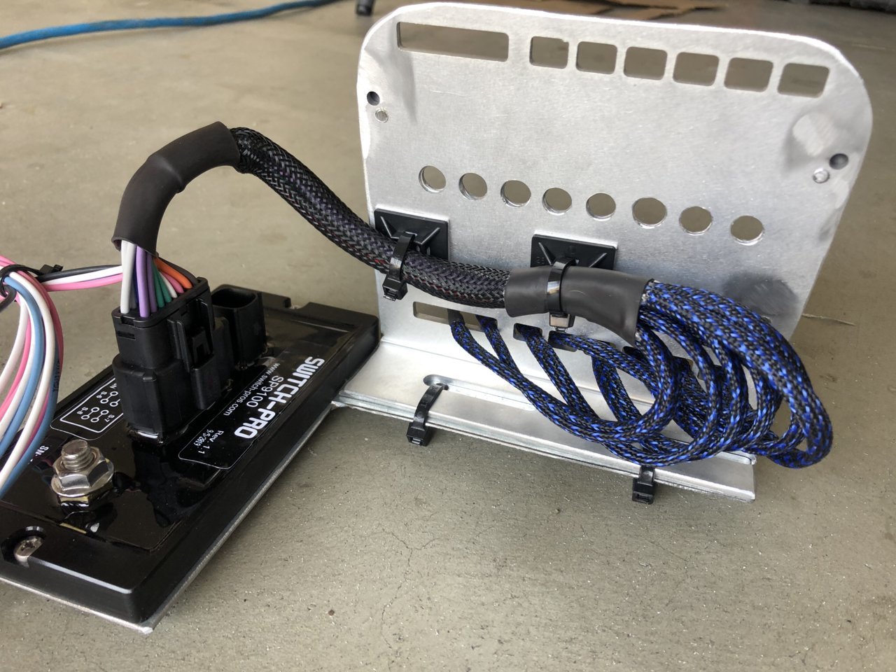

    I would buy this if you made more. Very clean.
