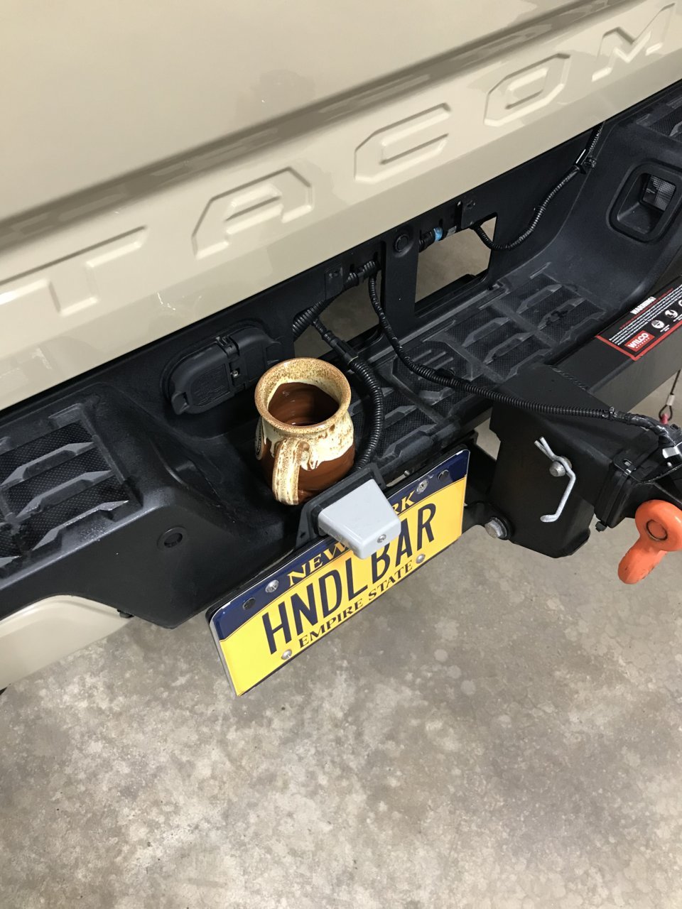

    Did some work last night in the dark. Got the switch plate cable ran through the firewall, up the A-pillar, above the headliner and connected to the switch plate. Also lost my coffee cup while I was working. Found it this morning, after driving around a bit last night and driving to work the morning...
