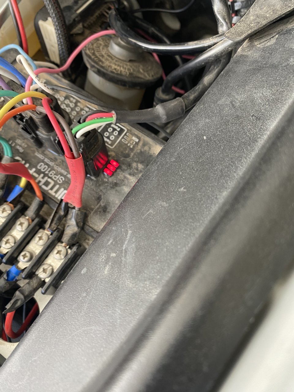

    Does anyone have any issues with the switch pros? I had wired up some amps today and now my halos turned off and my switch pros won’t work? Not sure I tried touching it and could only illuminate the light bar for a quick second and I unplugged batter and still having issues! Any ideas?
