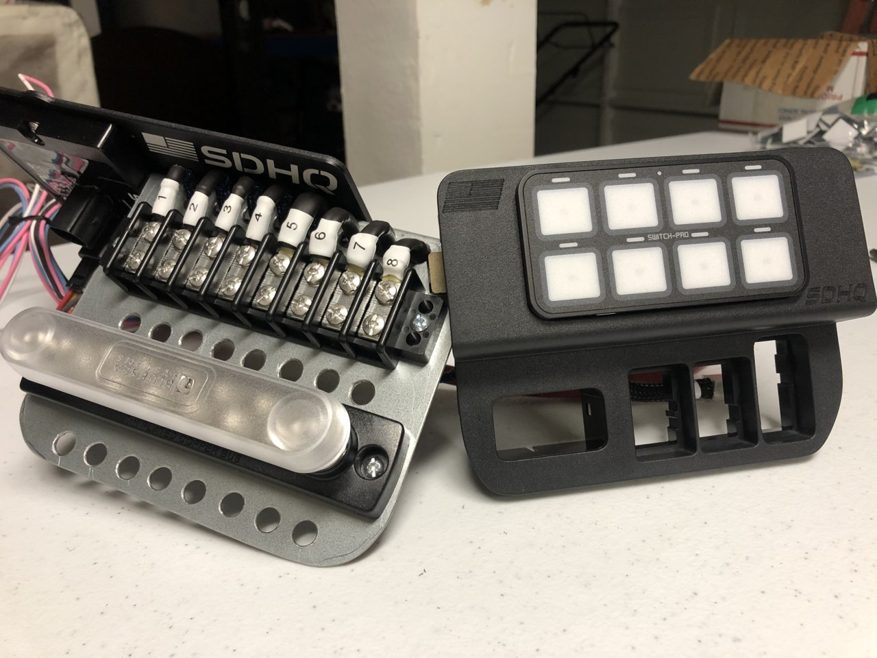

    That’s what I ended up doing. Only using switches 1-6. Put heat shrink on 7-8.
    Last steps will happen tomorrow ! I’m stoked. Customized my SDHQ mount 2794ECD3-B171-448E-B18A-3D42FFE0E778.jpg and prepped all the cable. Ran most of the accessories cables too. I’m not going the horizontal tray route. But I added a central buss bar to ground in the same place.

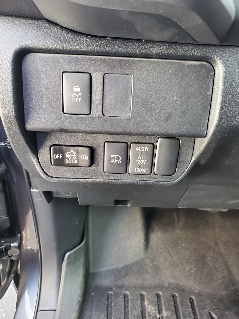

    Unfortunately I dont have room on my center part. So that is where I'm at a loss on what to do. It doesnt help that I know nothing about wiring.

    I did think about trying to use the larger switch. But is there a way I can connect the wiring to a bigger switch that actually fits the larger hole? Make sense?
    And I am actually trying to chat with SDHQ on Instagram to figure it out. They have not said anything about having something that works specifically for it...just mentioned I may have to relocate the switch.
  12. Mar 30, 2020 at 9:17 AM
    #832
    Boltripper
    Boltripper Well-Known Member
    Nov 19, 2019
    #311136
    468
    John
    Hoover, Alabama
    2020 TRD Off Road Access Cab A/T in MGM
    Khaya Camper with Custom Mods - BP-51's, 4.88's, 33's', Dissent Offroad Front and Rear with Bud Built on the sides...
    Yes - CH4x4.com has large switches, but you get a pigtail and then need to figure out what wires will need to go where. I have not seen a diagram that gives a 100% answer on this... I would do the high beam if any switch as I don't want to muck with a traction control button.... I believe the auto high has 2 less wires IIRC....
    I've also seen some large traction control OEM switches for 2nd GEN trucks, but have been unable to confirm if the wiring is the same.
    Sorry I can't be more helpful.

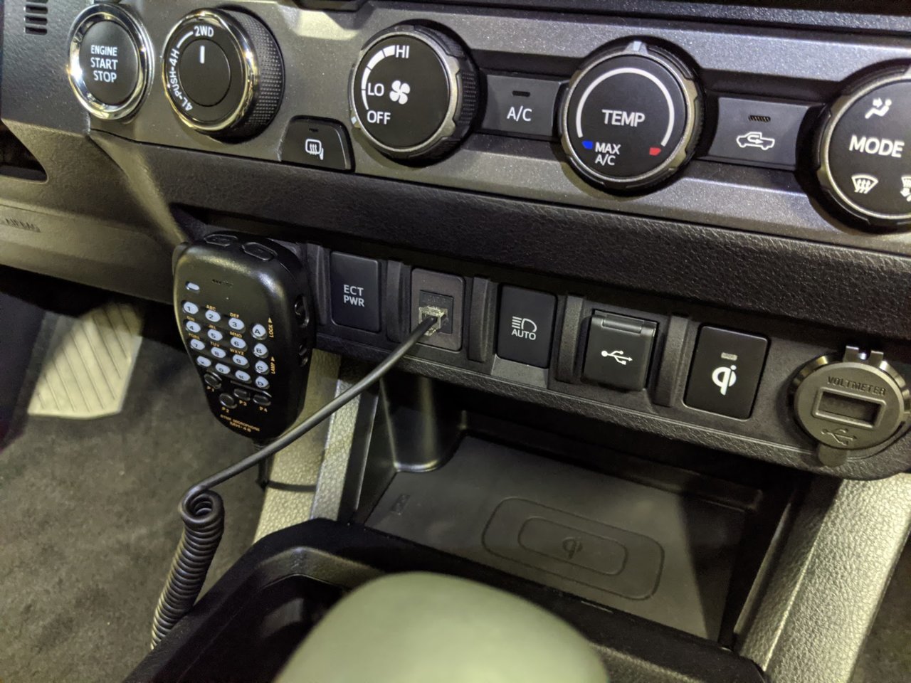

    Where’d you get the blank for the HAM radio plug?

  16. Mar 30, 2020 at 10:57 AM
    #836
    Shellshock
    Nov 21, 2015
    #170338
    23,470
    Iowa
  17. Mar 30, 2020 at 11:00 AM
    #837
    Boltripper
    Nov 19, 2019
    #311136
    468
    John
    Hoover, Alabama
    No problem... Not to roll off topic, but I'm liking mine here.....

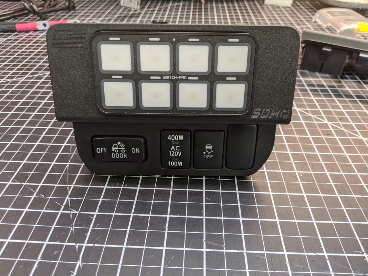

    So I just looked and realized I have a spot or two up top. Is there a place that would custom make this panel to make it look professional? I dont want to cut into it myself and ruin it. I will probably put my auto high beams up high and traction control switch where the auto high beams switch is. I dont feel comfortable trying to splice wires to the traction control switch just to make the wiring long enough to run through my A Pillar and roof.
  19. Mar 30, 2020 at 1:41 PM
    #839
    Shellshock
    Nov 21, 2015
    #170338
    23,470
    Iowa
    meso makes a panel that goes up there (not sure if he has one for the 2020s yet with that extra button)
    not sure that theres anyone that makes extensions for the switches
