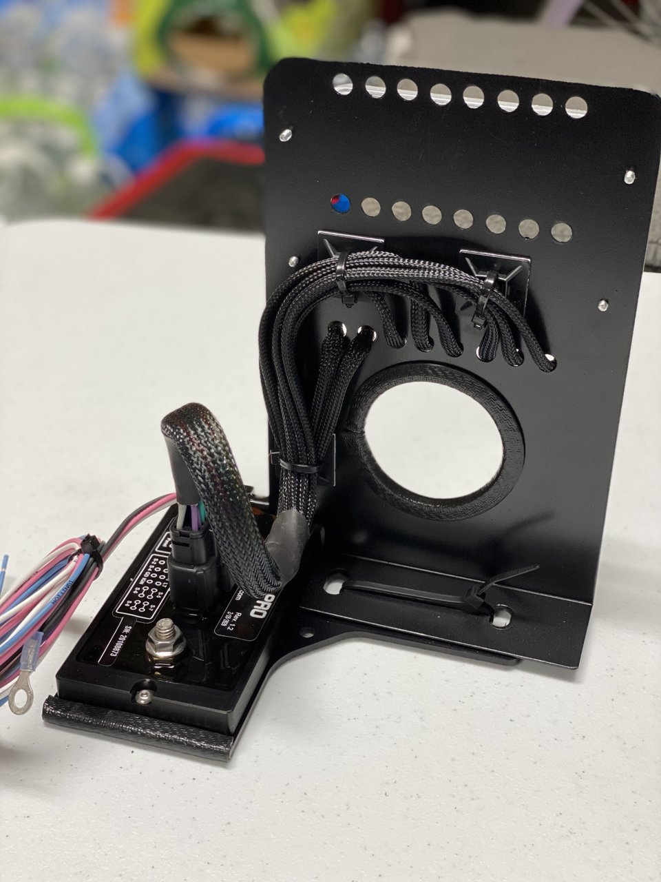

    Anyone have issues with them after mounting them horizontally?

    The only people that have issues are the ones that mount horizontally.
    water can get in the connector and start corroding things. Not an issue if it’s vertical. There’s pix in this thread.

    What if I heat shrink the leads going in the connector so what can’t get inside...?

    I’d just mount it vertical and not have to worry about it.. There’s a reason it’s recommended.
    you don’t have to, but if it does get water damage and corrode, it voids the warranty due to improper installation.

    I just ordered the SDHQ vertical mount. Where did you find that terminal connector mount?

    if you must have it mounted horizontally, use lots of dielectric grease to prevent water intrusion and corrosion.

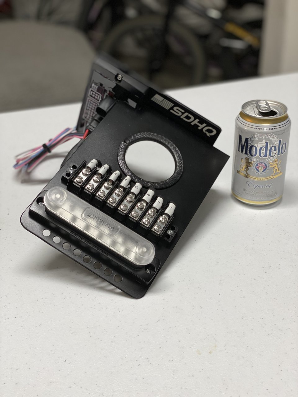

    SDHQ Mount OTW
