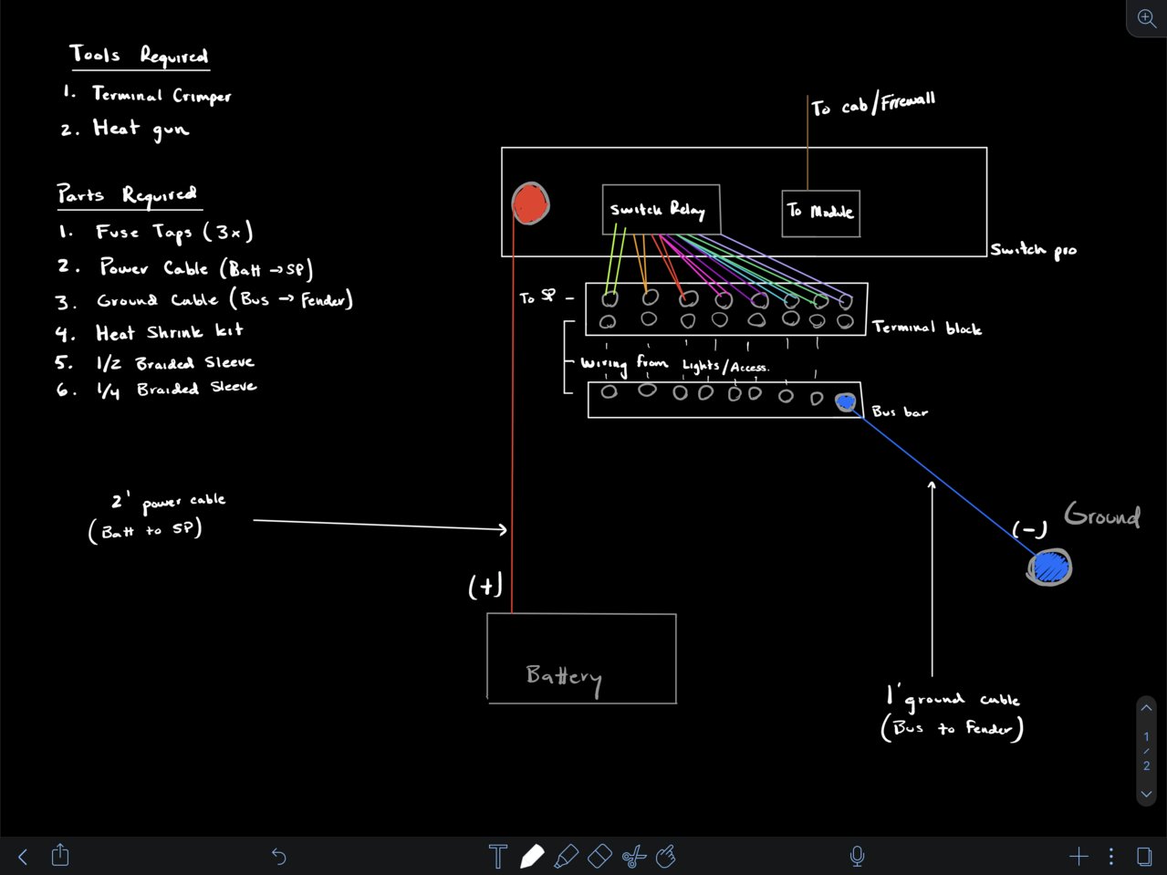

    thanks to everyone before for the help. I mocked this up to help organize my scatter brain. Anything I’m missing? Any advice come to mind?

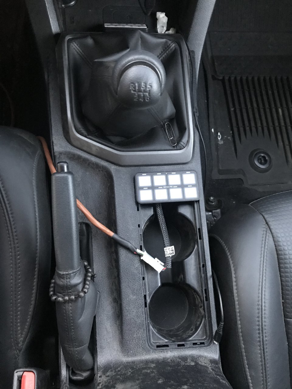

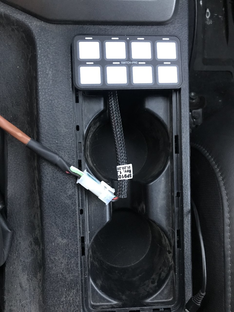

    OK, I have some questions about how to mount my SP9100 panel.
    Im considering mounting it near my cupholders. Why? So I can see them, and also rest my arm down near the shifter and have easy access to the switches. I hate having to reach up to activate any accessories. (old radar detector habit that died hard) Also this space can't really be used for anything else. I was thinking about getting the @MESO customs coin slot/bin holders that he designs for the MT tacoma and mounting the SP9100 to that, and drill a hole in the cup holder area for the wires to pass through.
    Or, I could mount it with the cupholder trim removed and cut the cupholder trim to fit around the switch panel, which would make everything somewhat flush. The only thing is I don't know of a way to mount the panel in this location. I would need some kind of bracket or something to hold it down.
    Im open to any suggestions
    Here are some pics of where I am considering mounting it:

    I like this diagram. This makes the perspective alot better to understand on the installation of a Switch Pro 9100.
    What power tray are you using?

    I’m not sure I’d want to mount it there. I feel like its too in the way to get accidentally bumped and you’d end up with things getting turned off and on unintentionally. I’ve got mine mounted in a similar pace in my tundra and I’m not a huge fan.
    I mounted mine overhead on on the vertical spot right by the sunroof in my tacoma. It’s super convenient since I just go straight up from the shifter.
    I dont actually press buttons on it all that much, Usually I’m just relying on the trigger.
