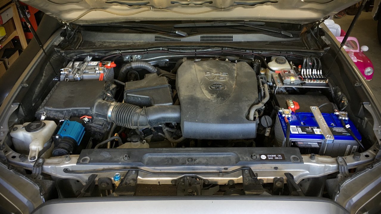

    correct. There was a guy on here who used to sell adapters for the slee 2nd gen mount to mount it like below. I’ve got one, but again, I’m certain he stopped selling them.

    Slee bracket to put it up by the washer fluid resi is a good choice. I built a plate to mount the compressor in that dead space in the pax side back corner

    The slee vertical mount for the second gen WILL NOT work on the third gen unless you make a custom bracket like I have. The guy I got it from does not sell them any longer and I don’t know anyone else who does.
    they have a mount for the passenger side but I have a battery there which is why I sent the route I did.

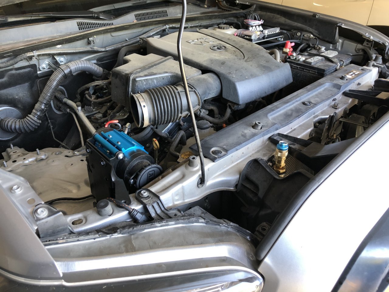

    Have you made further progress yet? I like the placement here...or even below the A/C controls.
