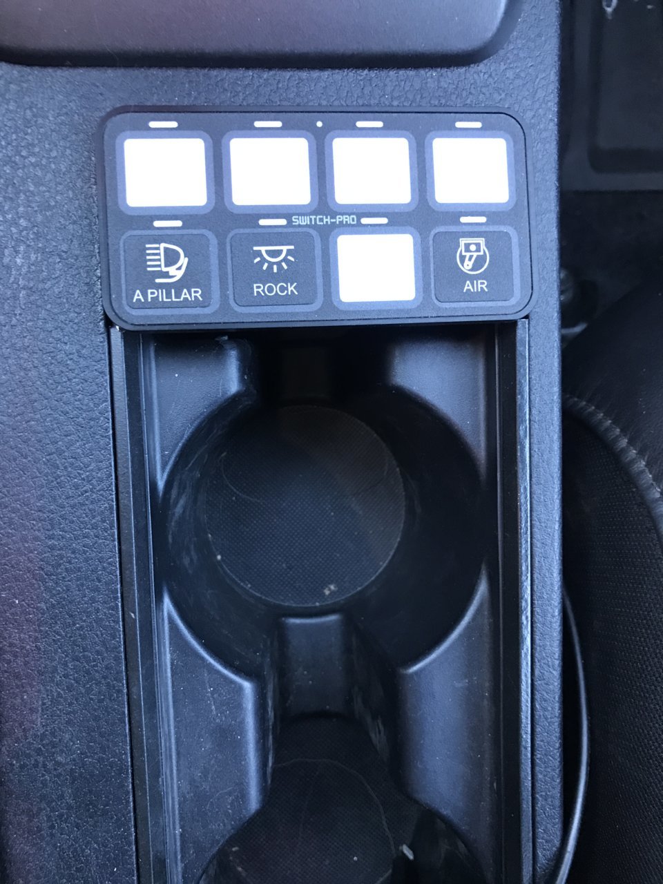

    Yes, I have. I drilled a hole in the square cubby and ran the wires underneath so its all hidden. Then I used scissors to cut the cupholder trim until it fit flush against the SP9100. I used some foam to make the fit tighter, However, I think I will try to find some L brackets and drill them into the sides so it is mounted more firmly. Right now it can kinda pop out if I was doing something extreme. I'll share pics tmrw.

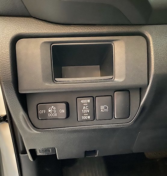

    Does anybody who installed their switch pros have a stock cubby I could buy from them? The tabs on mine broke.
    I am looking for this configuration.

    U looking for the pocket or the bigger encloser with the switch cutouts?

    The whole thing, but primarily the larger part with the switch cutouts.

    Actually I do have the whole thing. I had the other insert that had 3 switches, but I still have the pocket and full enclosure. PM me?

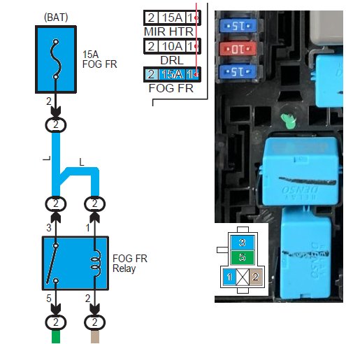

    does anyone know if there is a wire in this plug for the fog lights? @caribe makaira ??
    I currently have it tapped for the reverse lights but I want to switch it up to trigger off the fog light signal instead. Thx

    If I remember right, there is a fuse for the fog lights in there that you could just use a fuse tap on. Thats what i did for my high beam trigger.

    there is but I cut my white wire short and that means I gotta buy a $6 add a fuse and extended it. I’m lazy and since I have the red wire tapped in that plug for the reverse lights, it would make things much more simple to just tap into a wire on that plug...assuming there even is a wire for fog lights on that plug.

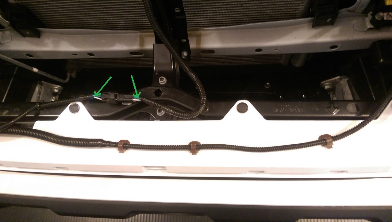

    No, there's no fog circuit there at all. Tap the connector below the grill that splits to the fogs. (EN1)

    damn. Ok. I’ll just run an add a fuse then.

    Not to the fog fuse, it's always Hot.

    I finally took some photos of my SP9100 install, near the small square cubby behind the MT shifter. It is screwed in and now it is not going anywhere. Super secure and now I can press the buttons without fear of it popping out of the cubby. Also, just hooked up my trigger wire to my high beams. And installed the new LED headlights.
    @daveeasa I used the SQHD bracket to mount the power module of the SP9100 and ended up having to trim the bottom piece of the bracket off because it was in the way of a wire look directly beneath the bracket. At first I left the MT resi with a single bolt before I trimmed the bracket. Now that the bracket is trimmed, I was able to get both bolts back in and holding everything more securely. I am not sure if you will have fitment issues adding a power tray. Hope that helps some...
