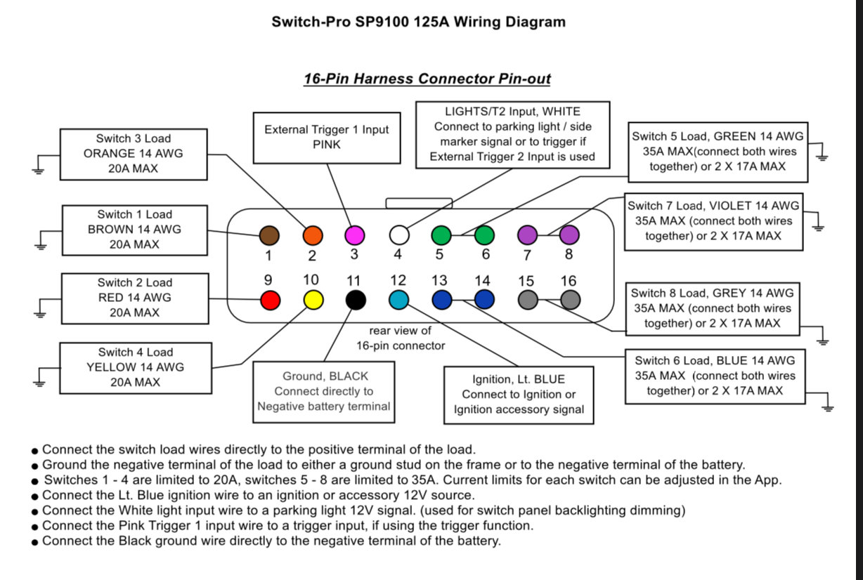

    fogs are aftermarket and wired directly to the SP. The green wire from the fog relay will work for my intended purpose, it’s not powering the fogs I just needed the output 12v+ wire so I can tap it with the white wire from the SP harness.

    I want the white wire (trigger 2, #4 on the 16 pin plug) from the switch pros to trigger my fog lights when the switch on the stalk is turned on, hence why I wanted to know where the 12v output for the fog lights is at in the fuse box. I am not using factory wiring to power my fog lights, the SP is.

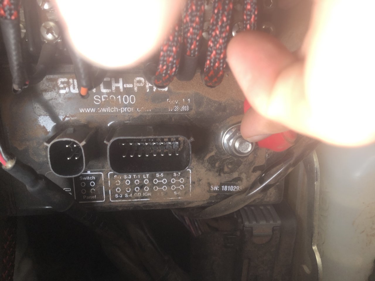

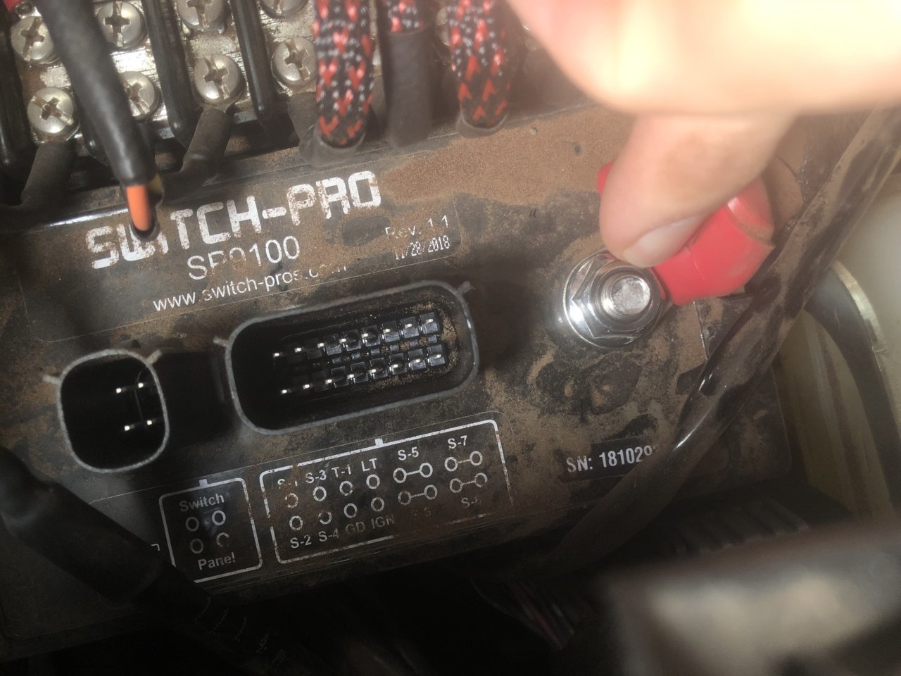

    they look clean to me?

    FIGURED IT OUT!
    The small ground from the plug was coming loose from the fitting I put on. It was under srink wrap so I couldn’t tell until I started pulling it apart.
    Thanks for the help everyone

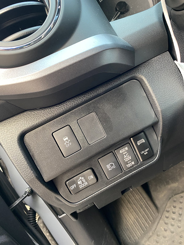

    How are you guys mounting the switch pro in the 2020s? All the available mounts say not compatible with 2020 or would need modification

    This is how my switch panel looks like. Its identical besides losing the cubby and placement of switches.
    I saw a switch panel from cali raised off road and the description read "*Requires modification of some OEM mounting tabs in use for 2020 models"

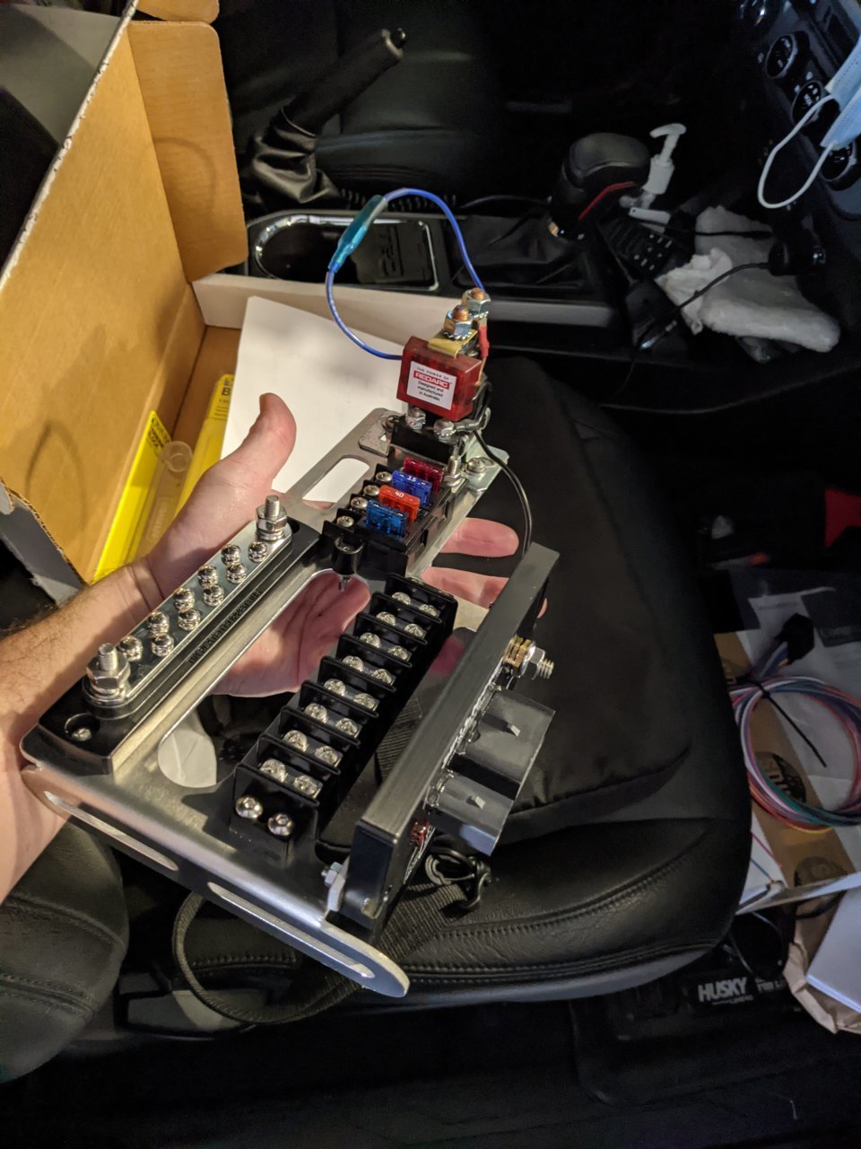

    My new powertrays setup. Fit the redarc at the end nicely
