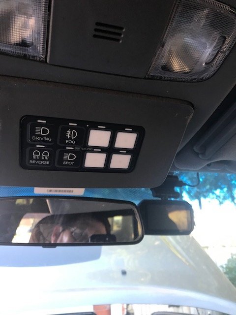

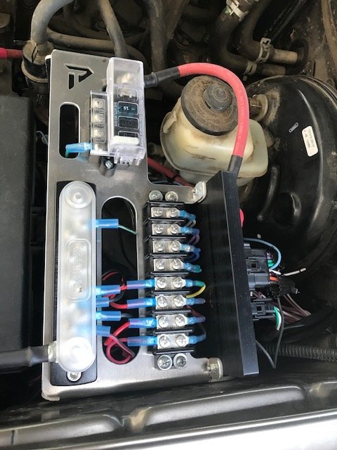

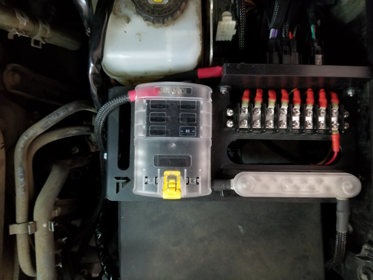

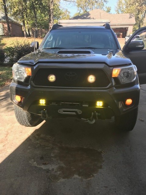

    Been studying "lurking" this thread and others since spring. Slowly gathering components over the summer, running wires, installing the MESO overhead swith panel, mounting the SP to the Power Tray and finally got my system up and running Saturday before Daylight Savings time when I really need the lights. Thanks also goes to @ramonortiz55 for his thread on routing wires and component mounting.
    Took my time, thought everything out 3-4 times, put it together in an orderly progression...and guess what. Everything worked first time without any glitches. Thinking about the programming now, bet really, switch on - switch off is working for me now. I haven't hooked up any of the triggers, and can't really think of a reason to right now, at least for my current needs. What I have hooked up right now is the OEM fogs, Baja fog lights, PIA grill mount spots and BAJA reverse lights.
    Again, thanks to everyone who input on this thread, it really made the install relatively easy and a success....:cheers:
