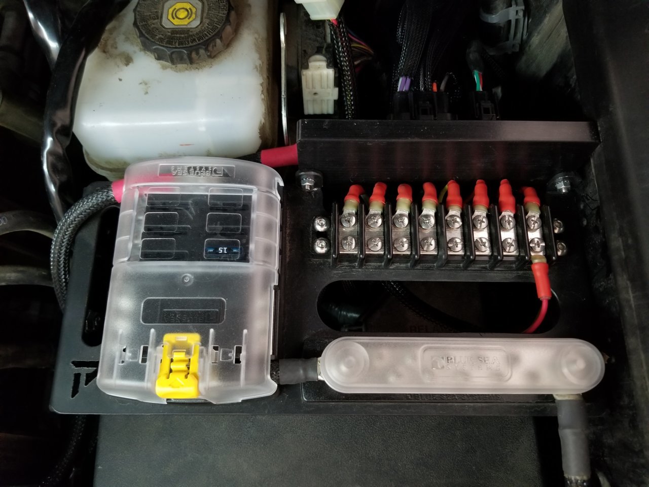

    If you go back a few pages I posted a photo of how I used a fuse in the under hood fuse box.

    Looking for it. Do you recall which

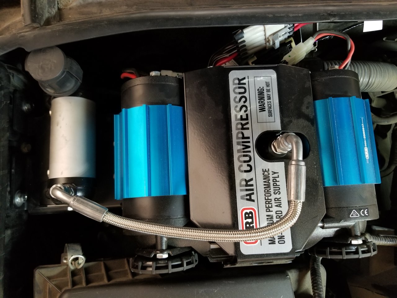

    no you don’t need it. You don’t even need the arb harness except the main power harness that connects to the battery.
    The small plug coming off the compressor is what you need - purple wire is your trigger wire and the black is negative obviously.
    The twin has built in relays so you can run it on 1-4 if you wish.

    Oopa sorry just saw it now. Where is your qd on that arb?

    Quick disconnect

    it’s sold by wits end
    I ran the arb stainless leader line to a push to connect fitting and then ran nylon hose from that fitting to the quick disconnect.

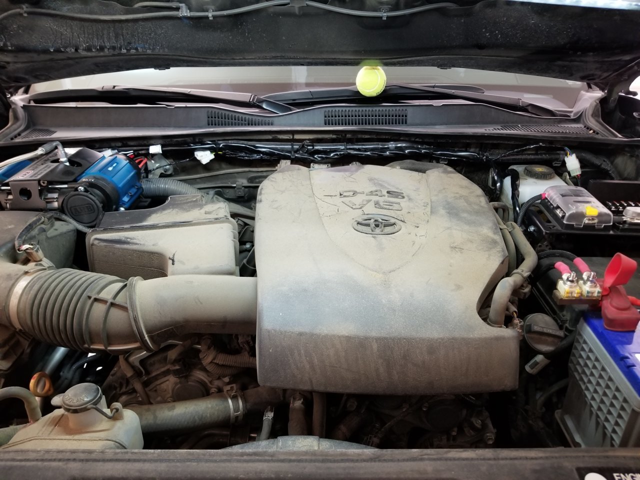

    They say you don't need the ARB quick disconnect harness, but it was alot easier to use and connect to the Switch Pro. I liked it and it works for me.

    So this is not needed: https://expeditionessentials.com/pr...mount-extension-harness?variant=2137337167881
    I am running the dual compressor all the way from the bed
