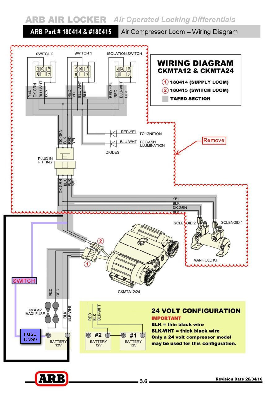

    no it’s not unless you have air lockers. Cut the plug off that has the purple and black wires. Purple goes to the switch pros and black to a ground. The power harness goes to your battery.
    you can certainly use that harness but doesn’t make sense to have all that extra wiring and plugs if you aren’t using them.
    here is a diagram. The “switch” would be your switch pros instead of a flip switch like it shows.

    Yes, I will be running an ARB air locker.’so maybe I should get it

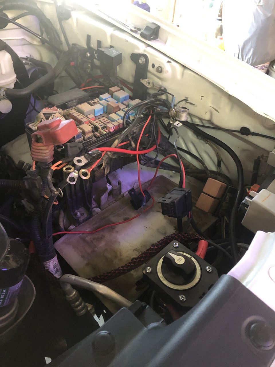

    23,394
    Iowa
    this is how mine is wired. Starts right up
    JKDer[QUOTED] likes this.

    This looks like how I'll probably do mine.
    Your picture has three taps.
    Would you mind I identifying what is what?
  14. Dec 3, 2020 at 7:31 PM

    INJ is what i used for ignition (blue). Low beam for illumination (white). High beam trigger (pink)
    If you remove the 10mm from the fuse box, you can unclip and disassemble the harness and come in with the factory wires.
    Closes just fine. Just make sure all the wires are inside and dont get pinched by the lid
