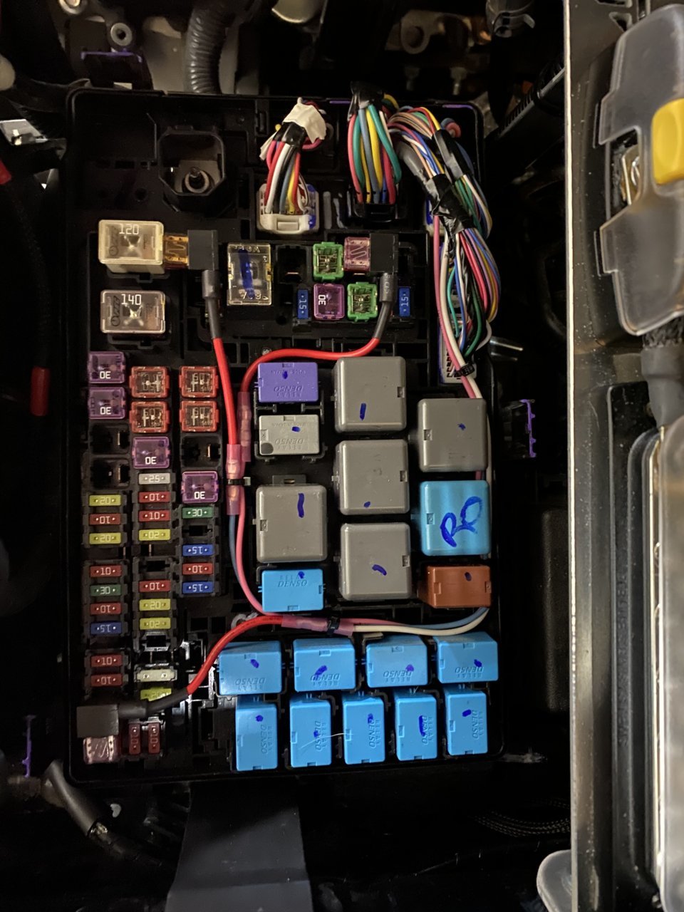

    That is weird. Mine is constantly backlit. I forget where I did the add a fuses , but I pretty sure I followed @Shellshock pic from way back. I have like 5 of his fuse panel pics saved on my phone. Lol

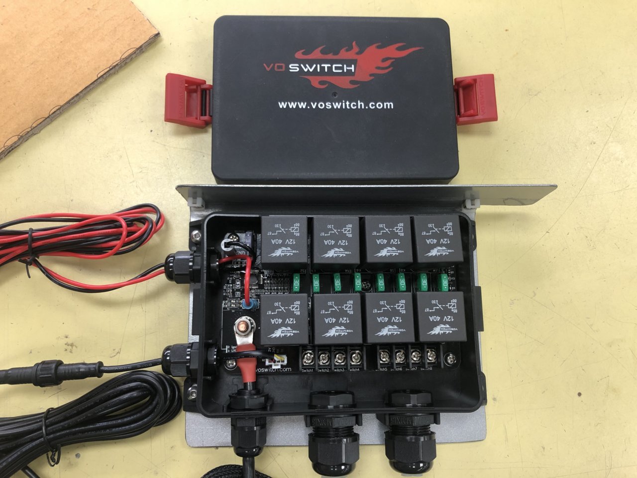

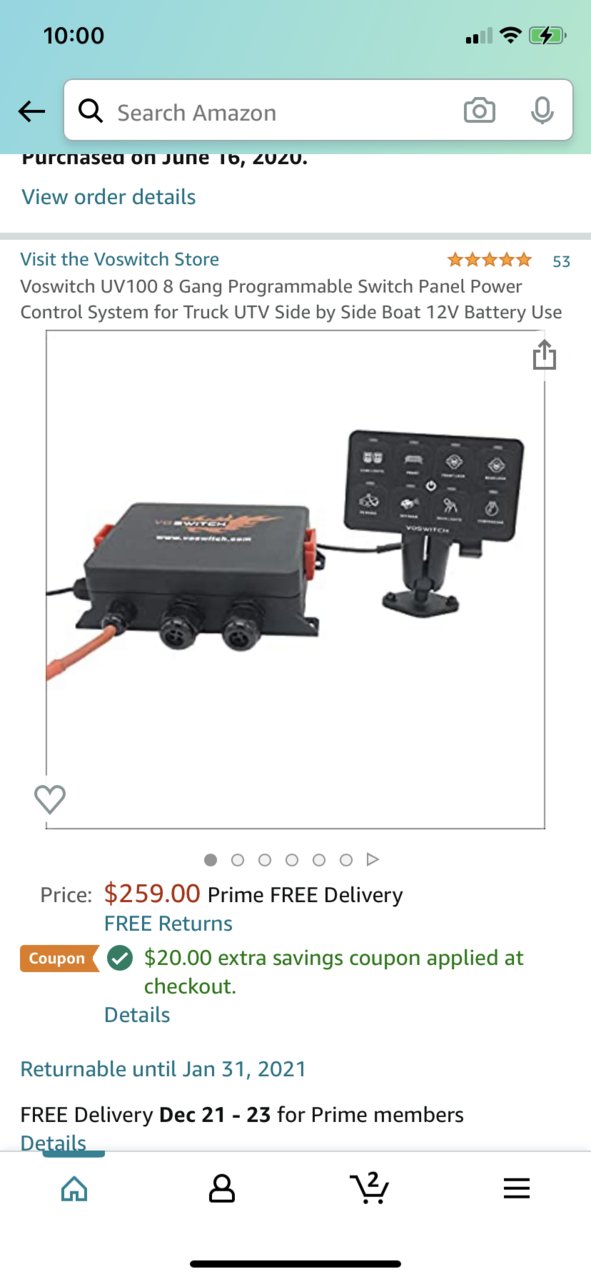

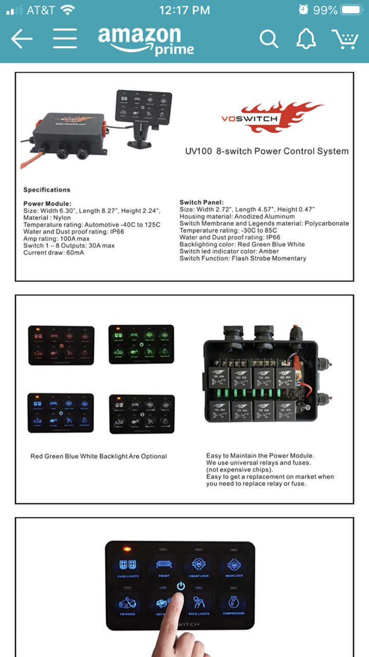

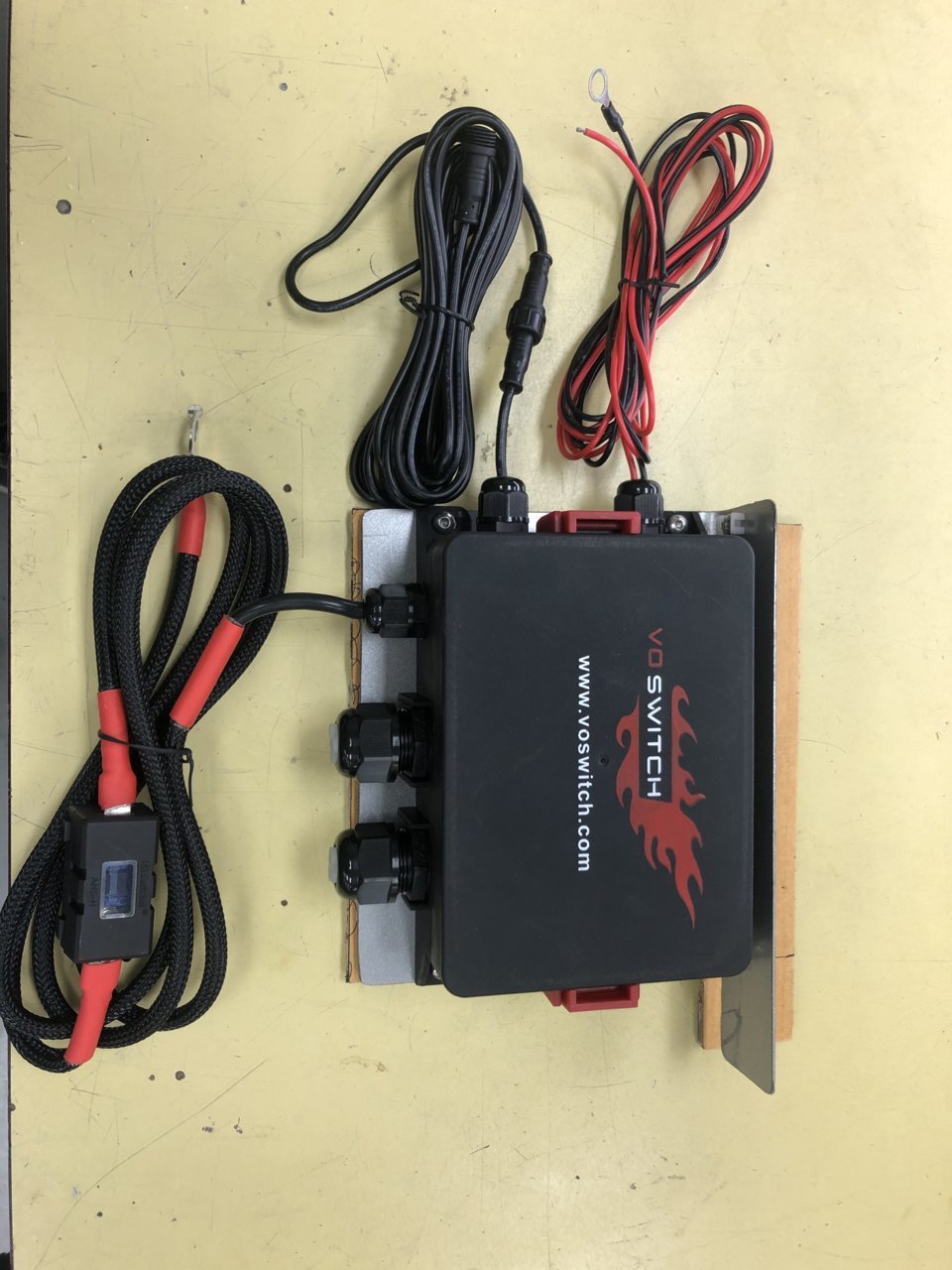

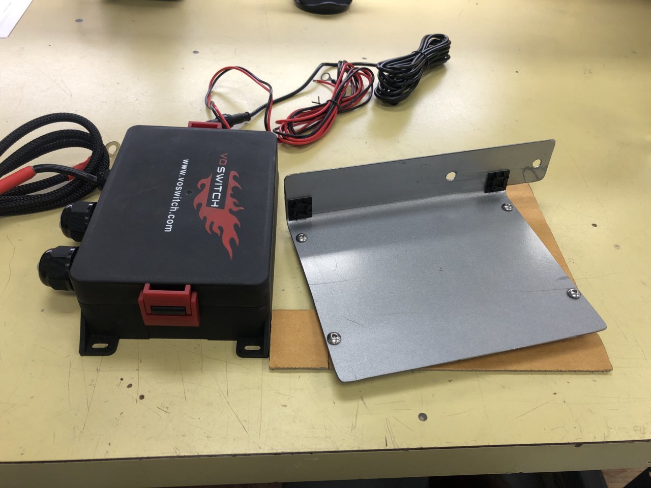

    Not a switch pro but is very similar and a fraction of the price. I have had mine installed for 6 months and nothing has failed. It really just came down to what features I needed like making sure the electrical box was sealed with a gasket, 8 gang programmable switch style button pad, and programmable function like momentary, sos, and emergency flash options. I’m sure the switch pro is better but it does what I need and I saved a few hundred. The mounting plate I had to make FYI.

    I tapped all three wires in the engine bay fuse box.
    Inj for ignition
    Low beam for backlight
    High beam for external trigger

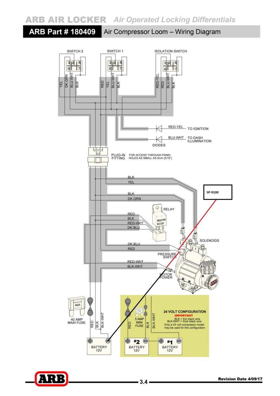

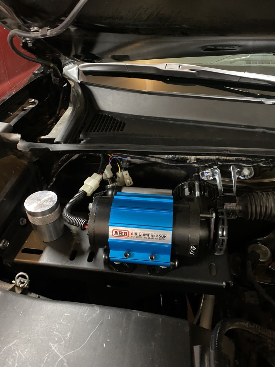

    Can anyone confirm that the ARB single can be wired to the SP as such:
    I don't want to fool around with their wiring harness or using a relay since I don't plan on using lockers or their included switch. The single draws 32a at max load, so it should be fine on switches 4-8 since they are rated for 35a.

    Arb relay should go to battery direct then run red/yellow with diode to switch pro

    I’m not using the arb harness or relay. The SwitchPros is a relay so there is no need for a second external one.

    I believe the relay is used to keep the load of the compressor from going thru the pressure switch. How are you handling the on/pressure?

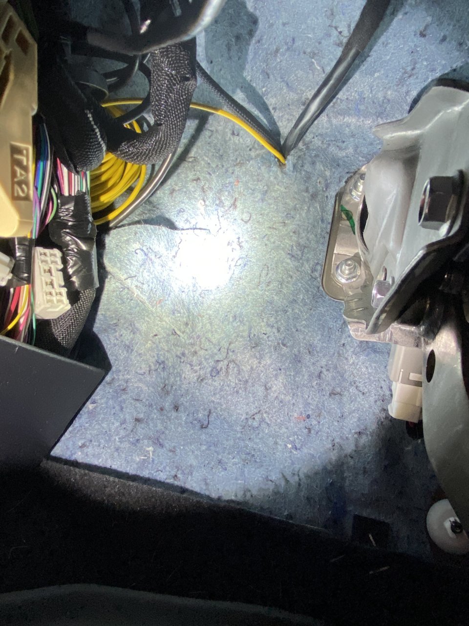

    david here is where the wires pop thru

    SearArtist - the NO LOAD current of the CKMA12 is 14.2A, FULL LOAD is 32A. I would suspect that pressure switch isnt rated for 32A of current.
    https://www.arb.com.au/assets/air-lockers/6-07.pdf

    Getting a pic is going to be tough until after Christmas due to my work hours. But if you go to page 3, post #56 of this thread, thats the exact place I ran my wires through. That rubber grommet has a large nipple on it so I turned it inside out, cut that nipple off, then drilled a hole through the remaining rubber and pushed the plug right through. Hardest part was getting the plug through. Hope this helps.
