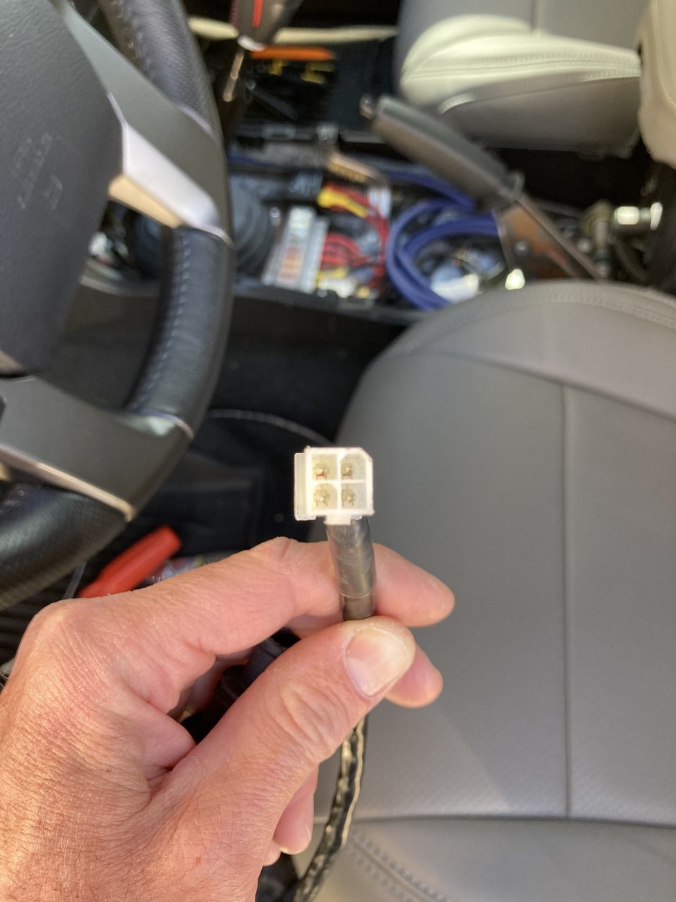

    Thanks @907rx7 for all that. Dropping the headliner for sound deadening is on my list but it’s near the bottom of it for now. Because it’s a lot of work and with the ages of my kids there is significant risk of parts lost or broken midway as I don’t really have a big block of time without them to start and finish the entire effort.
    I like this option though. Good reason to stick with the long cable for now. Though with pins and connector pairs I could turn the existing cable into a short + extension sort of system.

    That would have been awesome to know before I finally got it apart and got it routed.
    I'm going to order some pins and just shorten it in place.
    Searching for the pins I also found a better diagram on the connector internals that would have helped me visualize how the release worked.

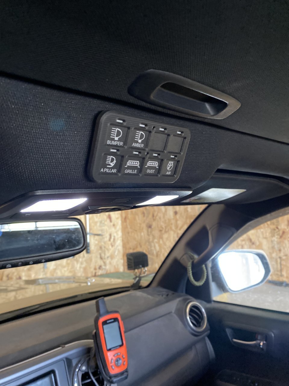

    Was just thinking about this... Since the low beams turn off when the high beams come on, do you lose illumination on the switchpros when the high beams are on?
    I'm in the middle of planning my wiring attack, finally have all the hardware in hand, waiting on wiring odds and ends.
  7. Jan 24, 2021 at 9:53 AM

    The low beams stay on. They didn’t on the gen 2 trucks
    I’ve had mine wired like this since I put in the switch pro and haven’t had any issues.

    So anyone using their Switch-Pros for something other than lighting / compressor / winch? I haven’t yet found a truly fun purpose for mine. One idea I had was to raise/lower the spare if I found a powerful and waterproof rotary motor.
    I’m planning to use it for a bedside compressor and bed lighting once I make those purchases. But that leaves 6 other circuits to employ.
    ISO ideas :)

    I run the dual function light bar on mine(2 switches; one for amber and one for the white light), Driver side LED Pod on one circuit, Passenger side LED pod on another, and both the bumper mounted spots in the 5th spot. Eventually, I would like to run a compressor and lockers in the last 3 locations(although I may just swap to a TRDOR rear axle, and go electronic for the rear locker-portion).

    I have 4 switches currently consumed by lights... I’ve considered putting my fridge on a switch but I’ve just got that direct off the battery currently. I was going to mount a compressor but I’ve just been using a portable one and connecting it when i use it.
