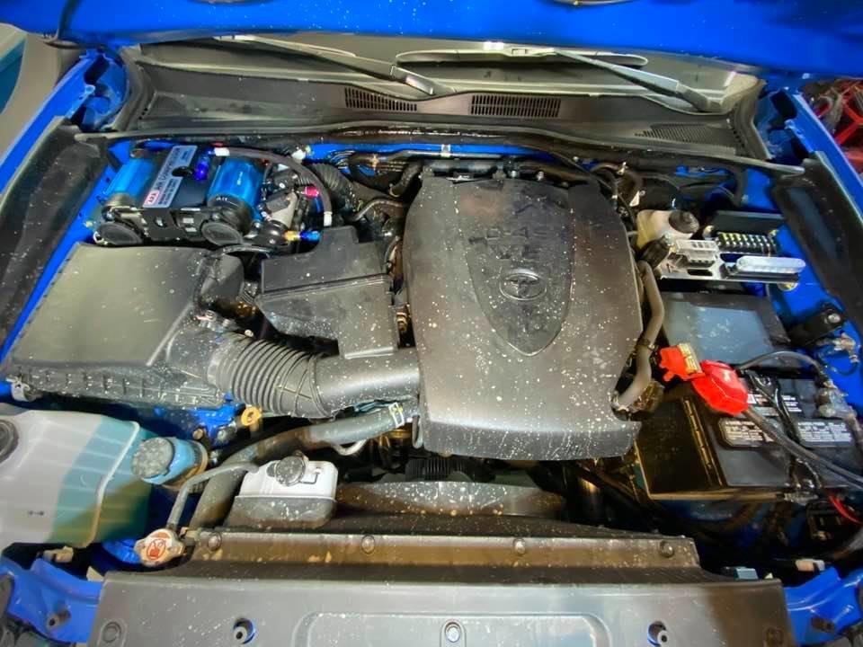

    some welding required
    power trays is an easy button
