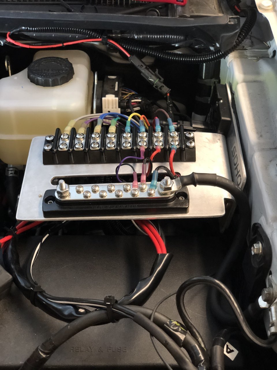

    Well my bracket is finished and found some time to do the wiring.
    Went from this
    To this
    Made the bracket out of 5053 1/8” aluminum, just using a vise, jigsaw, some drill bits and files.

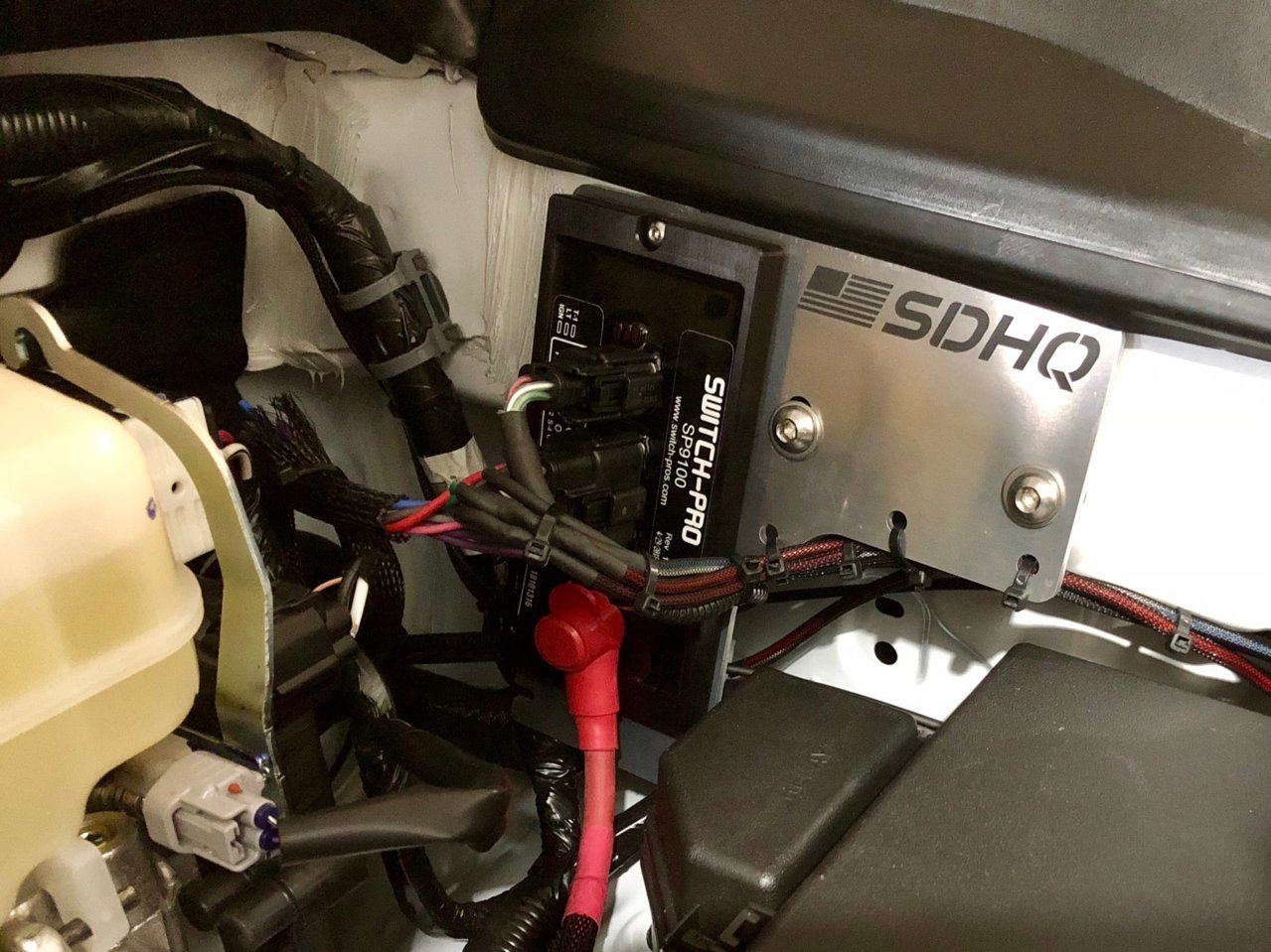

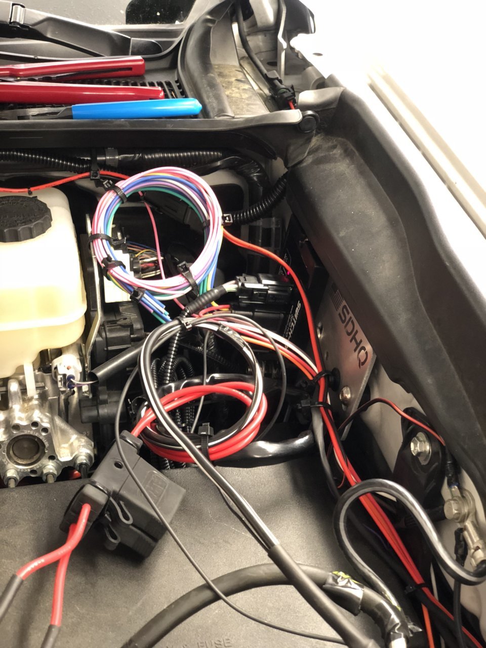

    I finished my install today using the SDHQ panel and cabin mount. I used three Deutsch DTP connectors with Raychem DR-25 to give good weather resistance and wire protection. These connectors also don't take up too much space. None of the outputs are wired yet, but I've got everything for the front and rear cameras, so I'll do that pretty soon. I'll also wire up the ARB compressor once I figure out where I'm mounting my air hose disconnect.
    I used the high beam, low beam, and injector fuses and drilled through the relay box.
