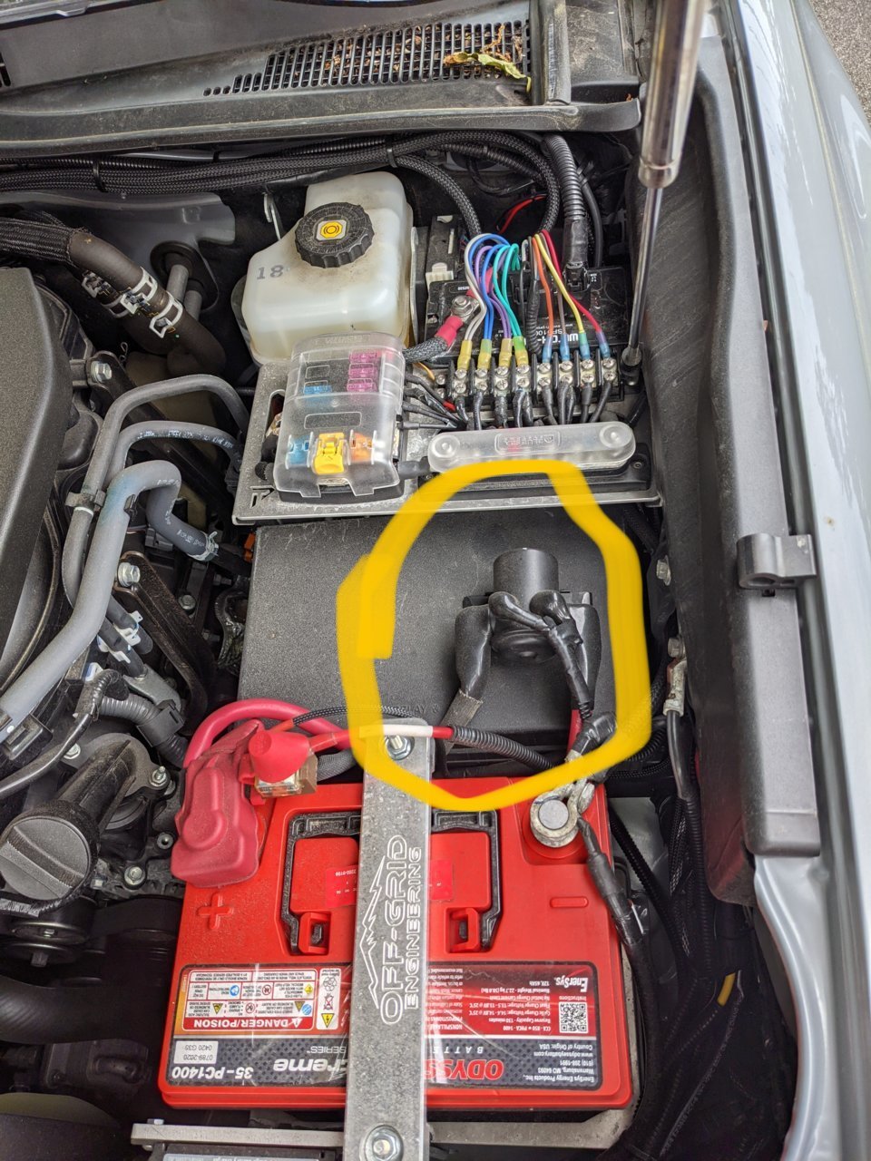

    I have that exact setup. I run all my add-ons off the secondary battery except for my winch. I ordered custom length cables from PowerTrays when I got my 2nd battery.
    I did this to reduce strain on the primary and to prevent anything non-essential from killing the main battery then I don't really have to worry about it ever not starting.
    Picture for reference. The blue seas dues box positive goes to the switchpro positive and then to the second battery. The negative terminals for the switchpro is connected to the blue sea fuse box and then to the second battery

    Thank you for this information and the reference photo. My setup will be very similar although I have no winch yet. My philosophy is the same in regards to reducing the strain on the primary battery and having all accessories on the aux battery.
    I hadn't though of connecting the blue sea positive to to the switch pro positive, then running from the switch pro positive to the aux battery. My brain was assuming that both had to be run independently based off the cables I got from the kit I ordered. That makes sense and can reduce some of the lengthier runs.

    Running them independently may technically be better but I haven't had any issue with this setup. Although I don't have anything high draining like a fridge on the blue sea box and most of my switch pro is hooked up to lighting.

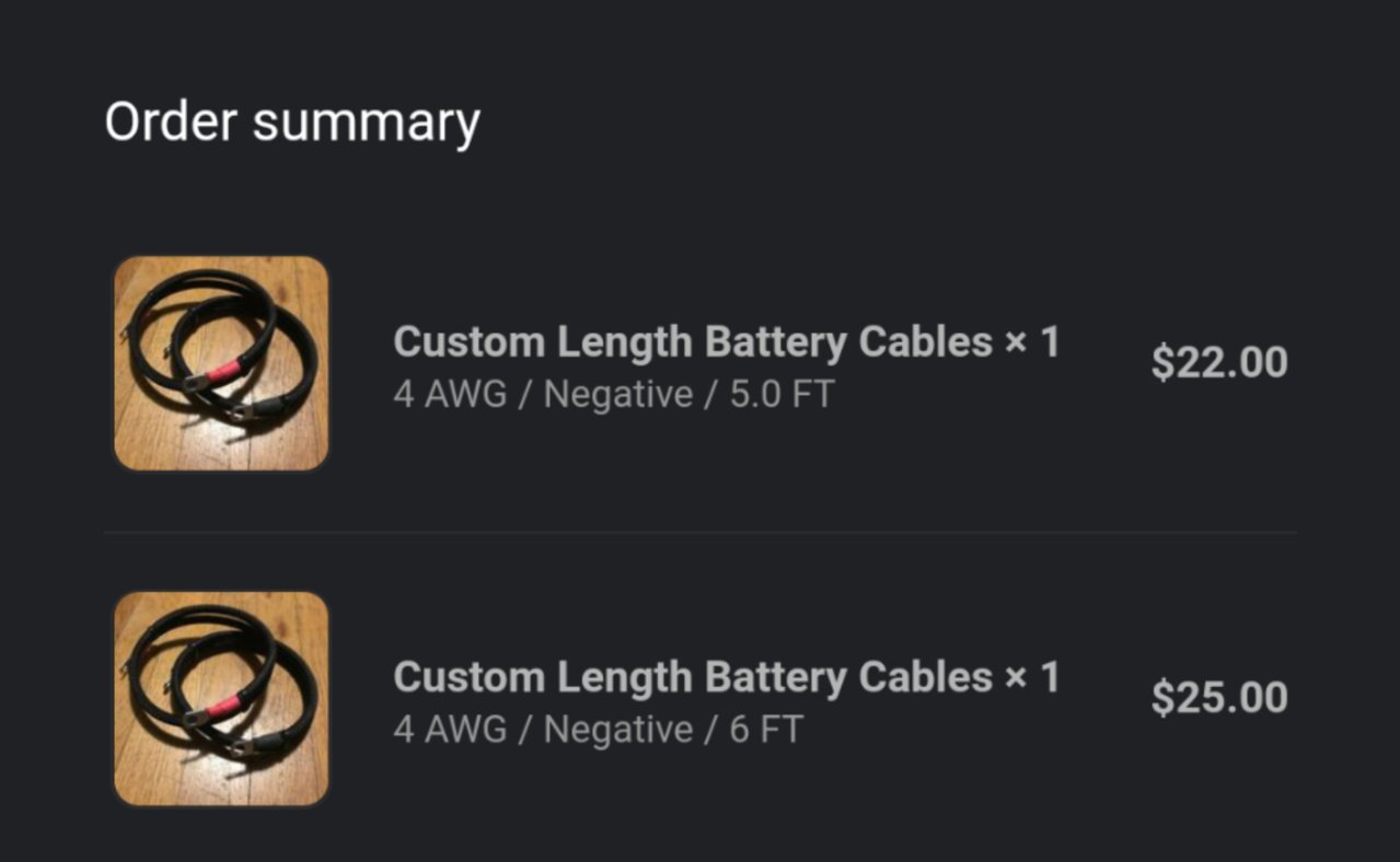

    Just revisited the power trays site and learned they sell custom length cables. Might pick up a few to make my life easier. Going to measure the engine bay at lunch to be sure of the lengths i'll need

    Here's what I ordered a while back. The shorter one was actually positive.

    Thanks! I figured it'd be around 5 or 6 feet, this helps

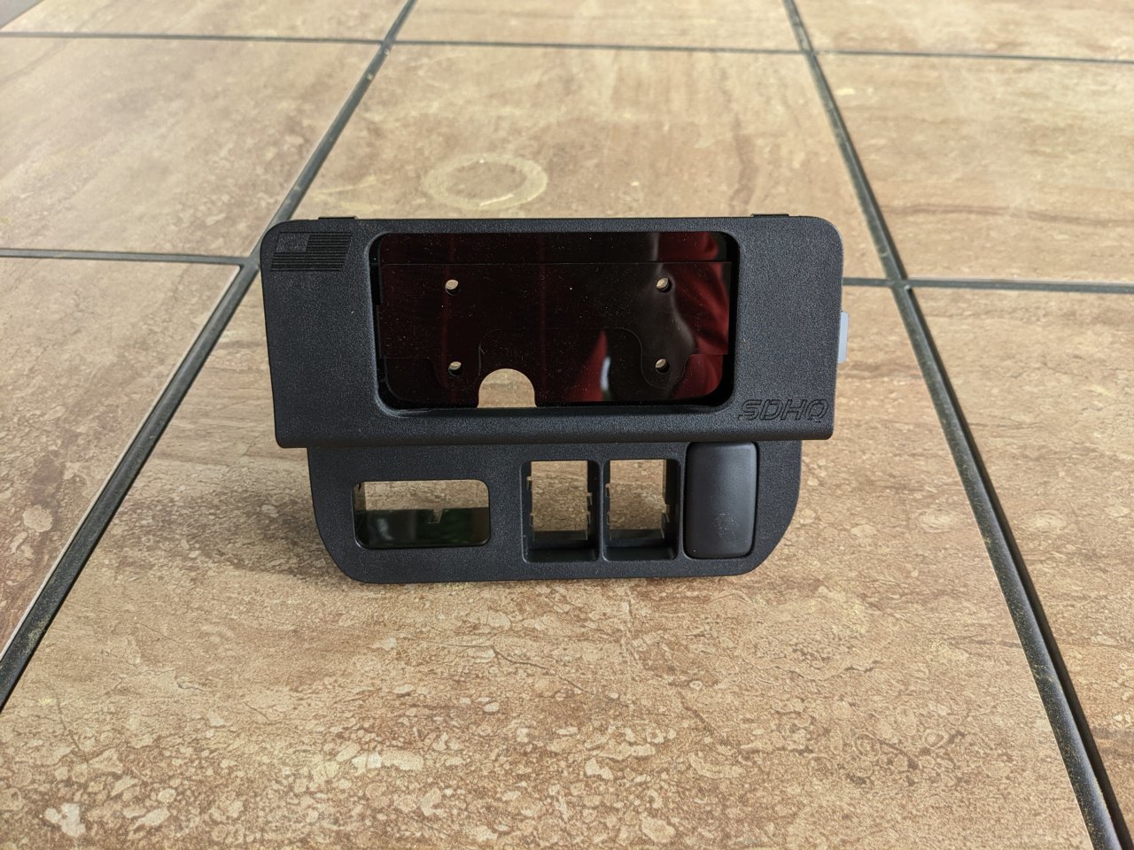

    SDHQ sells several different type of mounts. I went with the extra shelf install for my unit, and it still looks almost completely stock. But give them a look and see if you can find anything.

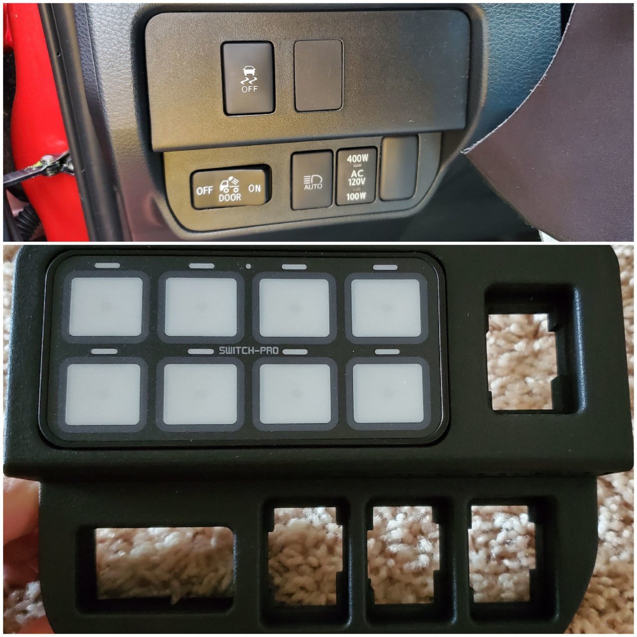

    If you are interested in the almost equal SDHQ one, I have one I'm selling
  10. Jul 1, 2021 at 4:30 PM
    #1410
    Tatoryota
    Tatoryota Member
    May 24, 2021
    #366660
    9
    2021 TRD Pro Lunar Rock
    Tires, seat cover, switch pro 9100 with blue seas/power plate , ONX6 Dual light bar, Rigid industries flood lights, dual battery
    I have found them on etsy for a third of the price. It might hold you over until the other comes in stock. I had the same problem and downloaded an .stl from etsy and printed my own that looks just like it.
    https://www.etsy.com/listing/1034225519/toyota-tacoma-3rd-gen-left-switch-panel?ref=cart
    Skydvrr likes this.
  11. Jul 2, 2021 at 12:44 PM
    #1411
    wornandtorn
    wornandtorn Well-Known Member
    Feb 12, 2021
    #355948
    156
    Nathan
    GA
    2020 Cement Tacoma TRD Sport 4x4

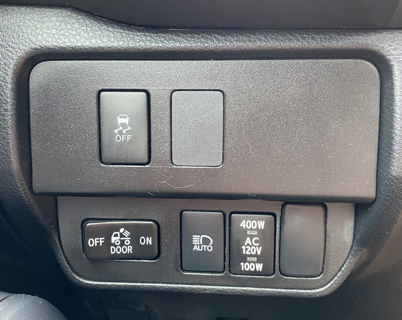

    Hi Fellas - Thanks so much for all the responses. Genuinely appreciate it. My 2020 has the layout shown below. For that reason, short of the @CaliRaisedLed / @MESO being available, it looks like the Etsy version is the best fit for my needs here. Again, really appreciate it. Hope ya’ll have a happy and safe holiday weekend! Nathan

    Is this a solenoid?
  19. Jul 4, 2021 at 5:15 AM
    #1419
    TheTacoAdventurer
    TheTacoAdventurer Well-Known Member
    Sep 3, 2013
    #111758
    799
    Boston, MA
    2018 DCSB TRD OR
    Forever modding!
    Yeah it is. It's connected to my winch. I had issues with my old battery dying last year so I added it to prevent any power drain.
