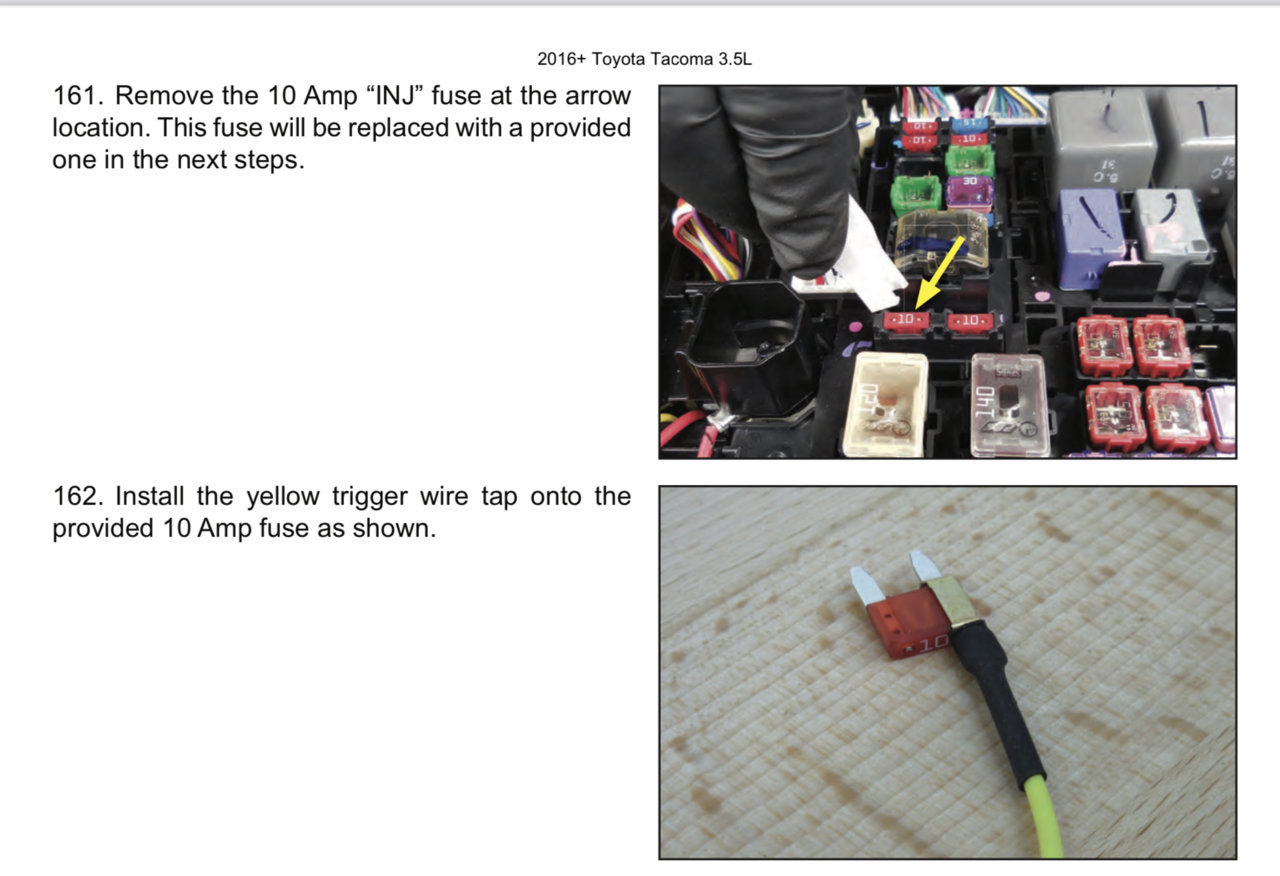

    I have a Magnuson Supercharger that has trigger wire on the “INJ” fuse already. Can I remove this and add this to the same Add-A-Fuse that I use for the SwitchPros? If so, what size fuse should I use for both triggers?
    From the Magnuson install manual

    Since switch pros and Magnuson are just calling for a signal from the inj fuse I think you should be fine to use one fuse tap for both. Keeping the 10 amp for inj in the bottom slot and using 5 amp in the top slot for switch pros and Magnuson. Below is a good explanation on correct orientation for fuse taps.
    Others please chime in if I'm missing something.

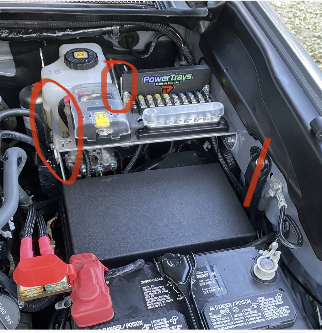

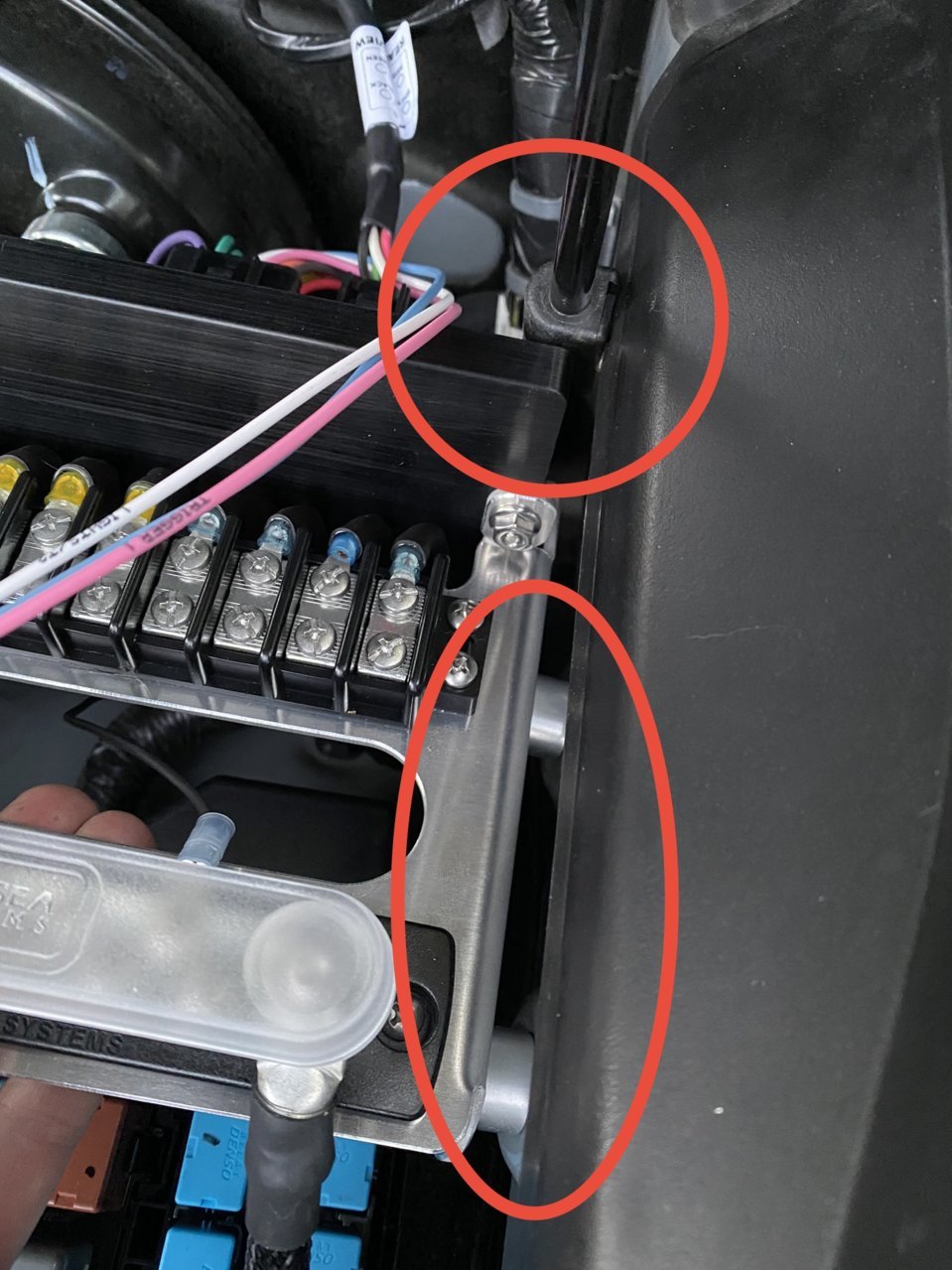

    Fellas - I’ll take any help you can offer. I have my truck apart and for some reason can’t find a way for the power tray to clear my @SpikerEng hoodstruts even with 1/2 spacers installed. Anyone ever run into this? If so, how did you work around it? Desperate here.
    ca08tacoma likes this.
  9. Oct 16, 2021 at 4:05 PM
    #1509
    GuildOutfitters
    GuildOutfitters Well-Known Member
    Jun 24, 2021
    #369539
    68
    Shaun
    Columbus, OH
    2021 TRD Pro Custom
    Custom switch panels, wire harnesses, roof rack, light bar, ditch lights, rock lights, and every week more.
    It looks like you need twice the size of the spacer! Can you take a second photo a little farther back to show how much room you have on the left side of the tray to the other items. (Aka if you had larger spacers, would the tray still fit?) I used some extra nuts and washers on a friends Taco who didn’t order the spacer kit and longer bolts from Lowe’s.
    edit: added screenshot / highlight of areas I’m curious on how much space is left with your truck.

    Hey - Thanks for your reply! I had no choice but to take everything out. I was blocking my wife in the driveway and had to get the truck running again.
    Here’s the weird thing: The spacer kit was purchased from Powertrays for this specific reason, to accommodate hood struts. That being said I can’t be the first one who has ran into this issue with this kit given how many folks have hood struts and powertrays.
    The other issue I ran into was the included M8 bolts seemed extremely tight for the fender screw holes, almost as if they are the wrong fit. Here’s a link for the kit in case I really am the only one trying to use it.
    https://www.powertrays.com/products/hood-strut-spacer-kit

    So after some digging I found a few data points. Might not be helpful. Is your strut push rod on the fender side and not the hood side?
    • The power trays picture doesn't have the driver side plastic trim.
    • They used rivnuts and bolts instead of rivets.
    • They're using the spiker engineering mounting location.
    • Unless there's another brand I think it's a spiker or redline kit (Sobietech is completely different).
    • Maybe the have a strut mount with a shorter ball post.
    wornandtorn[QUOTED] likes this.

    The 1/2" spacers are not going to be thick enough. You typically will need ~ 1" spacers to clear the powertray. Here's a photo of an installation using Home Depot procured 1-1/8" spacers:
    Or you can make a more elegant version with some spacers, like this:
