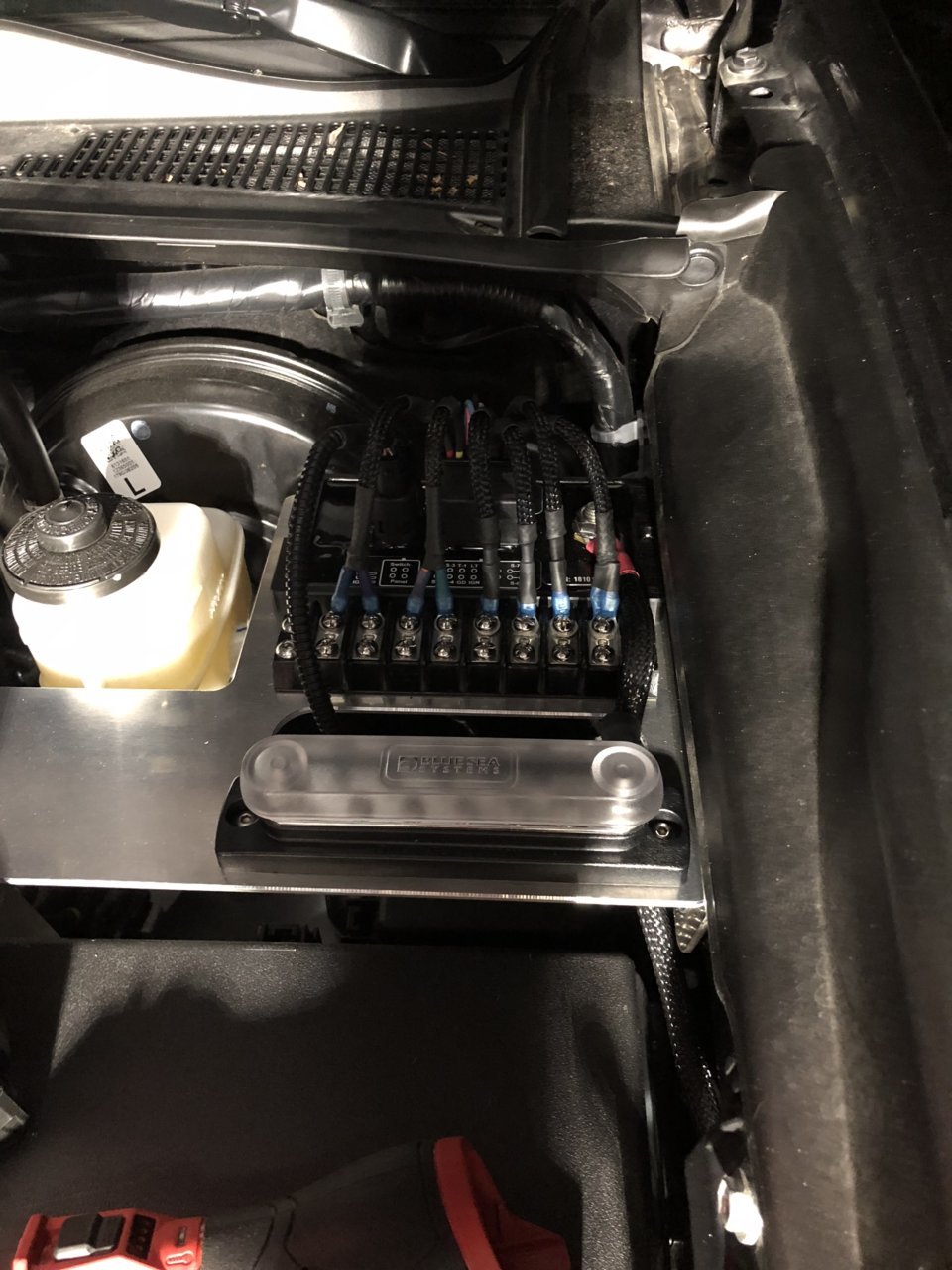

    PNUT Snake is just sneak spelled sideways
    Oct 18, 2015
    #166976
    431
    North Bay
    2016 Tacoma DCSB TRD OR 4X4
    Ray 10s Prinsu Switch Pro
    Finally wired up:
    ceedless, Toynado, Parker315 and 2 others like this.

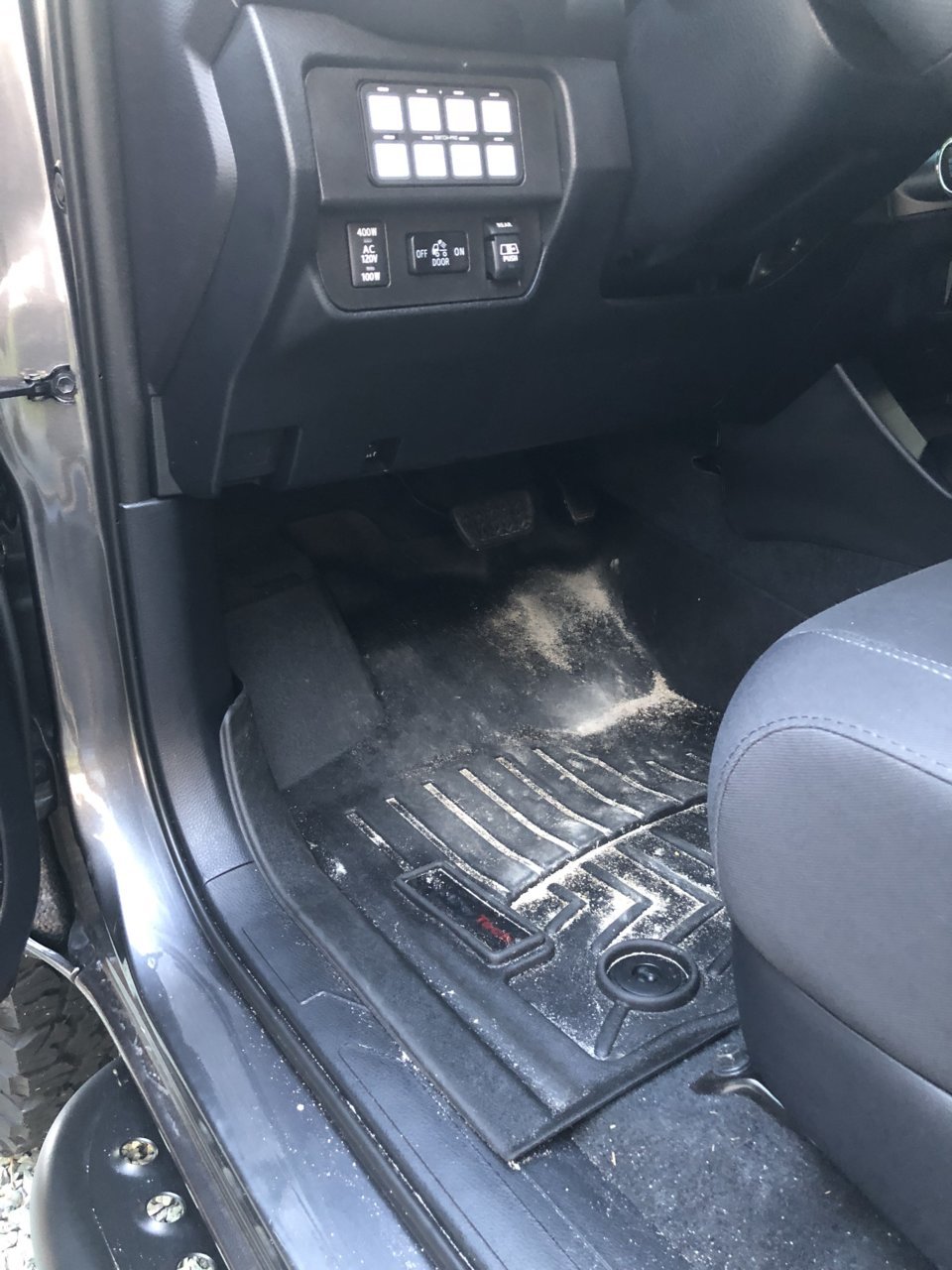

    ltaco 17
    ltaco 17 Well-Known Member
    Feb 19, 2018
    #244983
    113
    17 mgm longbed trd
    King 2.5 w adjusters, icon rxt leaf pack, icon billet delta joints, quarter tilt manufacturing cab mount relocation, Archive Garage Hammer Hangers,Rago shock guards, TRD aluminum skid, RCI aluminum mid,transmission and gas tank skids,Firestone ride right airbags with daystar cradles,Scs Ray 10,285/75/17 Nitto Ridge Grapplers ,Leitner Designs bed rack with 3 small pods and one large,2018 oem pro grill,TRD Pro taillights with MESO ultimate taillight kit, Demello Offroad flattop lightbar front bumper, cbi t3 rear bumper with single swing out, Baja designs xl80,30” s8, 2 sets of squadron sports, s2 scene lights, Meso full interior lights, group 31 Xtreme battery, LFD Offroad stainless battery tray, Arb single compressor, tandem Offroad winch solenoid relocation bracket, factor 55 fairlead and flatlink
    3E257F82-5978-49C0-BCE2-839F833460F0.jpg Almost finished
    shiftd, ceedless, Toynado and 4 others like this.
