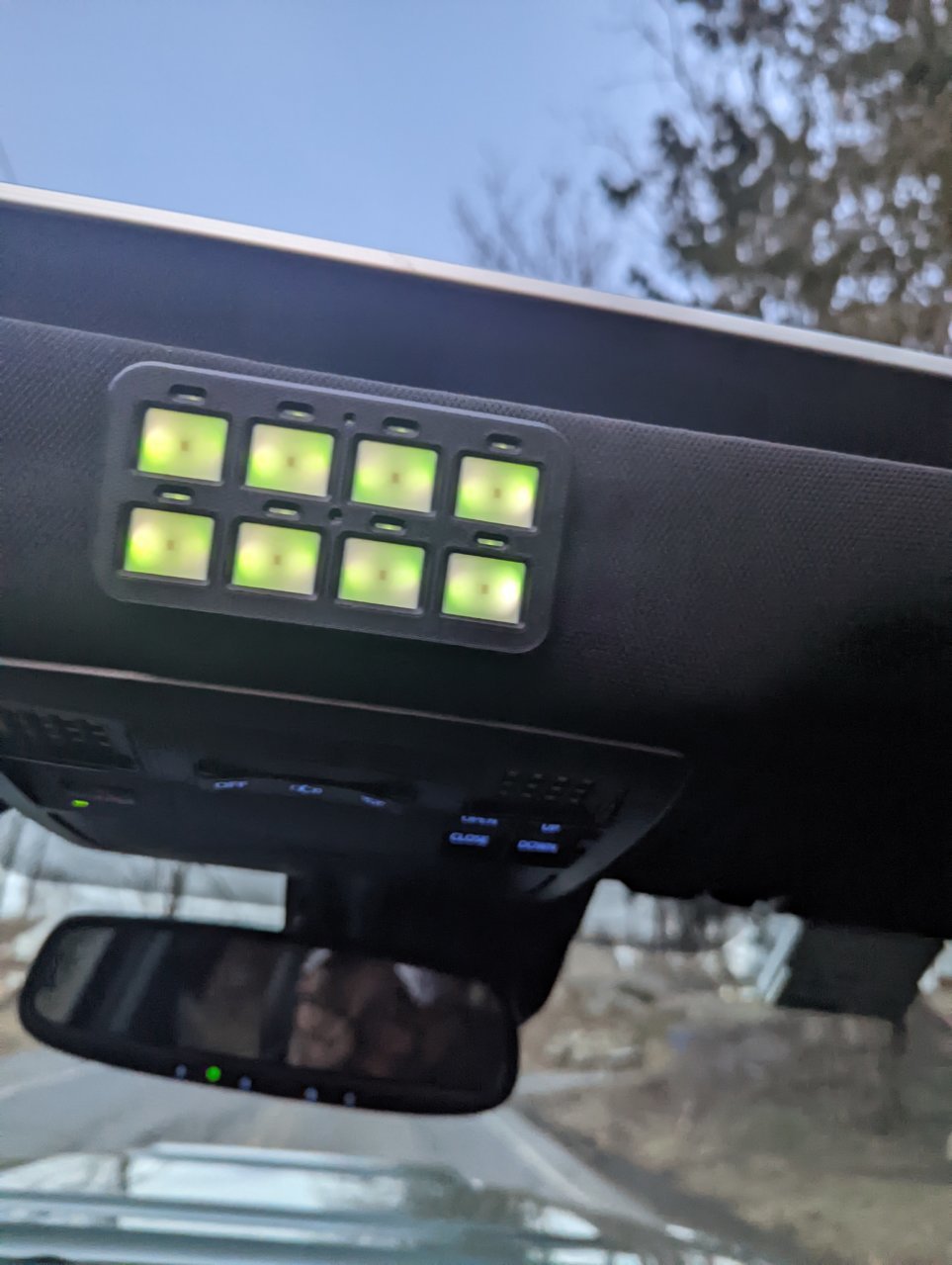

    I was just thinking I should expand the footprint of the overhead if can pull it off. I have a couple overhead panels I’ve been playing with, but not the time to finish my thoughts yet into a proto part.

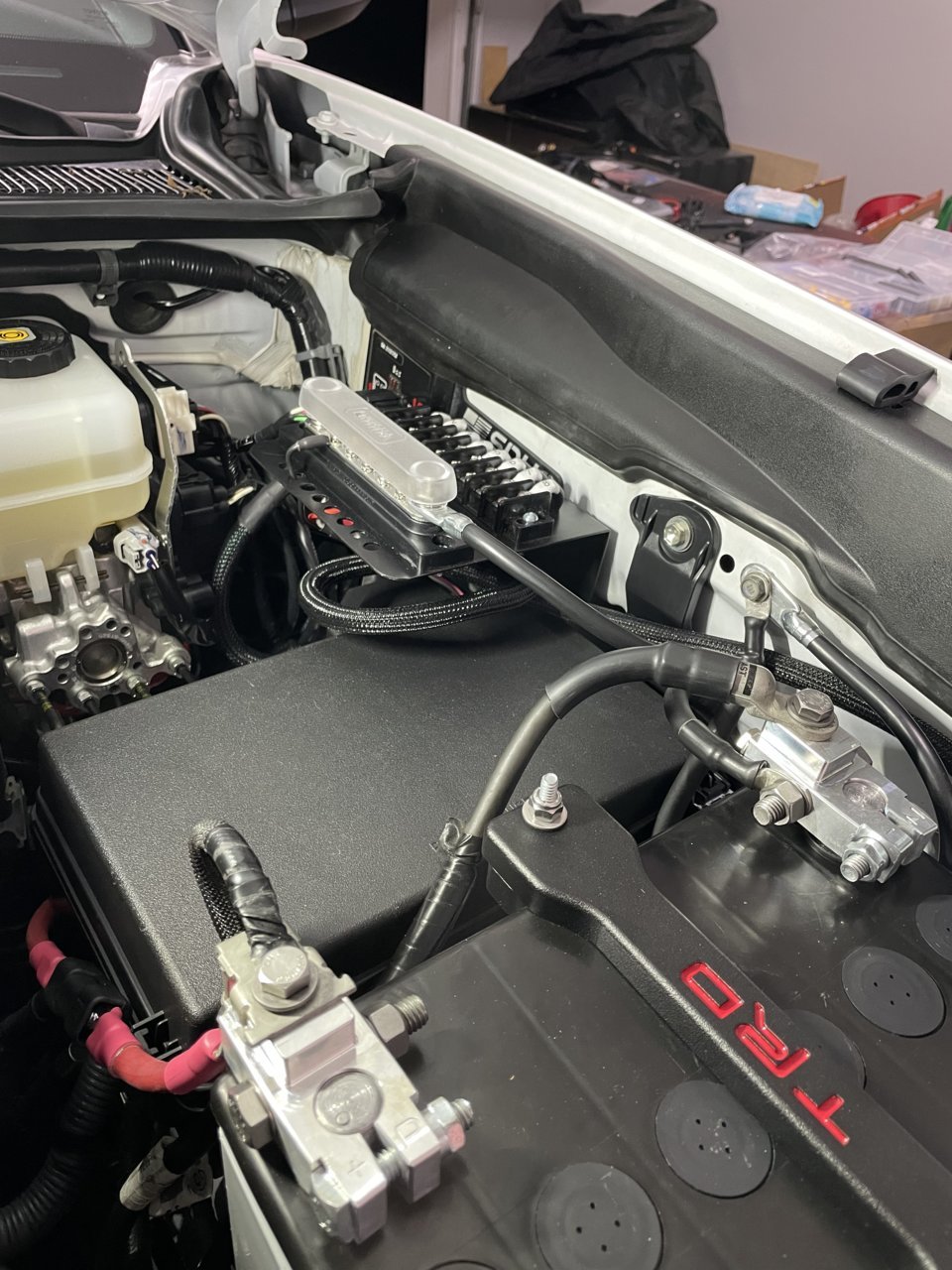

    Finished my install, mostly. Tried to loom everything and use waterproof shrink wrap where I could.
    Used the Switchpro mount/kit from @AY_ARONTRD and tapped the fuse box per @Shellshock instructions.
    Battery is a Duracell AGM, SDHQ terminals, and the TRD mount is from someone on here.
    2nd pic of of my BD S8 lightbar harness to motivate some of you to make your wiring cleaner

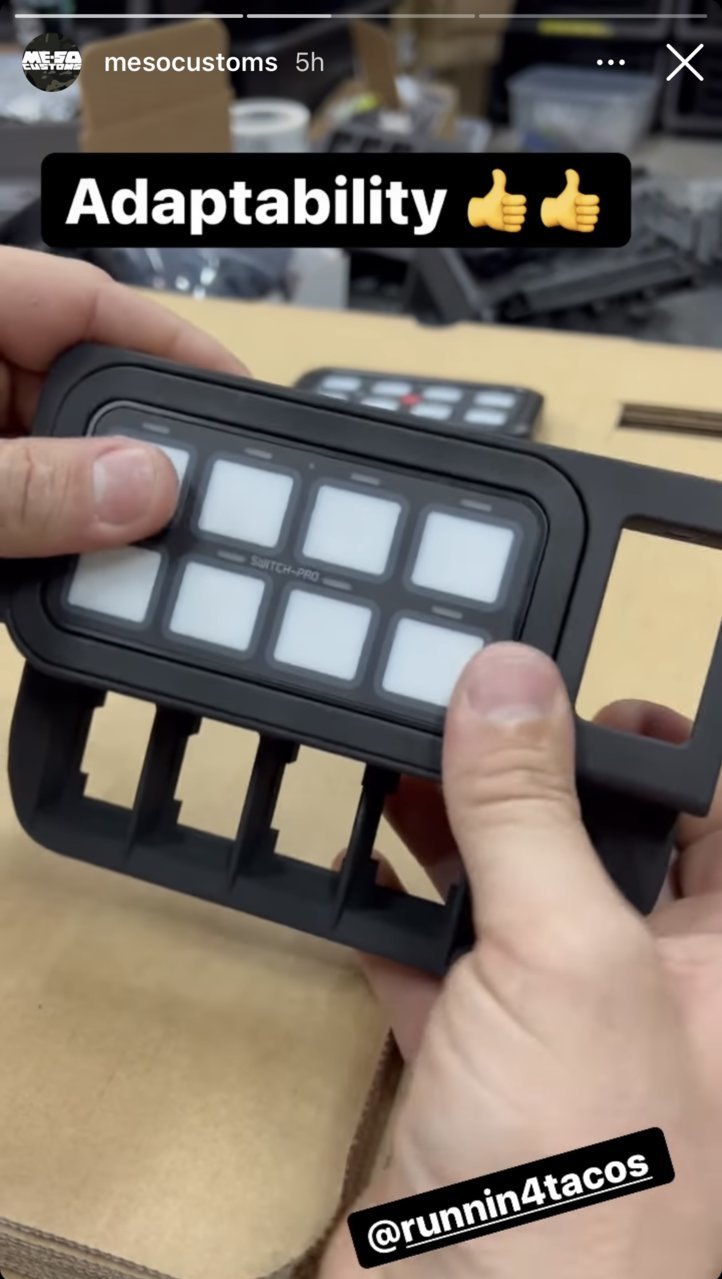

    MESO is actually working on a switch panel that will accommodate both.

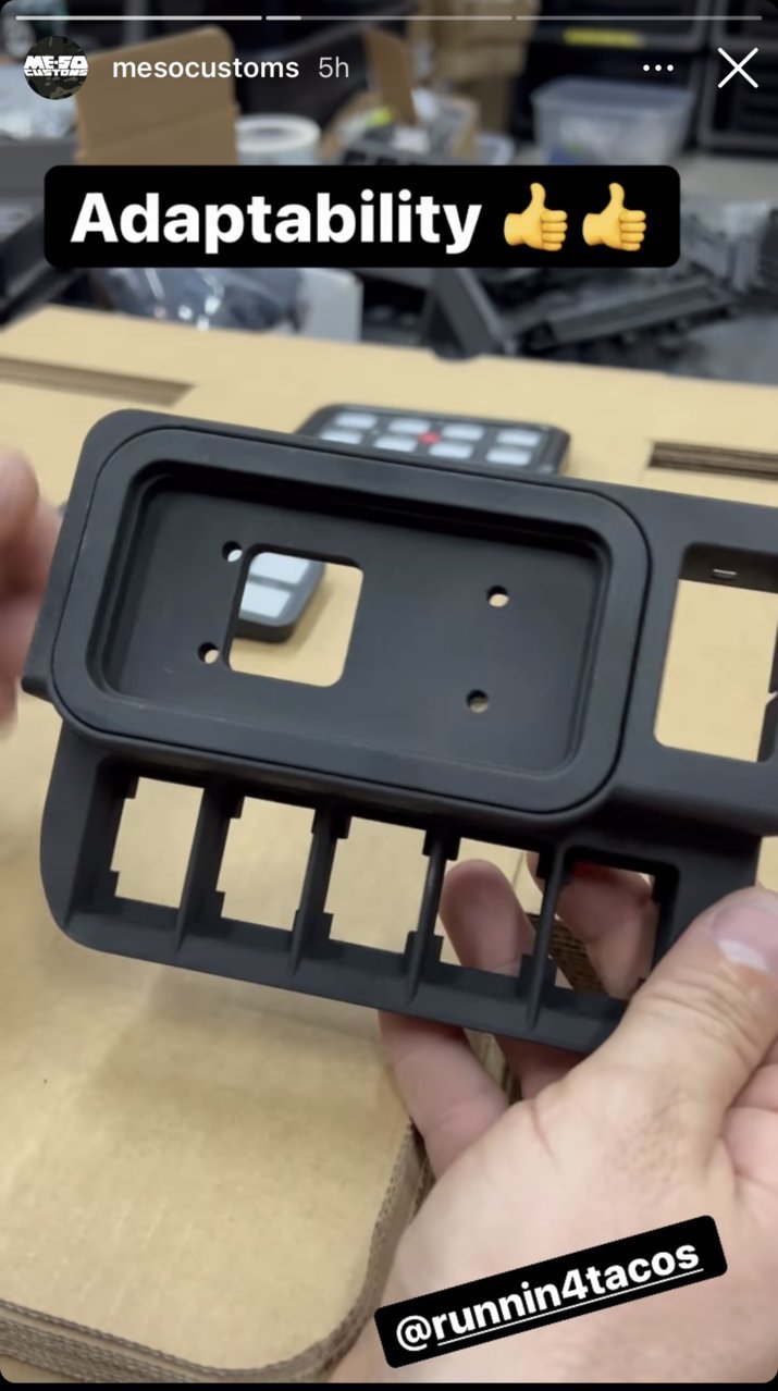

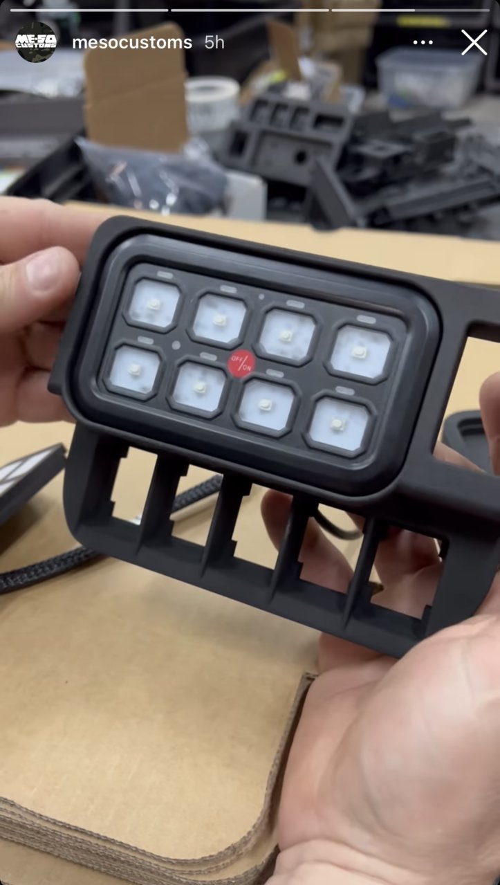

    Hi Guys, Runnin4Tacos seems to have commissioned MESO to make a version of our modular switch panels for 3rd gens. If you don’t want to wait or have custom needs check out all the many other versions we have in stock today that can ship as soon as Monday. Ours all fit the Auxbeam standard 8 gang controller and then can use inserts to run a switch pro or other switch combinations. Check us out at Guildoutfitters.com we started our business to try and improve the out-of-stock and lead time so many aftermarket products have. If you have any questions on our panels reach out here or in chat on our website. Thanks, Shaun
    BOMBS, daveeasa and poroto like this.
  13. Mar 5, 2022 at 3:51 PM
    #1633
    MESO
    MESO Major Modder Vendor
    Feb 16, 2015
    #148809
    16,292
    State of Jefferson
    2016 DCLB TRD HELLCAT SWAP
    Tuan (R4T) is a dealer and good buddy of mine. We have worked on many projects together, this included. Expanding on the already popular (and original) MESO Tacoma panel..this will take it a step further. Featuring injection molded quality(OEM), 5 regular switches + OEM cab light rocker + SP9100 or Auxbeam. To my knowledge this many switch holes does not exist on the market. Having them molded will keep up with demand all while keeping the price point about half of any other offerings. I came up with the insert idea a while ago, long before I saw this thread with yours. I guess great minds think a like and Imitation is the greatest form of flattery ;)

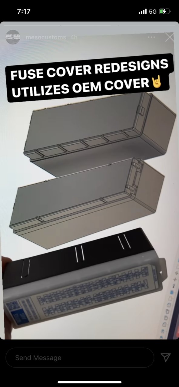

    I hear you on supply and demand. If someone wants something they are going to purchase whatever part is available and in stock. However, the old saying might be true: good things are worth the wait:)
    On the fuse cover. It doesn’t bother me, many people have copied my parts. That’s just the way it is. But all that I want is for them to be innovative. Make it BETTER, not just a blatant copy. This is good for the consumer and healthy competition. I keep in contact with the Etsy seller (@4runner.tx on IG) He had a great idea about utilizing the OEM fuse Cover. But again, improve and innovate. Case in point; spare interior fuses and puller which haven’t been done to my knowledge.
    We can go all day about how design X is similar to design Y, etc etc. At the end of the day sometimes there’s only be 1 way to skin a cat. The only difference is the knife we use :D

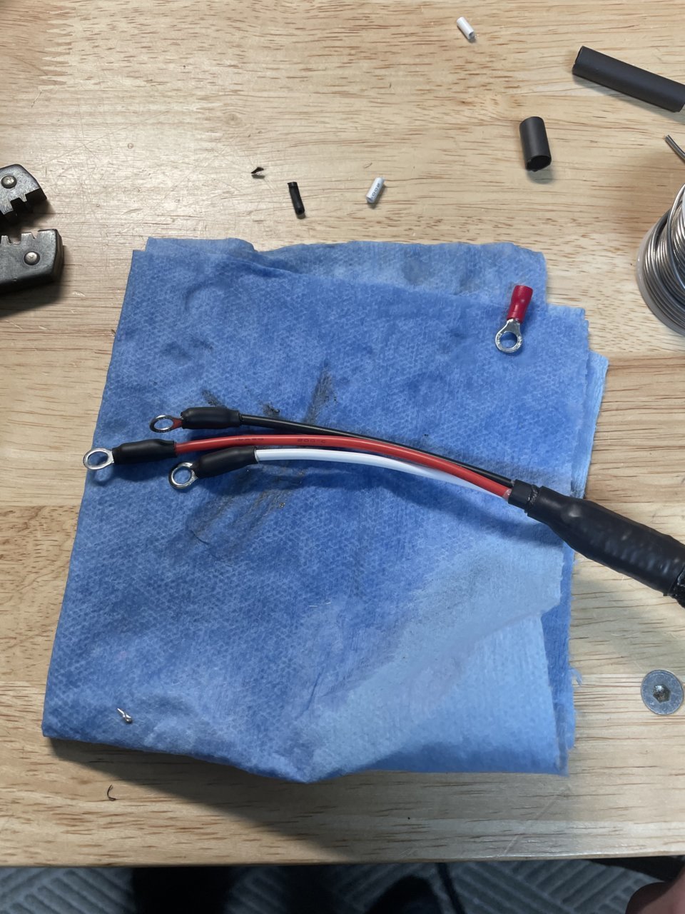

    I installed the "Diode Dynamics Stage Series Reverse Light Kit (2016-2022) SSC1 / SPORT" on my 3rd gen...had just installed the Switch Pros 9100 and didn't want to use 2 switches for one set of lights...I settled for 1 switch and 1 trigger...I am really happy with the outcome...here is how I did it...
    I brought the harness into my basement and tested the lights. I was confused at first by the relay...could not figure out how the relay was working the 2 different lights (red backlight and white reverse light). Part of the harness was hidden by loom and shrink tape. I emailed the company and they said they would pass it on to the engineers...but...I couldn't wait...lol...so I kept testing. I saw on my meter that the red backlight was such a low draw...and that's when I realized that they were run directly off the factory lights.
    So, I cut the switch and relay off the Diode Dynamics harness, used their trigger wire that originally went to their relay as a trigger for the Switch Pro.
    So now :
    -when I start the Truck and turn the lights on, the red backlights are lit up
    -when I put it in reverse the Diode Dynamics white lights LIGHT UP the night behind me (due to trigger wire from DD harness wired into the Switch Pros
    -when I pres the Switch Pros switch, the Diode Dynamics white lights LIGHT UP the night behind me.
    I did use up 1 Switch Pros trigger for this install. But it was worth it.
