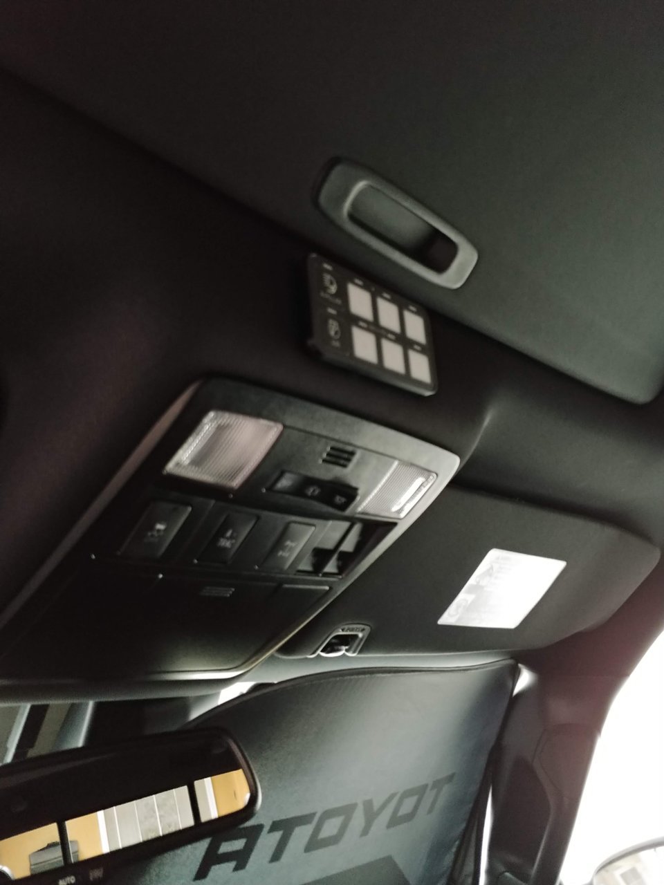

    I just used the template and drilled holes, there's a piece of metal right where the studs go through the headliner so it wasn't as easy as poking holes through some fabric and cardboard. Its still pretty easy though, took me longer to route the wiring.

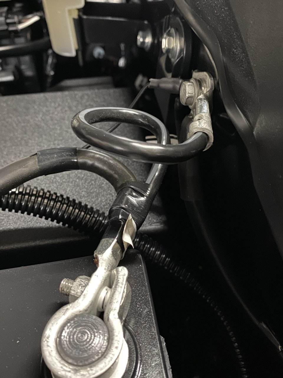

    Fender ground bolt??

    Not my picture but this pigtail thing off the main ground cable that bolts to the inner fender.

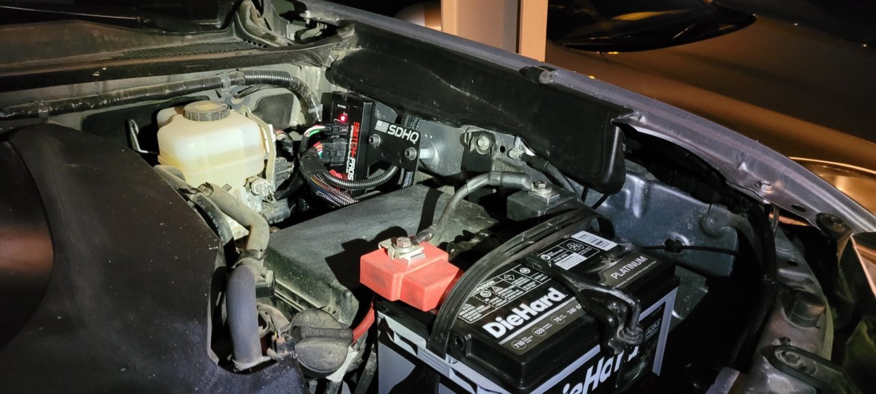

    No ditch lights, but I have two Diode Dynamics light bars behind my grille, 2 Diode Dynamics 2” amber pods on L/R of Prinsu rack, and a Dunarri-Pierce chase light on the rack as well. It’s relatively simple to organize and conceal the wiring. I have a pretty lengthy technical background in telecom and fire alarm installation, so I kinda have all the wiring organization tricks of the trade at my disposal.
    My advice would just be to use wire loom and shrink wrap in every possible place to keep things looking OEM. Use plenty of zip ties and buy yourself some flushcuts to snip off the zip tie ends(neglecting to use flushcuts leaves very sharp edges on zip tie ends that can literally rip/gash into your arms or hands/knuckles). Use QUALITY 3M electrical tape. Use waterproof shrinkwrap/solder butt connectors. Use shrinkwrap over ALL of your wire junctions and terminations. Run ancilliary wiring along with existing wire harnesses when possible. Pay close attention to any sharp edges that could potentially cut into your wiring and ensure your wiring is secured away from them or protected with split plastic loom. Consider a bus bar for your grounds or perhaps aftermarket battery terminals like the ones from SDHQ(as seen in my photo), each of which have 3 dedicated tiedown points separate from your mains for power and ground connections.
    You could also install a terminal block for your harness connections. Personally, I won’t use one for this application. A terminal block makes things easier, but it also introduces a break in each circuit and since most terminal blocks are not watertight, it increases the chance for corroded terminals and opens/shorts. I prefer each of the wires in my circuit to be fully intact from harness to harness. Fully intact = maximum reliability
