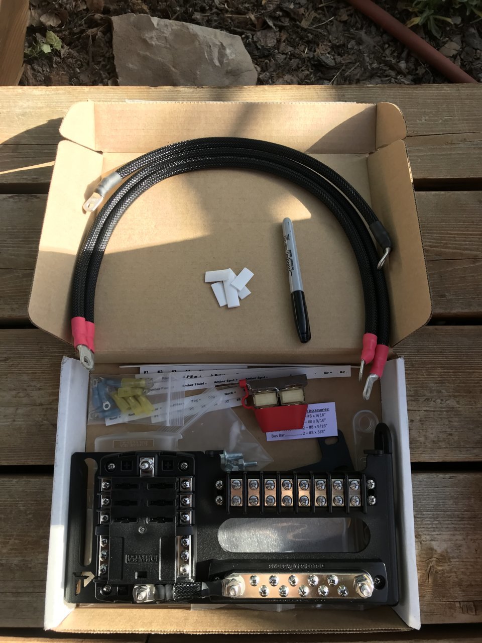

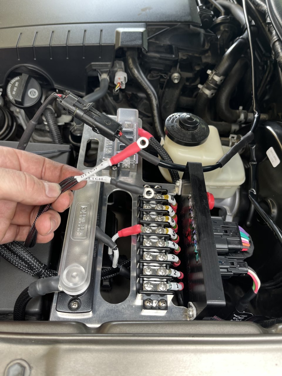

    Thanks but not sure, the entire assembly came prewired from blaze offroad and he probably prints them himself. How you see it in the first two pics is exactly how it ships from him, ready to drop in.

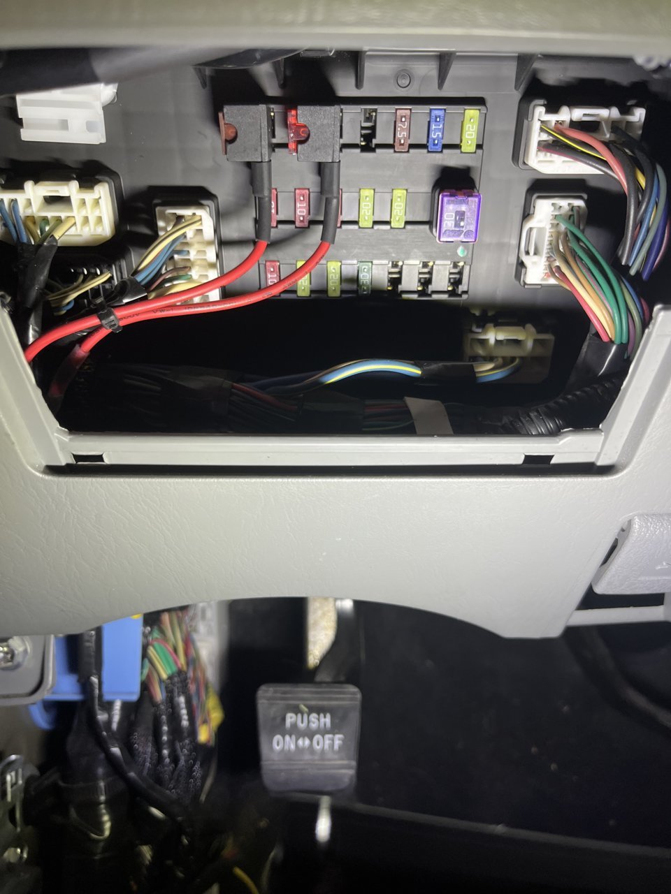

    Does anyone have any suggestions or information for the 2nd Gen trucks trigger wires? Am I able to run ignition and backlight out of the fuse box? Thanks

    I believe 2nd Gen sidemarker is a match to 3rd sidemarker. So a T harness for that is easy.

    That’s what I did on my brothers truck

    Do you happen to temper which fuses you used? I’m assuming EFI for power and a headlamp for low

    For reference on my 2nd Gen I was able to get ignition, and backlight in the fuse box behind the small hidey door.

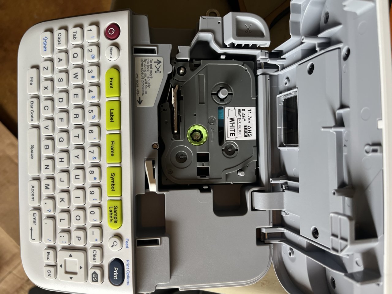

    I actually just picked one up. Works great. Brother PTD 400 printer and Amazon shrink tube cartridges. 8mm worked on 14-16ga fittings 11mm works on 10-12ga.

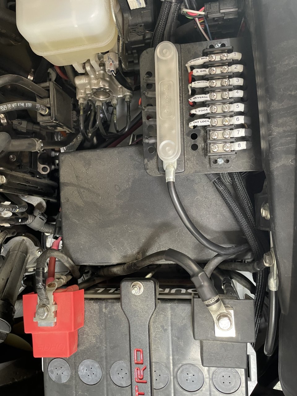

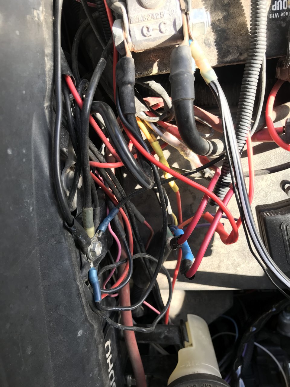

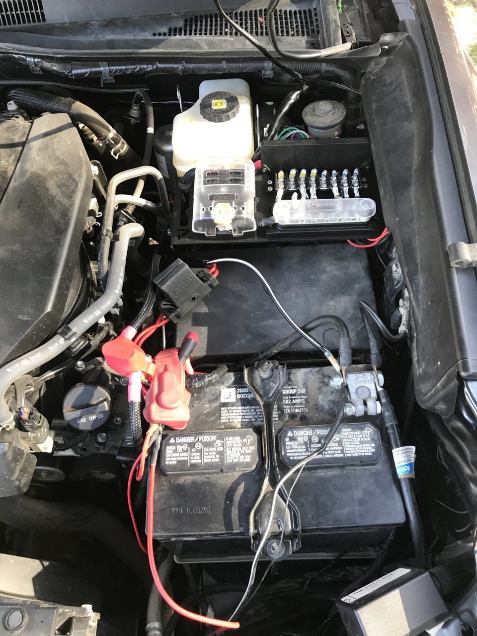

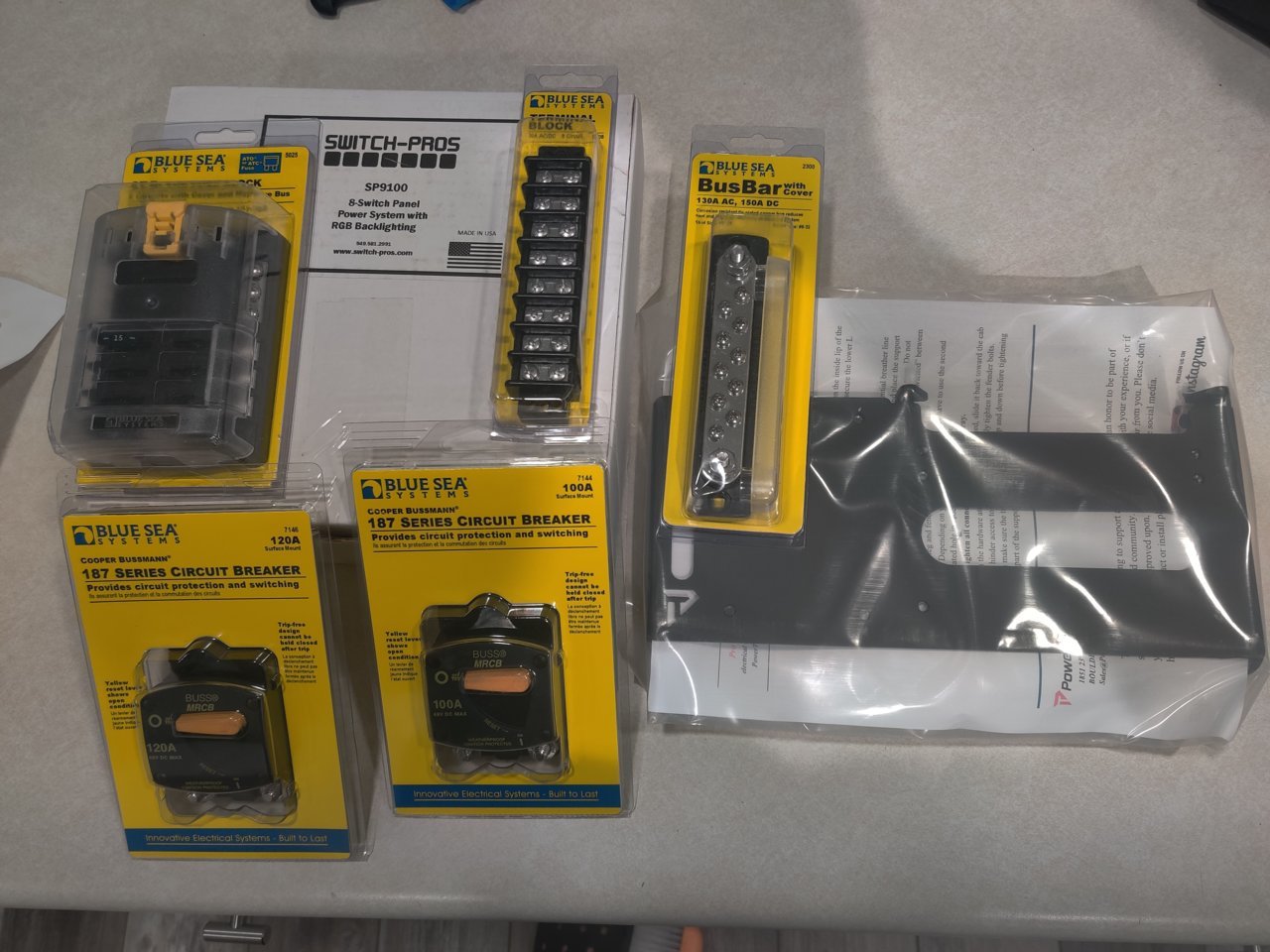

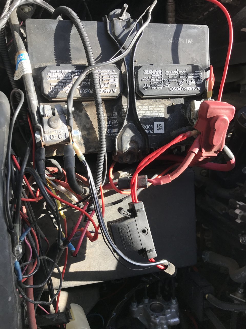

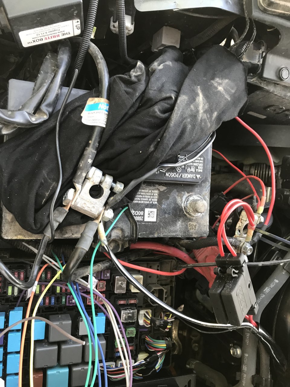

    I just re-did the entire electrical accessories in my truck, using the power tray system along with all of the blue sea goodies. Took me around 10 hours taking my time.
    A big shout out to @panicmonster for helping me get custom heat shrink labels for this project, as he mailed them to me with only charging postage, what a guy! He also included extras, which I ended up using in case of a mistake which did happen. Without the extra labels, I wouldn't have them labeled appropriately. Thank you so much man.
    Here are some before photos:
    Wiring birds nest

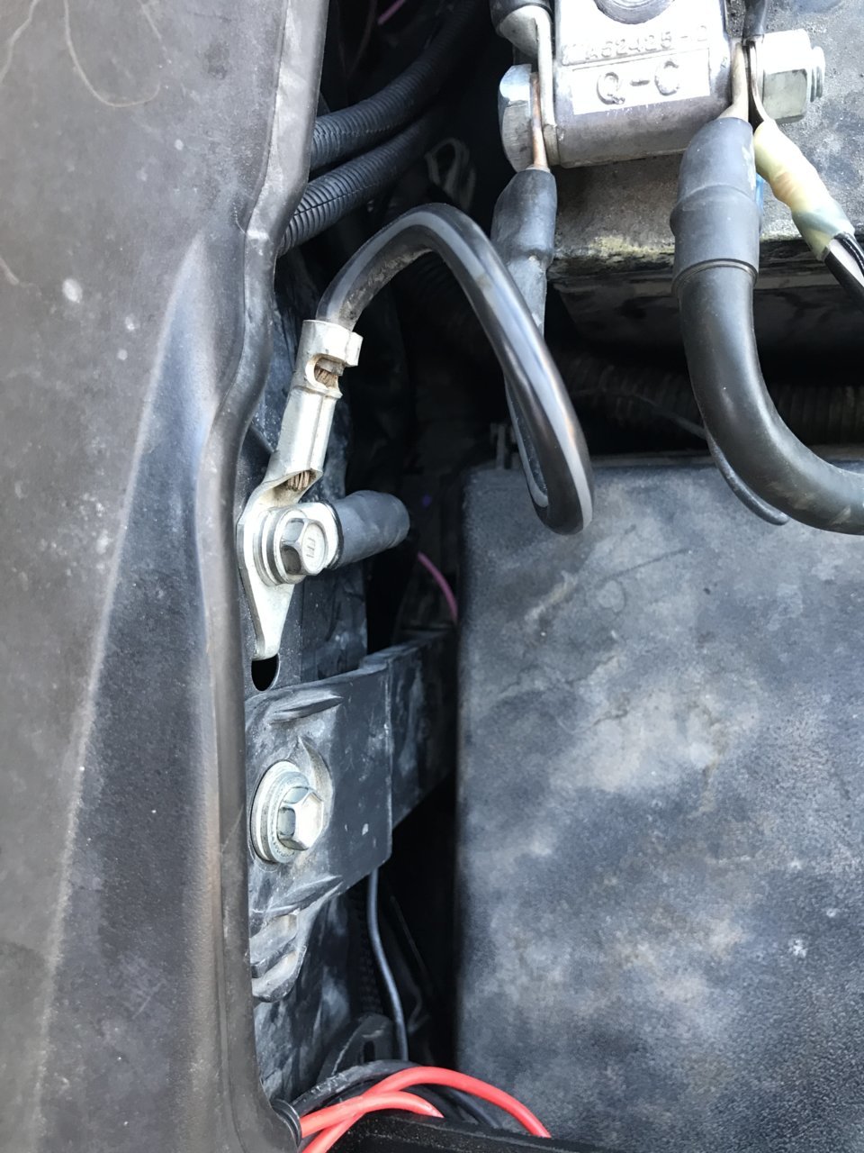

    Showing the ground mess
    How everything was mounted previously, SDHQ bracket

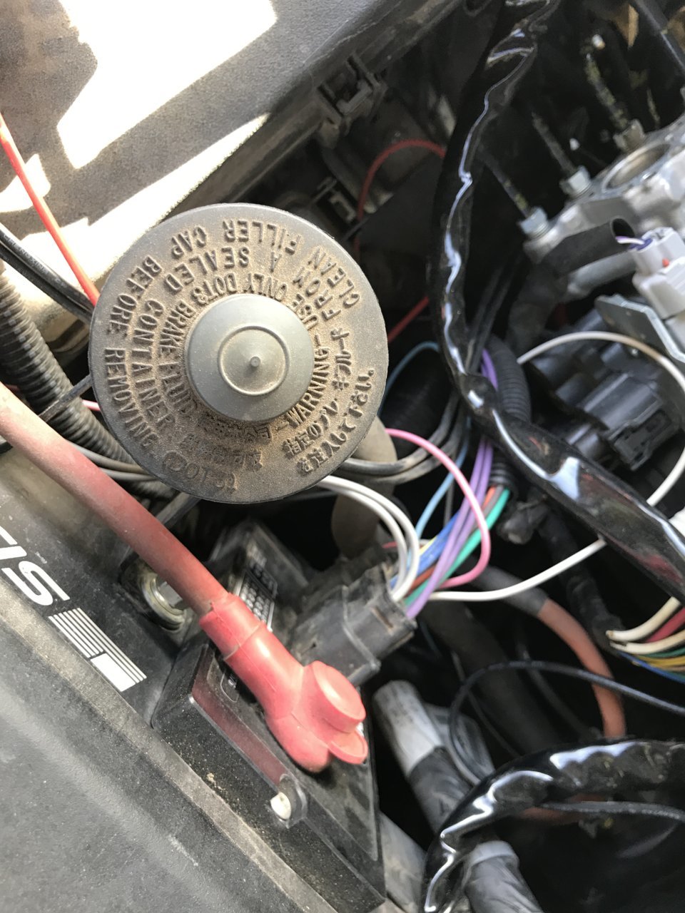

    Taking everything apart
    The new hardware laid out to admire

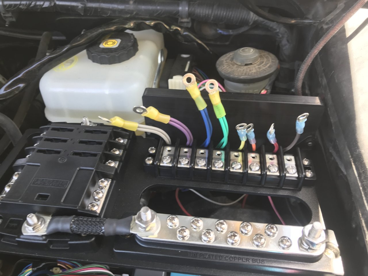

    Another during installation photo of the ring terminals

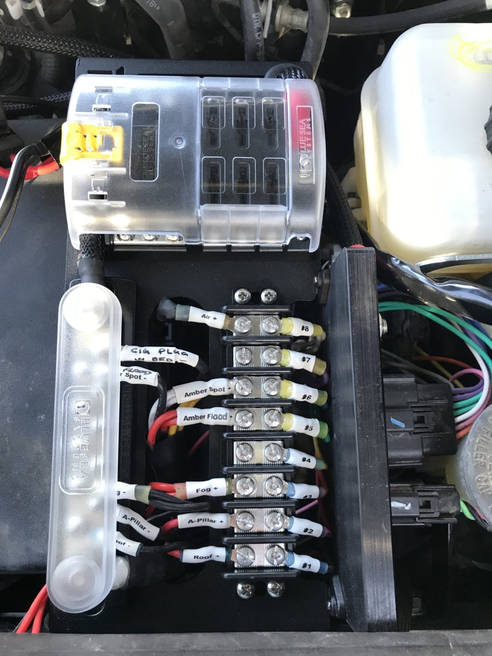

    Last few photos are of the completed project
    Nice and organized and labeled switches/wires
    Overview of the wiring clean up. (I still have to move a few accessories over to the fuse block instead of having them on the battery)(@panicmonster I may request some additional heat shrink labels and Im more than happy to pay!)
    Showing the clean ground, only the battery and other ground cable for the blue sea accessories

    I'm so happy these labels worked out well for you guys. I'm glad I could help out. Installs look great. Congrats!
    For anyone else who is interested in their own setup, I have a similar model to that which @Jared8907 mentioned above, a Brother P-touch PT-D600 with the generic Amazon heat shrink tubing labels. For @microsnook & @aturk, I printed directly from the computer software (nice because it saves typing all the labels out on the little keypad). The 11.7 mm works well because it slides over the pre-crimped ring terminals. If you're installing the labels at the time you're putting it all together--i.e. before crimping your terminals--the 8.8 mm tubing works best.
