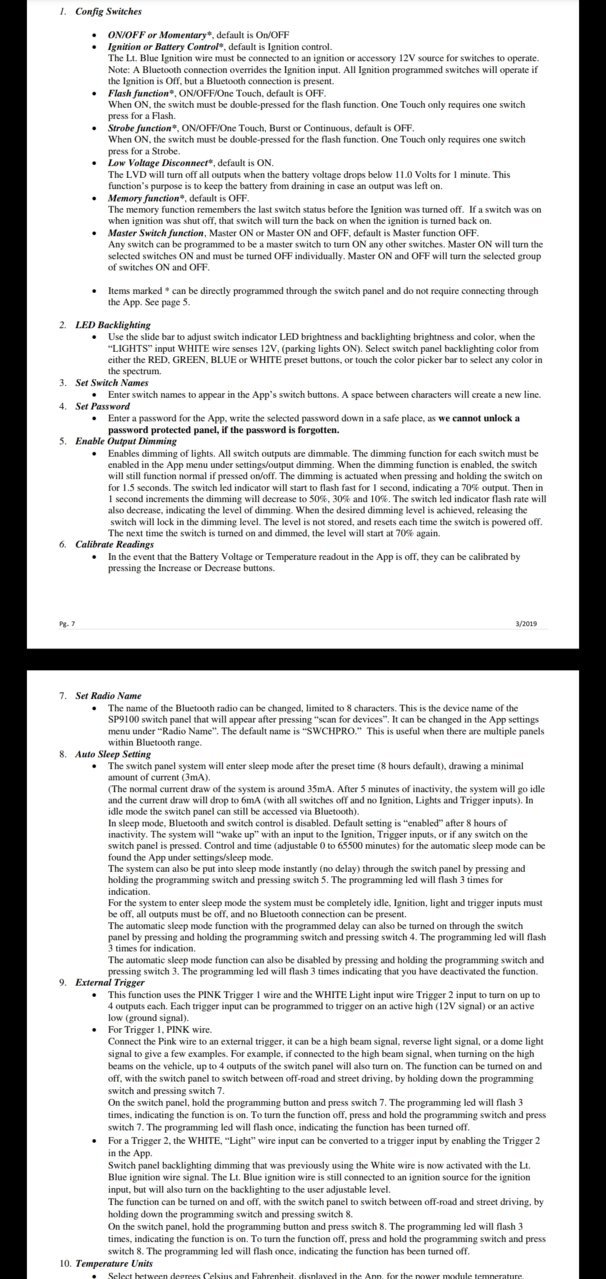

    I could not find specific instructions about password reset solutions on this string so here we go. My install went perfectly and everything is working as it should on the Switch-Pros as far as on/off operation of buttons and accessories. I went to use the app on my iPhone and got into issues where it wouldn't recognize the password I had just set minutes earlier. After an hour or two of Googling I still found nothing that worked. Emailed Switch-Pros late Sunday night, got an email back at 7:56am Monday morning to call them so they could talk me through the procedure live, talked to someone right away, and the procedure is straightforward (and would be nice to have in the manual). The SP-9100 password reset procedure is:
    1) Get a buddy.
    2) Unplug 4-pin connector in engine bay at power module.
    3) Buddy holds down the 3 lower left switches all at the same time. This is switches 2, 4 and 6 in the diagram.
    4) Buddy continues to hold the switches down while you reconnect the 4-pin connector in engine bay at power module.
    5) Use a clock to hold down the buttons for 30 seconds after the reconnect. There will not be any lights or beeps to say it's reset... but this will reset the module so it has no password.
    6) Let go of buttons. Breathe sigh of relief.
    Then, be very careful to watch every keystroke when setting a password and that autofill doesn't do something weird. Hope this helps.

    Flip to programming step #13. You can program delay shut-off by up to 5hrs.

    On page 8 of the SP-9100 manual the Auto Sleep Setting explains how you can still do Bluetooth stuff for up to 8 hrs after the vehicle is shut off before the system actually goes to sleep. If the 8 hour time limit is going to be any issue, then camper lights like that would be better off being wired separately from the Switch Pros. If you only want them on/off from the camper anyway, the Switch Pros keypad in the cab of the truck could sort of be a waste of a button. I have an interior light in my canopy and wired it separately on a pushbutton for similar reasons.

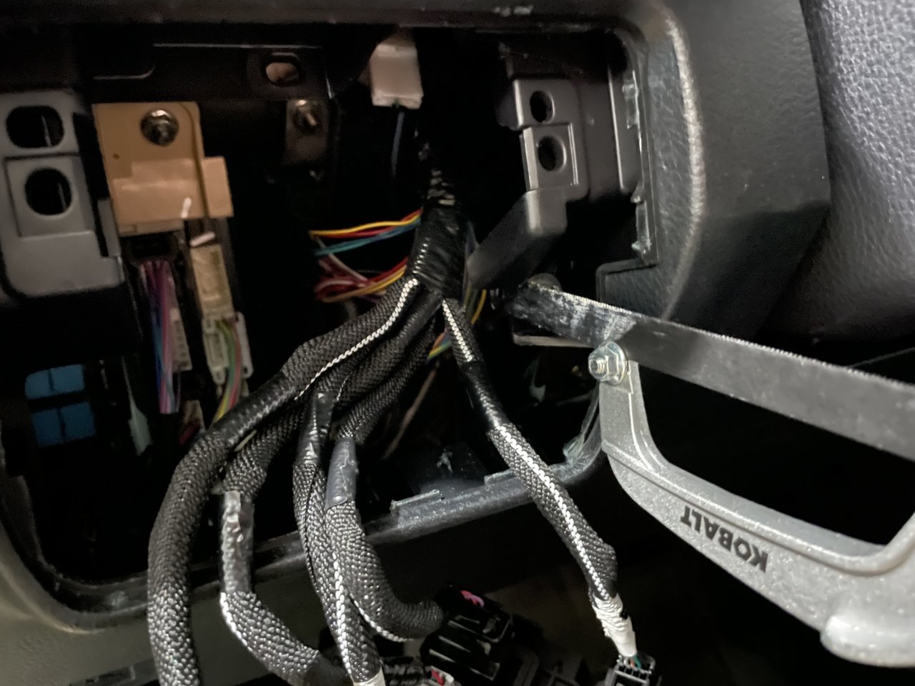

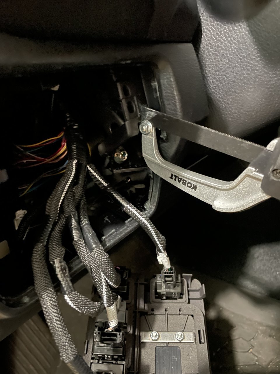

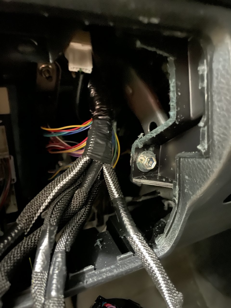

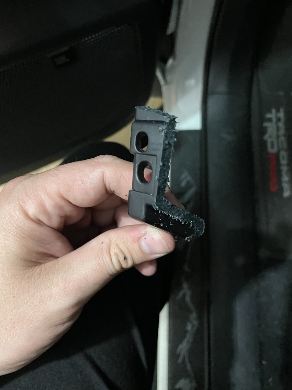

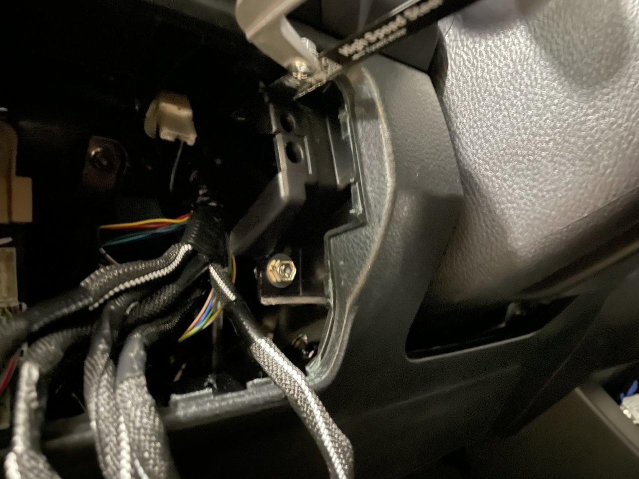

    I apologize if this is already known, but wanted to share with the community. Was installing the Meso panel in my 22 Pro and there's some tabs behind the OEM panel that were in the way of the upper right switch spot. I had to Dremel some of it away to get the Meso panel to click in.

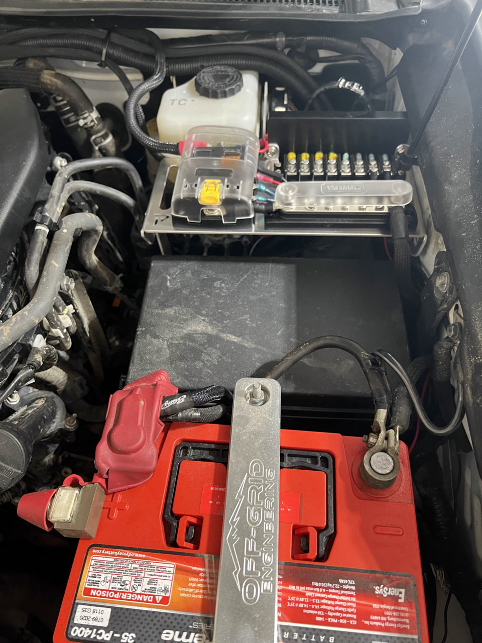

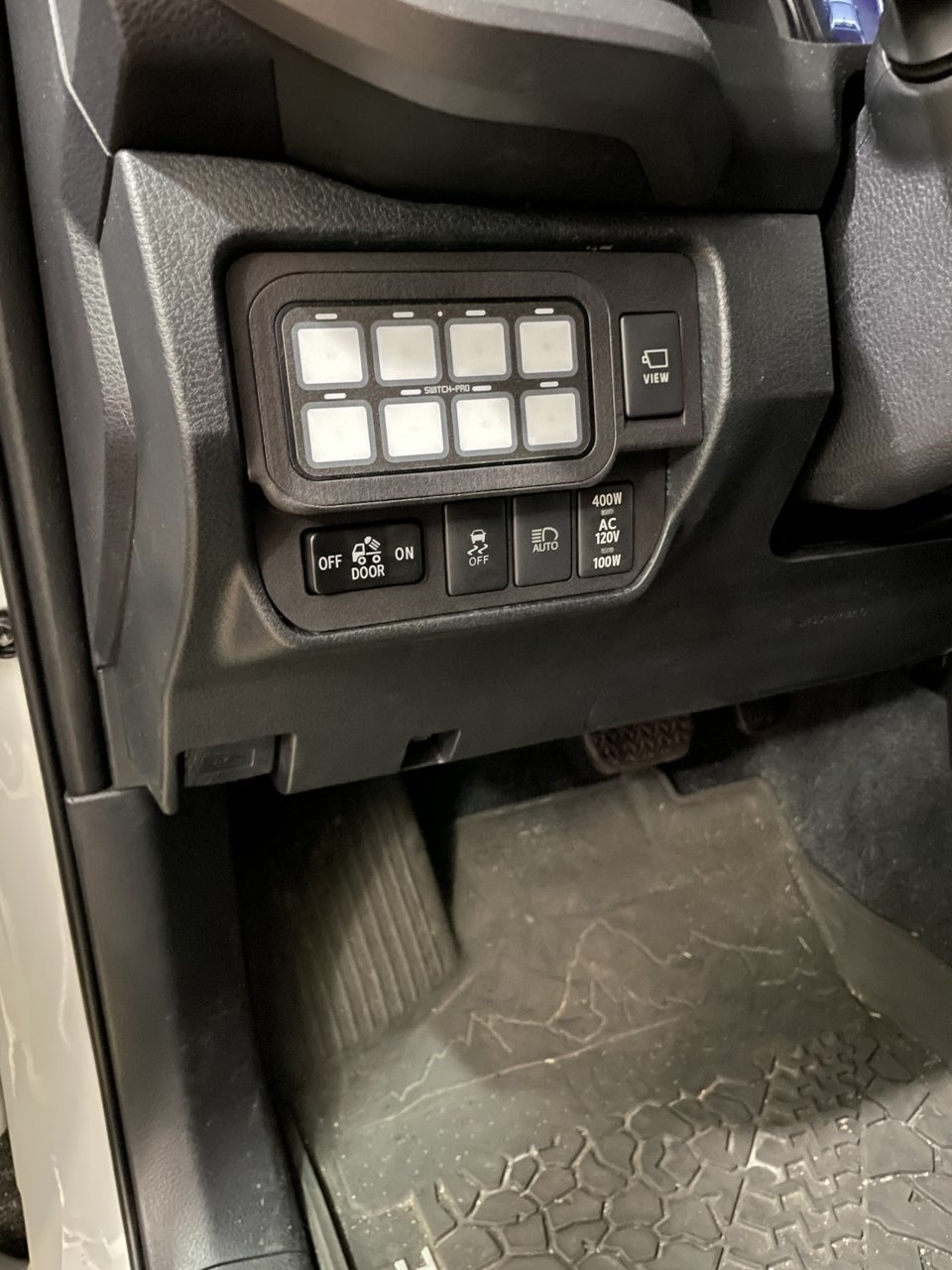

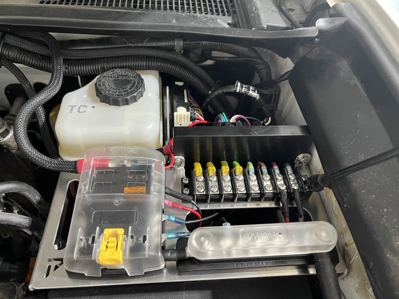

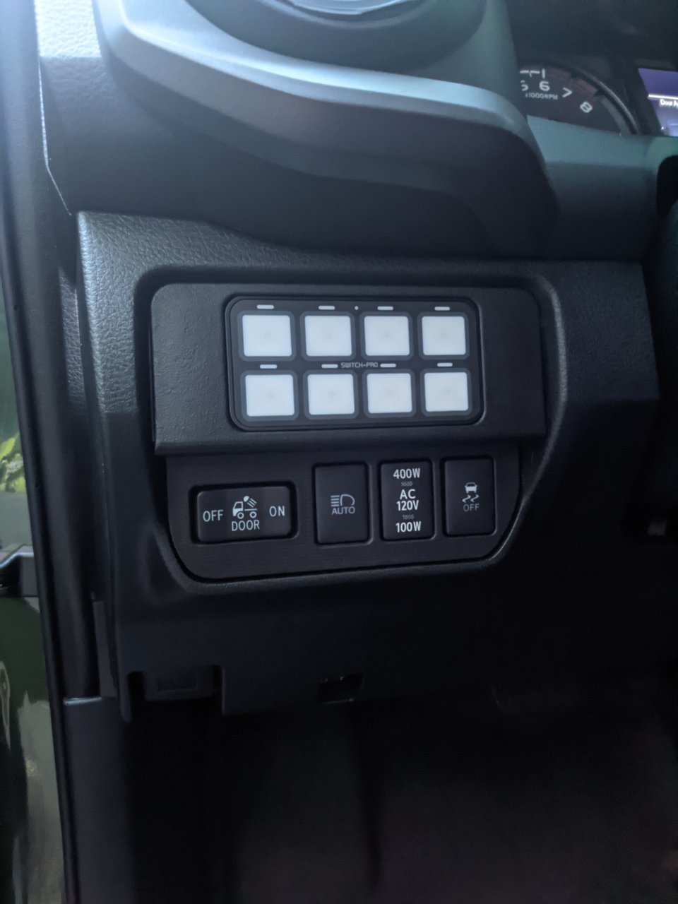

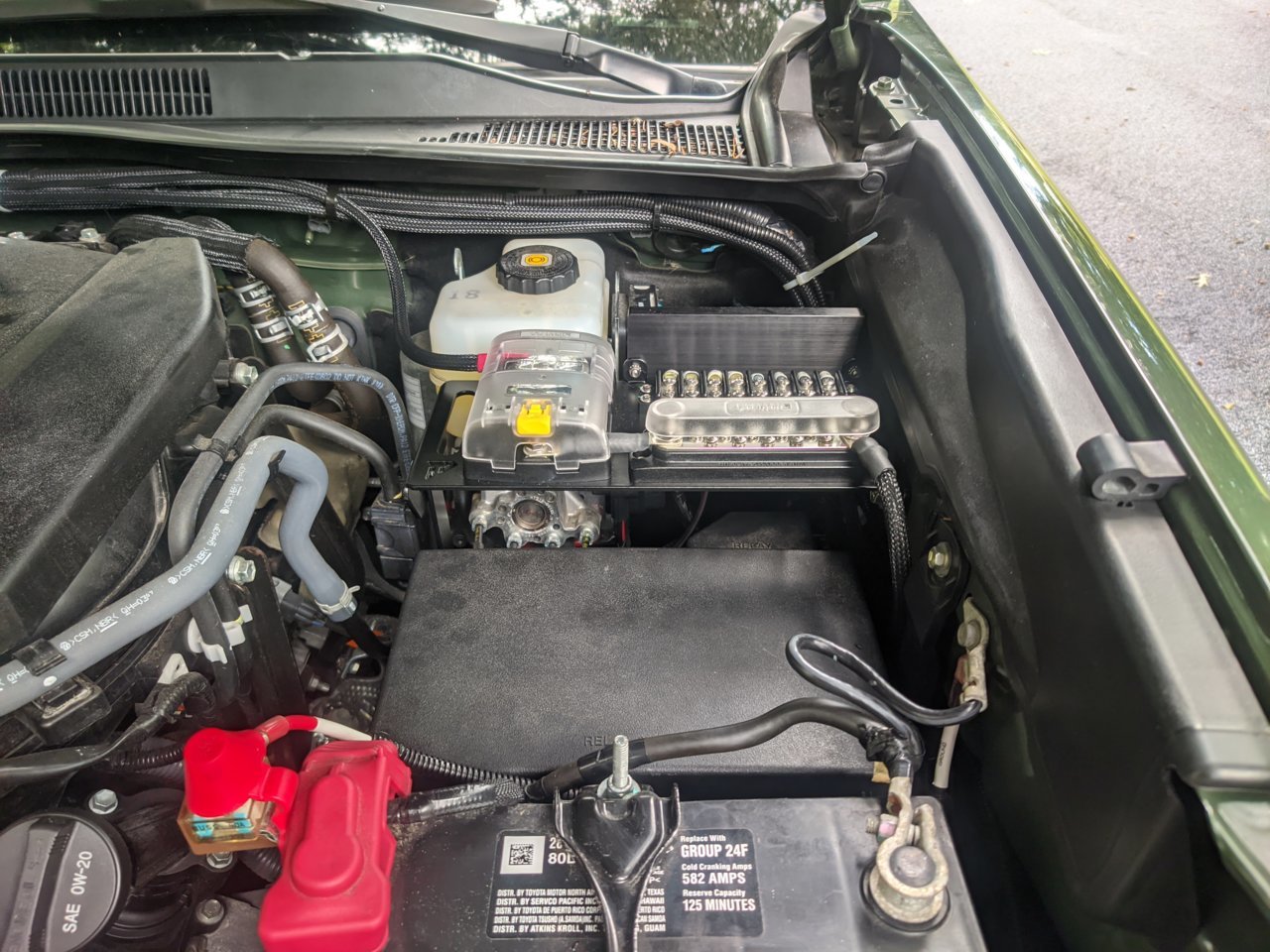

    Spent some time yesterday and today to get my setup installed. I have had everything ready to go for a while now but took my time getting it installed. No accessories connected yet, those will come soon.
    Thanks to everyone in this thread and on the forums. Read through this thread and others before getting started.
    The switch panel installed in the dash with a Meso custom panel.
    The power module installed under the hood on a Power Trays mount with Blue Sea terminal block, fuse block, and bus bar.
    The setup is run to my aux battery on the passenger side in an Off Grid Engineering battery bracket.
    solscooter likes this.

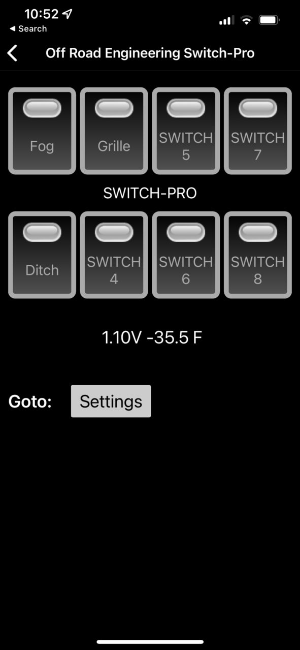

    Ran into a weird new issue and not sure if anyone else has had this happen
    things will occasionally turn on at random but buttons are usually in operable. Pulled up the app and seeing voltage and temperature reading are way off
    Disconnected devices / power / etc and made no diff. Have reseated connections, checked wiring and haven’t found anything that seems problematic. It has been installed a little over 2 years with no problems.
    Maybe the controller bit the dust? It’s the only thing I can think of. Gonna reach out to switch pros as well and see what they say.
