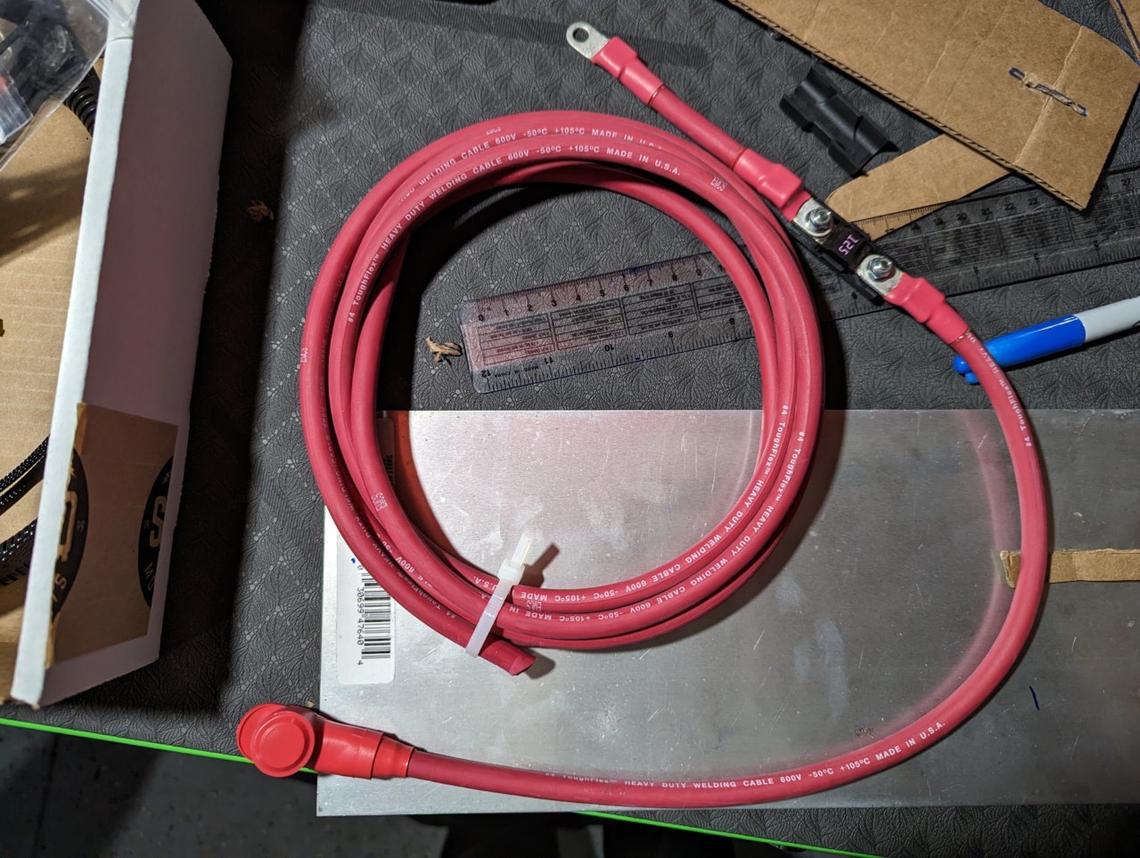

    Do you know what gauge that 6ft cable would be? Just out of curiosity..

    I have a 5' in a box, if you call them they will discuss with you, not like you have to buy :) They seem to only offer this via phone call from what I gathered. They charge quite the pretty penny for it, but it does look nice. I need to get it installed.
    I think they might go to 2 gauge for longer runs but it's at least 4 gauge from what I remember (which is pretty poor as it's been in said box on the shelf for a while now).

    Cool, thanks, I have some 4 gauge cable, an extra slot on my blue sea terminal fuse block, and a 125A fuse which should work great for this. I don't plan on running much amperage through the unit (2x e lockers, 2x cameras, and 1 or 2 small lights) so hopefully adding a few feet to the original setup will not have much of an effect.
    I actually have the exact same cable that Switch Pros uses so I may as well only replace the part that goes from the fuse to the battery and run 2x 125A fuses.

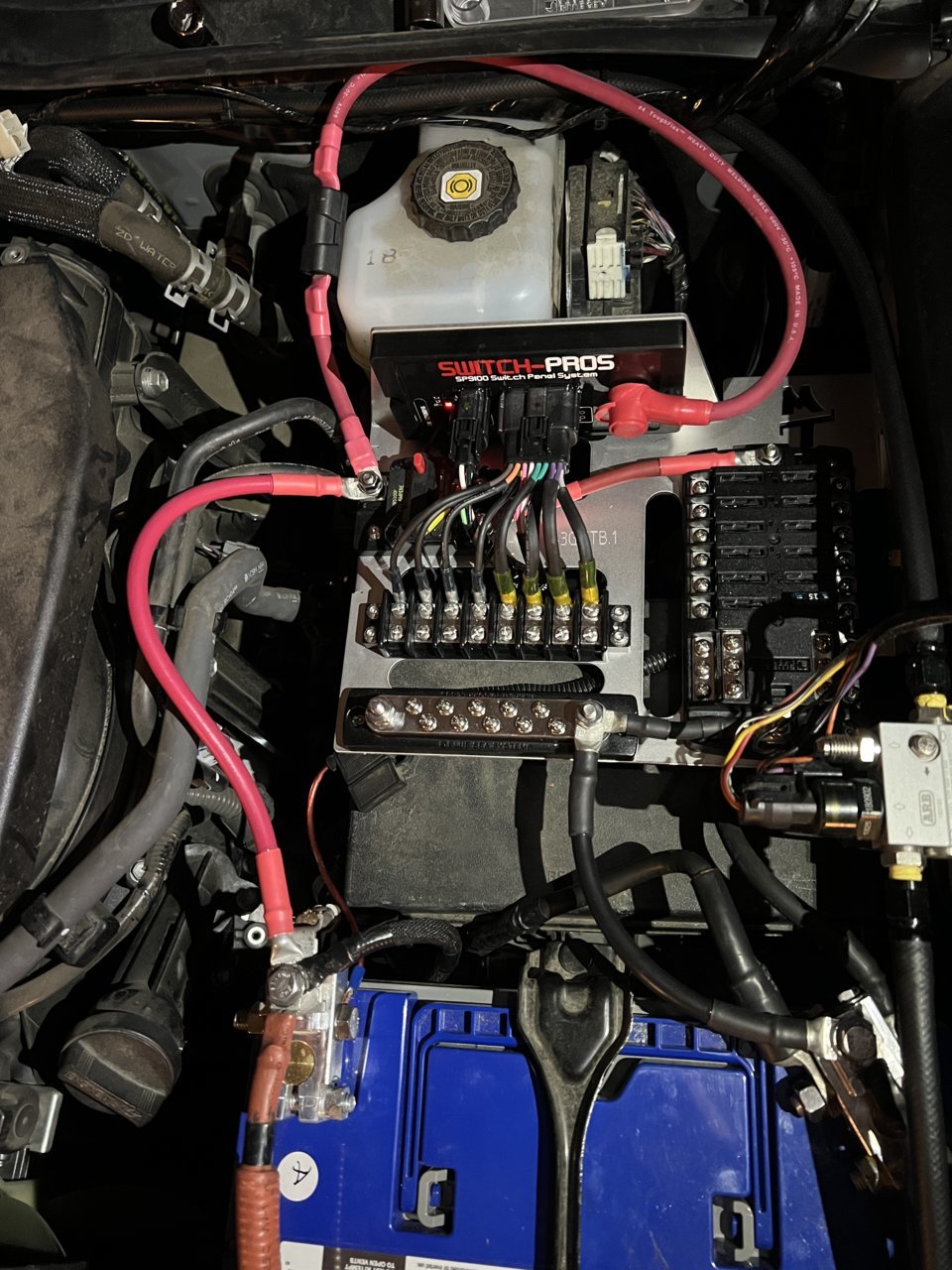

    Help... I cant find any straight answers.
    Installed my switch pros this week with the setup from Derek at SD Offroad MT. The setup was super smooth and painless, except for a washer. If you're on here somewhere, thanks for everything Derek.
    My question to you guys is...
    Is there a way to wire my compressor power through the fuse block?
    Can I run the compressor through the fuse block studs if I keep the compressor fuses between the compressor and stud of the fuse block? There's a 100a circuit breaker between the battery and the fuse block.
    What are you guys connecting your trigger wire to? I know it's a preference thing, but i can't think of any ideas of what I might use it for. All trigger ideas i can think of, all kind of fall between relaying switch pro connected items to work in junction.
    Last bit, I have the green wire from my S8 light bar that used to be add-a-fuse into my tail fuse. Is there anywhere under the hood I can tap that wire that would have the same effect as the tail fuse?
    PS The switch pro reed wire has been corrected to be wired properly.

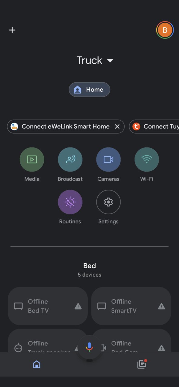

    Anyone have an idea of how to use another trigger mechanism in tandem with a switch pro 9100? I want to trigger a few low amp draw LED lights with the switch pro and the smart switch below. I don't want to damage the 9100 by hooking up an additional switching device. I want the Wi-Fi feature as my truck has a 4G mobile hotspot. Anyone use another method of switching in tandem with the 9100? Love to hear how you did it. Thanks so much!
    SONOFF 4CHProR3 Wi-Fi Smart Switch 4-Gang Din Rail Mounting Home Automation,Self-Locking/Interlock Control Home Appliances, RF/APP/Voice/LAN Control, Compatible with Alexa https://a.co/d/3ErtKys

    I want to add some exterior light bars using that smart wifi relay to Google home or in my case I should say truck.

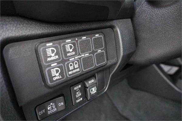

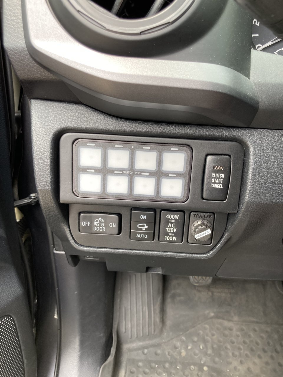

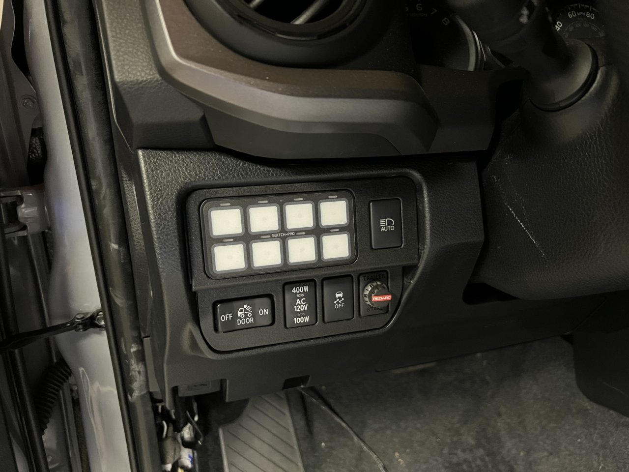

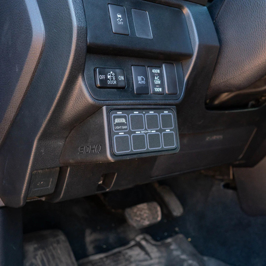

    Has anyone tried using the 16-19 SDHQ Panel mount in a 20+ Tacoma?
    The difference I am seeing is that the 16-19 doesn’t have a trac off button at the top like the 20+.
    Pictures for reference comparing the two mounts.
    The goal is to fit the switch pros unit directly to the console In a 23’ using the mount for a 16-19.

    You can relocate your auto headlights using an extension harness to the LSP (any open small spot, might have to file for OEM, MESO would be a straight push in but obviously some work to get the MESO LSP stuff done. Then stuff the nanny off switch in the auto headlight spot and go meso.
    Alternatively, meso's 3d print can do 3 small below (assuming you are AT) which then wouldn't require an extension or any LSP stuffs.
    Oh and I believe Guild Outfitters now has a modular driver cubby too. Could probably stuff one small up high and 3 low. Lots of options.

    thanks for the advice! I’ll look into Meso and Guild Outfitters.
    I see what you mean by filing to make fit and extensions. I am AT so ideally would like to get something that would fit without hassle.

    For AT a new driver cubby which has a small instead of the tall is ideal. The tall spot looks strange to me and it’s only needed for MT.
    This is what mine looks like.

    https://caliraisedoffroad.com/products/2020-toyota-tacoma-switch-pro-mount
    This is the panel you want. It's made by Meso as a stocked item for Cali-Raised. It’s what I used in my 2021 with an AT and it fits perfectly. I did move some switches around though. Moved the auto high beams up by the Switch-Pros and moved the traction control down by my brake controller knob.
