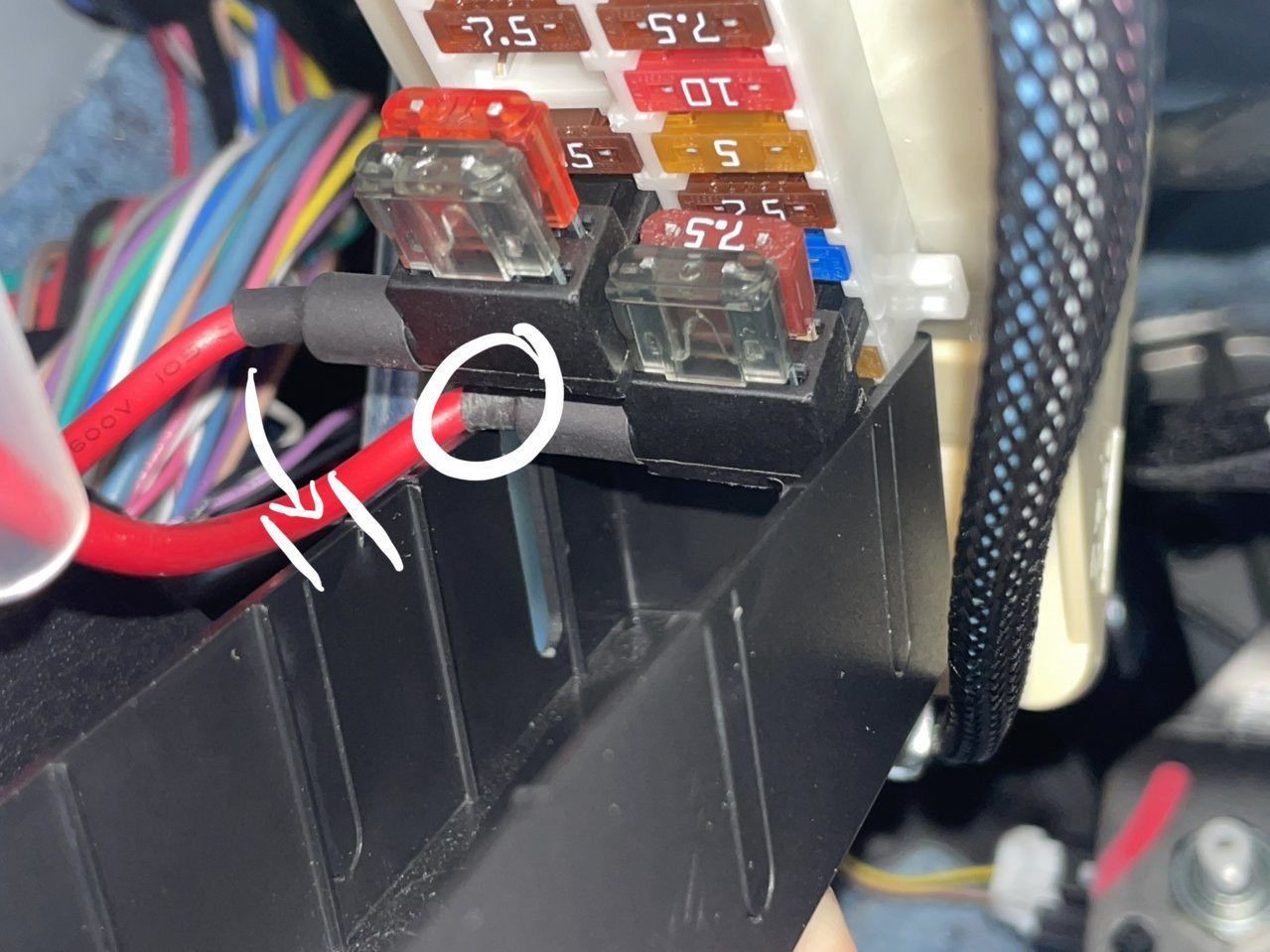

    Am I daft? I tapped the TAIL and IG1 NO2 fuses for triggers and am trying to conceal the taps with the MESO v1 fuse cover. I can’t fit the wires through the provided cutouts on the MESO cover.
    I’m about to take a hot knife to the cover and notch out my own slots. Is there a more elegant solution I’m missing?

    Nope, I had to make my own slots, in fact none of the provided slots were usable and I have 3 of them installed.

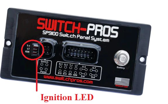

    Hey Everyone, so im wondering if anyone has any advice regarding Battery drain. ive noticed the off delay and the sleep mode timers on my switch were set to long sleep cycles. My battery last year was sucking. Then it got warm again and the issue seemed to go away. Ultimately sleep setting was set to 3 mins. Then this winter it started to get cold again, and my Die Hard Platinum AGM 24F battery was struggling to start. Once started i got it roughtly 12.5 volts which tells me that the battery was going. Had the battery replaced this morning on warranty. Then went through all the settings on the switch and found the off delay, and enabled all the switches so they woudl turn off after 1 min or second. cant remember which. In either case, the only other accessory i have that could constant draw is my Owl Cam which i now unplug once im not in the vehicle at my house. Any suggestions here?

    You can check to make sure you have the low voltage disconnect enabled in the settings, as long as you have it enabled our system will cut off all draw completely at 11v. Also make sure that the IGN light on the power module is going off when the vehicle is off, if it has any voltage on that ignition wire after the vehicle goes off the system will never go to sleep.

    do you have an image of where this ignition light is located? and if it is on after vehicle is off, how can i set it up to ensure it is going to sleep. also is there a way low voltage set to a high parameter? Anything lower than 12.5 will prevent me from turning over.

    With our new app you can adjust the low voltage disconnect, however the highest setting is 12 volts. If the IGN LED is staying on after the vehicle is off you will need to relocate your light blue ignition wire from where it is going currently.

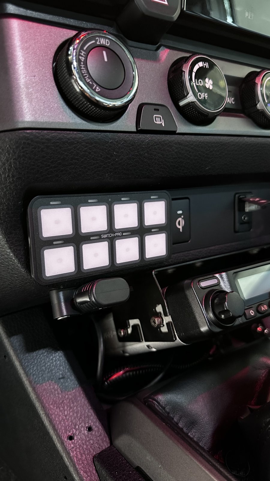

    Installed a secondary switch pro, found a nice spot for it. Since I drive a manual I installed it over where the ect power button would be.IMG_0380.jpg

    how did you mount it to the dash? It looks great
