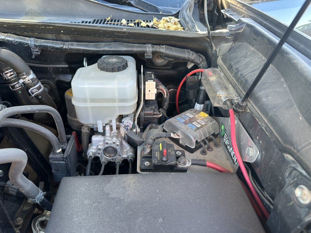

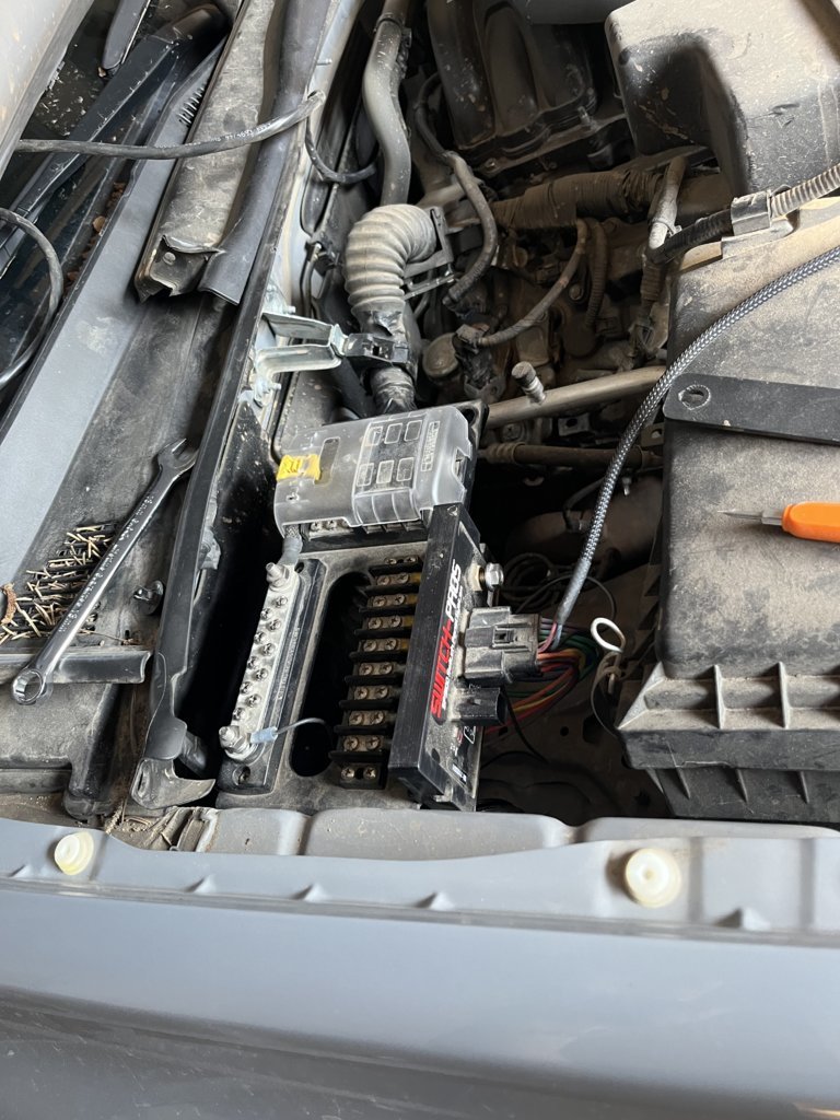

    so I have a 21 mt Tacoma and was installing my arb compressor in preparation for lockers, and decided to tackle something else while I was at it. I have had the switch pro and powertray combo for a while now. I was really not a fan of the fuse box access and the relocation of the clutch fluid reservoir. So I finally made the decision to move everything to the passenger side near the firewall.
    it was a bit more of a task than I expected but now that I have everything buttoned up I am a lot happier with the new location. I did have to flip the bracket that holds the wire harness coming out of the firewall as well as move the washer fluid hose bracket in the corner and extend the power cables. But otherwise it was not that bad.
