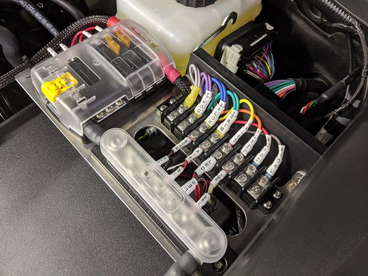

    So I will be purchasing the switch Pros 9100 and just reasearching mounting solutions and would love some feedback!
    I love the look of the power trays setup as it looks very well organized and adding/removing plug ins looks like a breeze. The issue I having is how exposed everything looks sitting upright they way it is. Especially the module. As far as the SDHQ mount seems like a better positioning to minimize water exposure, but not as clean to mount in plugs ins, ground, etc.
    Any feedback or first hand experiences are welcome.

    @solscooter thanks for the feedback. I have noticed those redline hood struts as well, but that’s far down the list of mods I would like to tackle. Being that I am not the most technical when it comes to the electrical aspect of all this i am just trying to wrap my head around the whole setup and which is more benifical/least amount of potential issues. I read up on @Powder taco install as well. Any updated photos of your finished setup? Is the blue sea circuit terminal block and ground box necessary as all
    Photos with a power tray suggest?

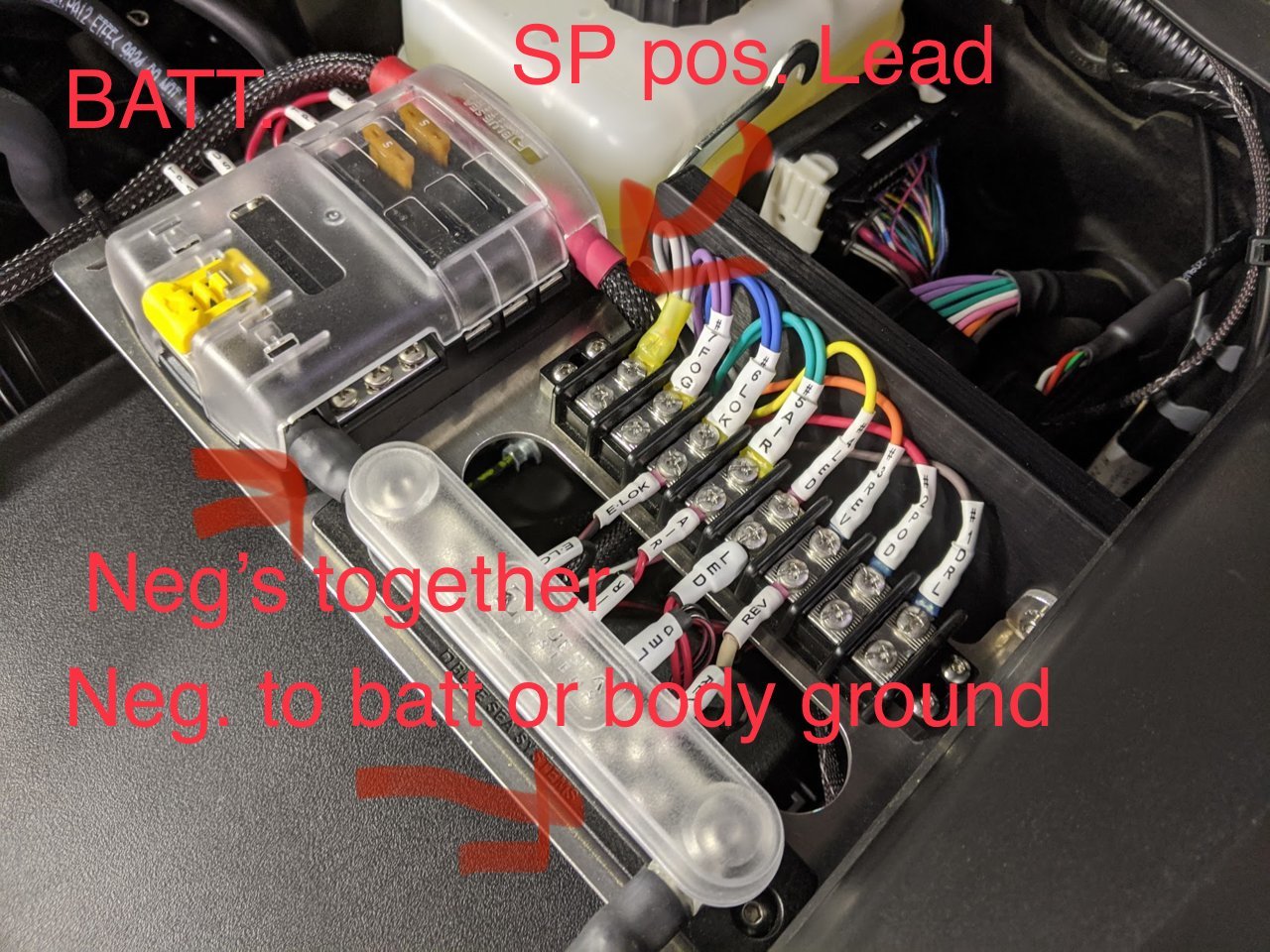

  5. Feb 18, 2019 at 1:14 PM
    Skydvrr
    Skydvrr IG: @kalopsianick
    Sep 13, 2017
    #229889
    12,647
    Nick
    YMH
    Black '17 OR
  6. Feb 18, 2019 at 1:17 PM
    solscooter
    solscooter Sh!t Outta Luck
    Nov 8, 2015
    #169056
    1,910
    Brian
    Minnesota
    2016 TRD OR DCSB 4x4
    allows you to run things that need constant power but not necessarily controlled by the switch pros. I have my CB and a set of bed lights wired to it.
    max_o and Skydvrr[QUOTED] like this.

    So with the power module for switch pros mounted that way no issue with over exposure to water/moisture? That is my fear is it frying up if something sets there for a long period of time. I know a party of the switch Pros is water proof, but the connections themselves?
    I would think they could possible void a warranty if they felt the mounting position was not to there standard?

    been through some pretty strong storms, had moisture in that area an no problems yet.

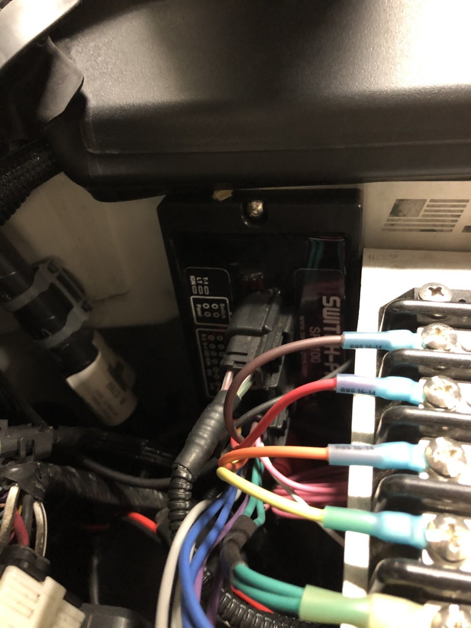

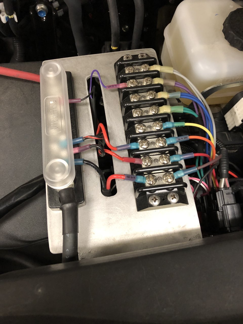

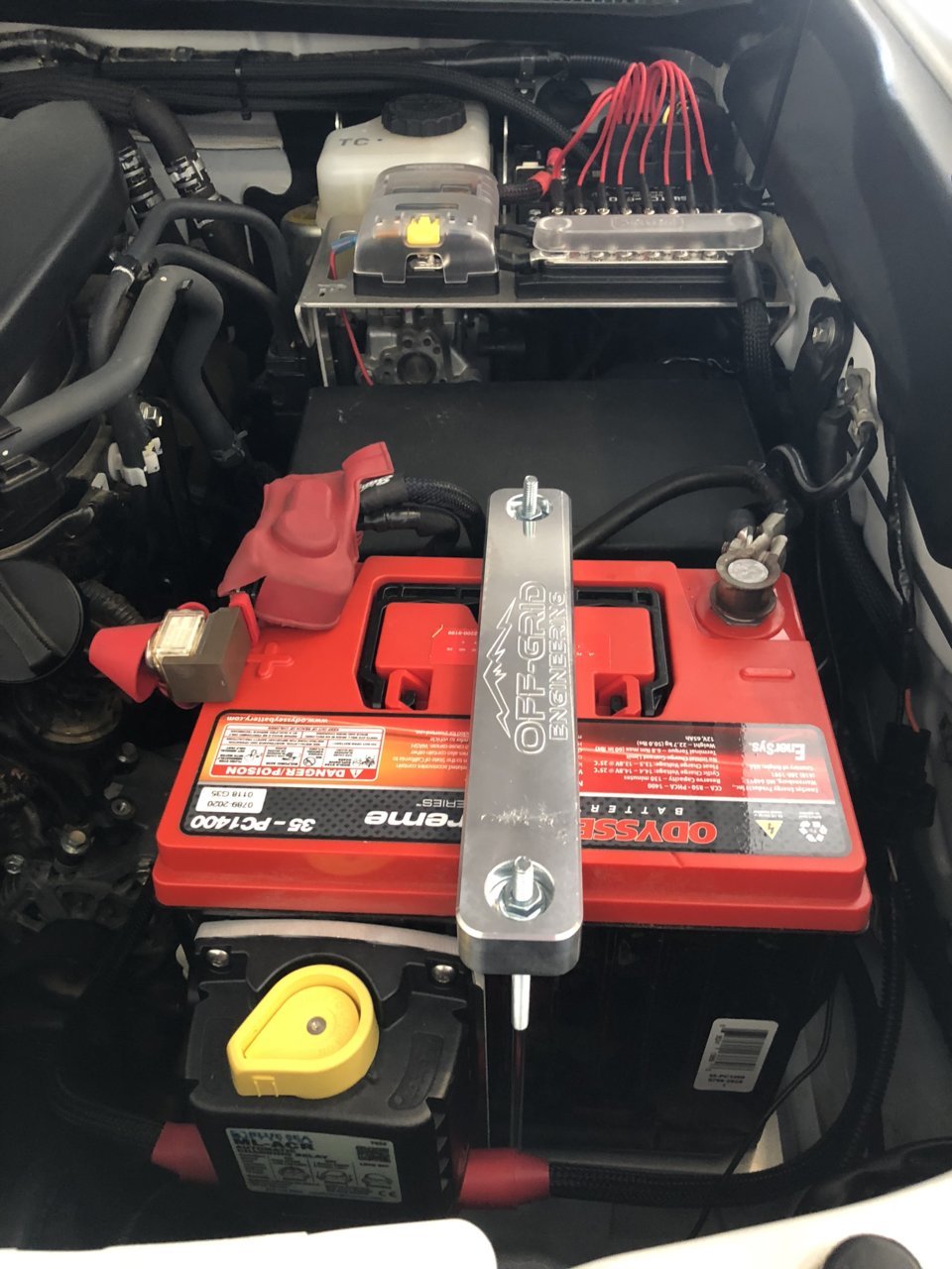

    I run the SDHQ mount and my own custom “power tray” no issues what so ever. Easy to add Accessories.

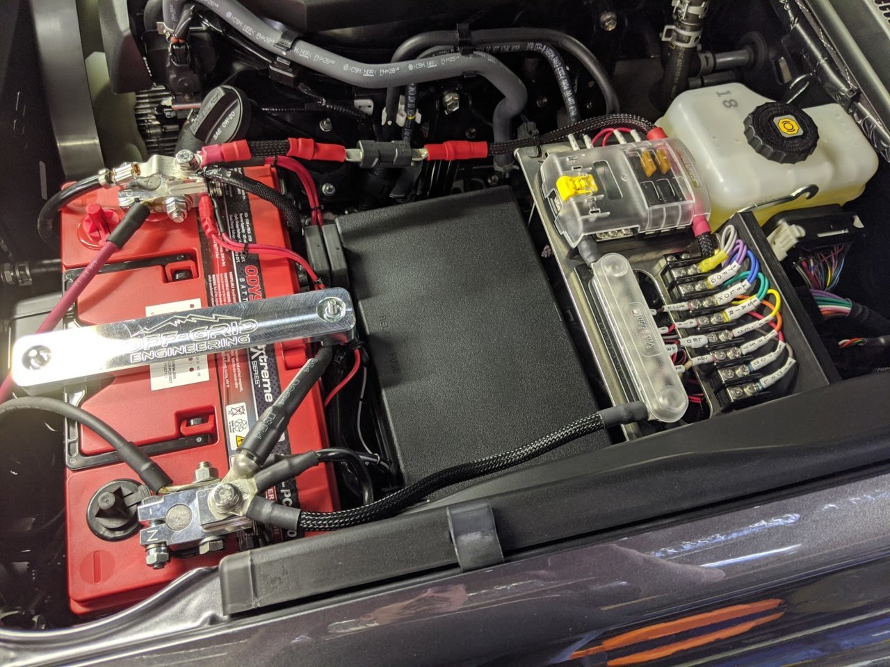

    I have no water on any of the components with the PowerTrays after some heavy rainfall or any hand washing.
    The Blue Sea is my constant power and I power a 12V gauge and 3.0USB's and my 3TPAM

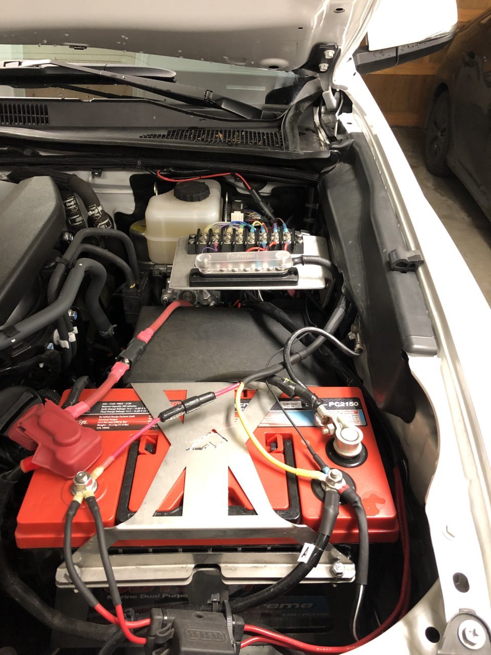

    I don't understand how it all connects into one fluid system, though. The power tray connects to battery, and the SP does too or that connects to the PT? I will be checking more threads for answers as well. Thanks
  20. May 3, 2020 at 12:55 PM
    #20
    TRDCLMB
    TRDCLMB Well-Known Member
    Aug 10, 2019
    #301836
    335
    2019 Cement TRD Off-Road
    The battery feeds the fuse block by attaching it to the positive side of the fuse block and then you just feed the switch pro from the fuse block. Switch pro will control anything you want to have as a switchable option and anything else can just be tapped off of the fuse block.
