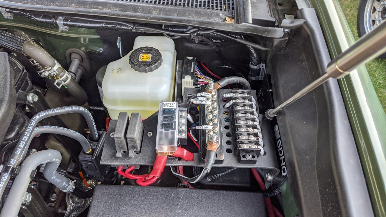

    Why don’t they make any trays for the passenger side I am running my compressor right there where all the trays mount.. arg…
  15. Mar 4, 2022 at 11:14 AM
    #35

    383
    Brad
    2018 Tacoma trd offroad
    How do you get to your fuse panel?

    Prob the same way anyone with a tray right there would. Which is not as easily as stock. I would just move the compressor.

    I jerry rigged the tray to come off with out tools.. super easy…

    Ya I’m thinking that is the solution.. Sadly..
