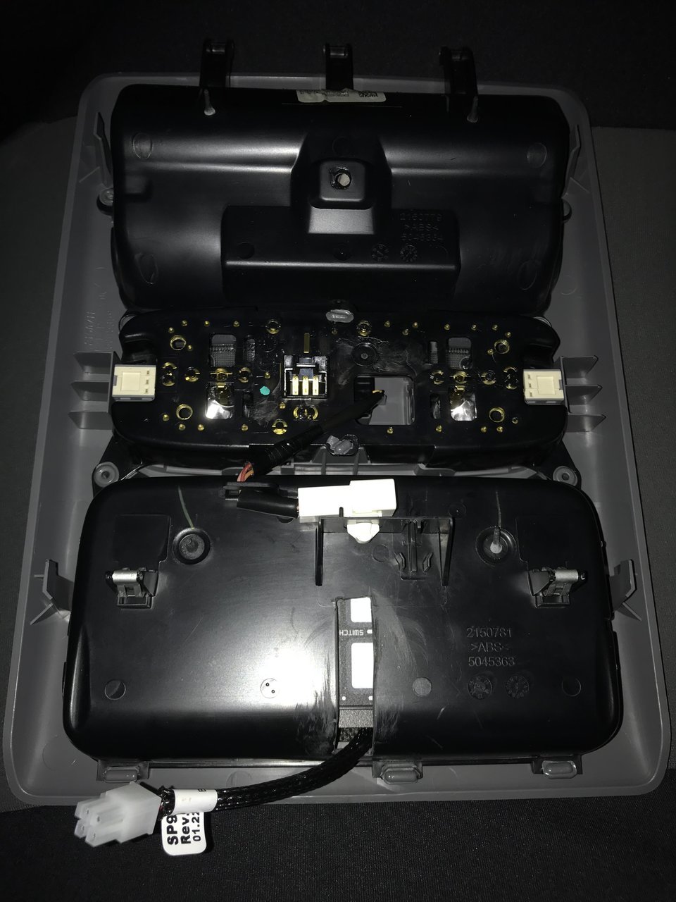

    Josh. If the switch pros doesn’t fit into the mount you may have to file it a little to get it to slip in. It is a very close tolerance fit. Also you will have to modify your console similar to what Taf Taco did on his to get it to open and close smoothly.

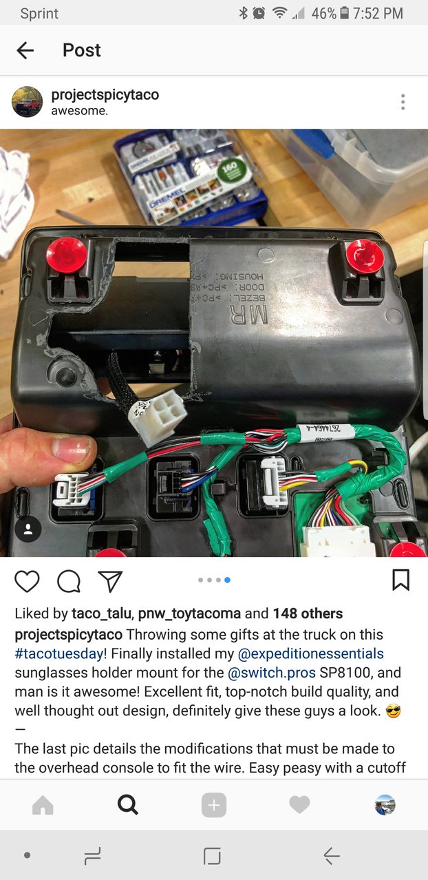

    Here’s how I cut mine (2015). Works like a charm!
    CBChief likes this.

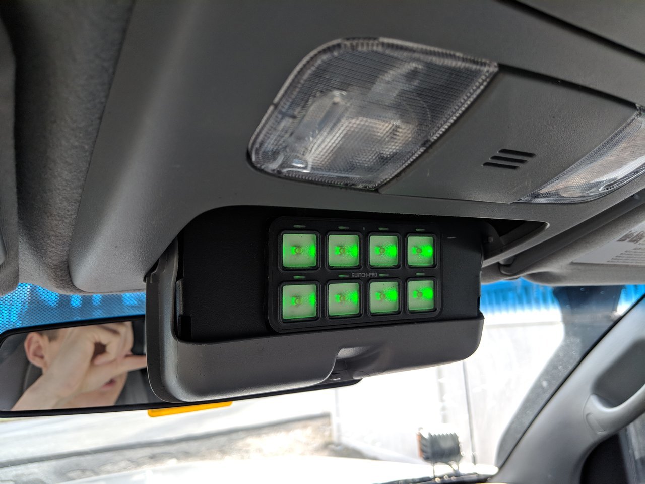

    I finally got around to installing the mount.
    Had to dremel 1/8th of an inch out of the the top and sides of the mount to get the switch pro controller to fit.
    Still need stickers for the buttons.
    Also does anyone know if there is going to be an app update for Android devices? Has anyone been able to control theirs with an Android phone?
