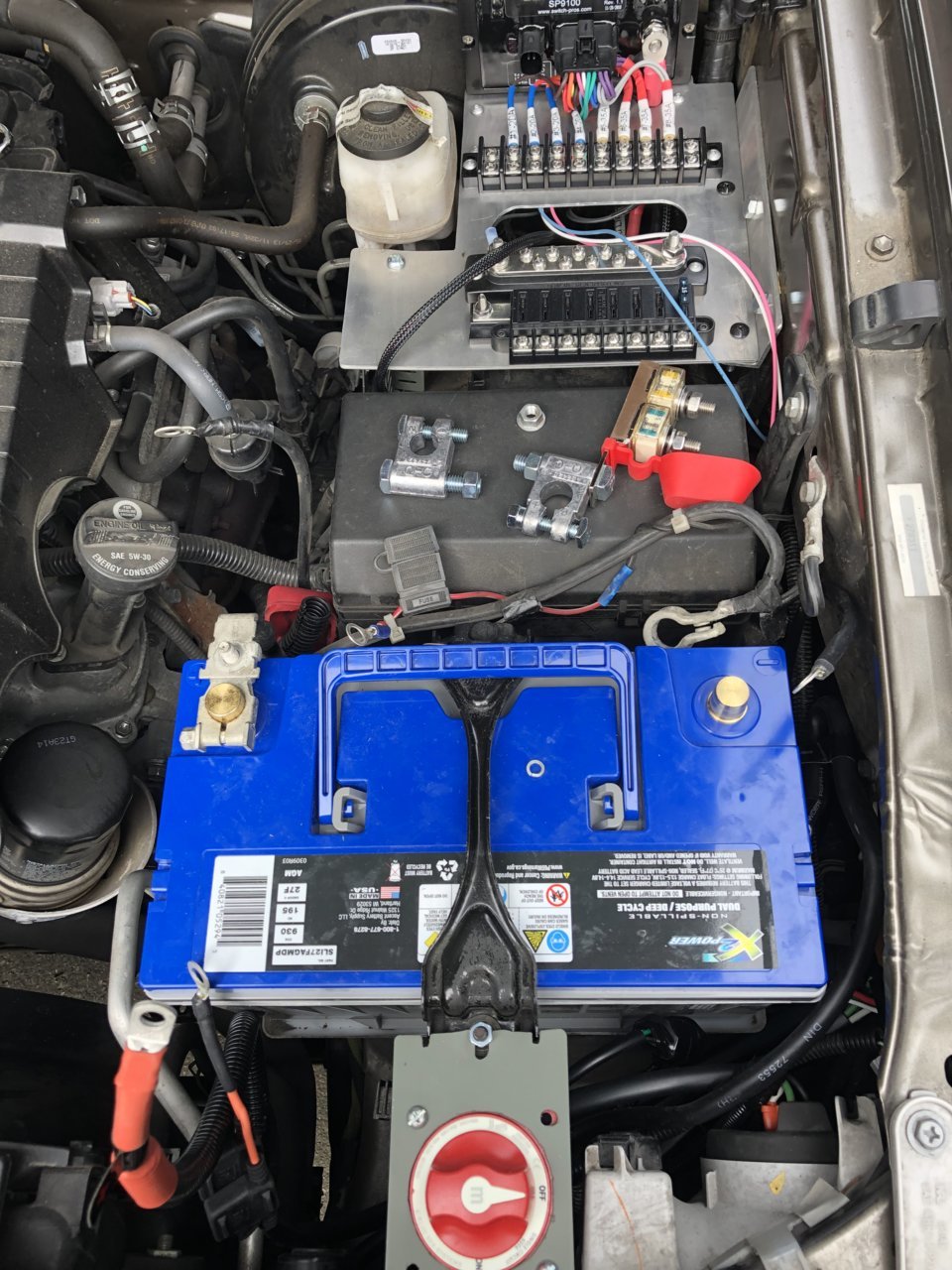

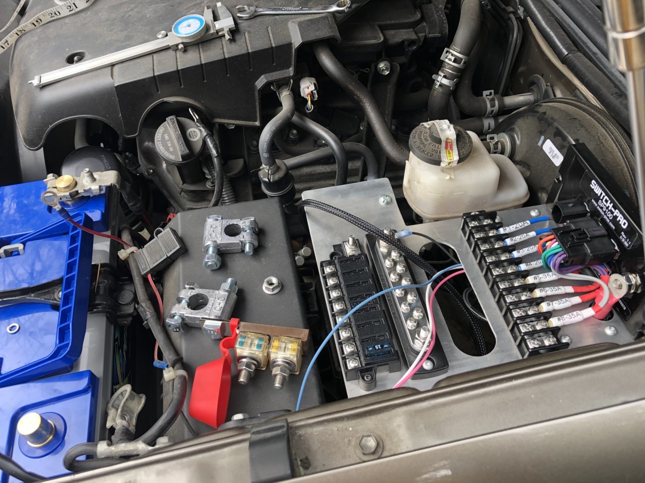

    Just for some info to start I used the expedition essentials bed mount and purchased the wiring extension from them with the switch pro adapter for the compressor and lockers.

    Got stuck with stock battery wires. I want to use new military style terminals and I’m not sure how to connect stock pos/neg

    I'm not 100% on what you're trying to do, but I ended up making my own battery cables for the main stuff. Then used some audio battery terminals that accept the OEM style cables and there are inserts for a few more wires. That way I could connect the Switch Pro and not have a billion terminal rings connected to that one bolt. Does that help? I can post a link to the battery terminals....

    I'm trying to use the military style battery terminals which have two bolts sideways. The OEM style has one bolt pointing up. I can easily increase the hole size with my step bits but not sure how to bend OEM metal 90 degrees to attach to sideways bolts... clear as mud?
    Basically if I bought a good quality hydraulic crimping tool I could extend OEM cables and attach a new ring terminal.
