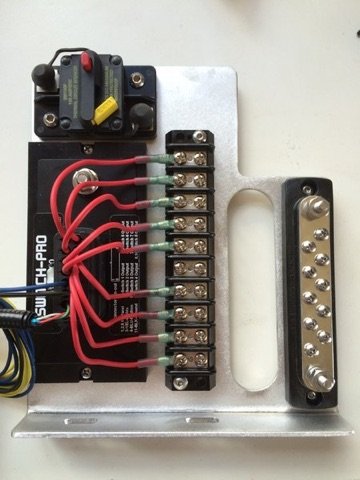

    Hey guys I'm thinking about mounting my switch pro like this with the terminal blocks as shown (minus the circuit breaker). Any positives besides wire management? Any other recommendations?

    yes, I have done the mods
    is this your plate? Did you make this, or find it online someplace? This is exactly the layout I want to set up, with two terminal blocks.

    No I found this online. I was going to make something very similar to that though minus the circuit breaker
