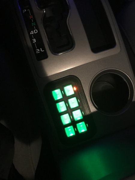

    Mounting the switch here thanks to @XPOTRPR flush mount bezel.

    Got everything mounted and hooked up today. Can't seem to get the switch plate to dim when the lights are turned on. But everything else works great.

    I used a random wire in the fuse block that I knew was gonna be ignition dependent. Just dont use the A/C one since that won't work lol
    Check our T-tap. Mine did the same thing.
    I used the corner light on the headlight as my dimmer lead.

    Yeah thats exactly what I did. But for some reason its not wanting to dim. Not sure why or why not. I even checked to see if the blue wire in the corner lights turned on when plugged in and it did. But then when the yellow wire is in it still doesn't want to dim.

    its possible that the yellow wire came loose from the main connector piece, you could try wiggling the base of the yellow wire...

    My yellow wire is tapped into my running lights and dims.

    I tapped both in the fuse block in the dash using add-a-circuits. I prefer to keep my factory wiring as untouched as possible.

    I spliced into my fog light harness. One of those wires energizes when your lights are triggered... Ignition power I used the fuse tap that they supplied and found a port on the fuse box that powered up.
