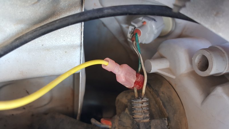

    > BUILD LINKS >
    NOTE: this is specific to my aftermarket headlights. Your DTRL harness/wire may not be the same..

    Did you have to program the switch to dim when your headlights turned on? Or just hook up the blue wire and yellow wire and was good?

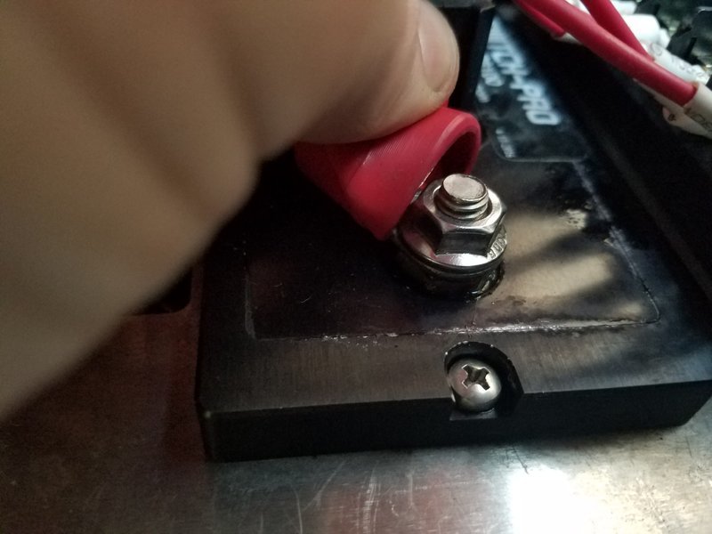

    Question for the 12v DC pros. I found some corrosion on the positive terminal of the "brain " . I'll add a a pic but I already cleaned it with some vinegar.
    I familiar with corrosion of a negative terminal indicating under charging and corrosion of a positive terminal indicating over charging but what would have caused this? my battery is clean and my SP8100 is about 6 months old.

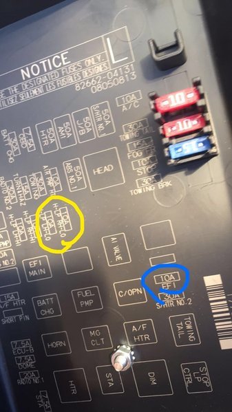

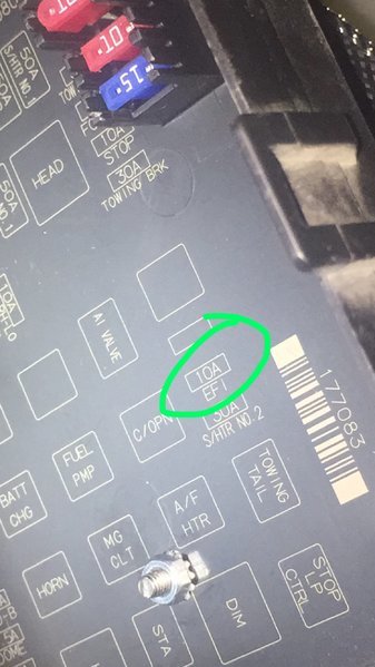

    I would contact switch-pro. That EFI fuse is only 12 volts when you turn the key to the on position should time out about 5-10 sec after you turn the truck off. Dimmer just needs a 12 volt source when you turn on your marker lights or headlights.

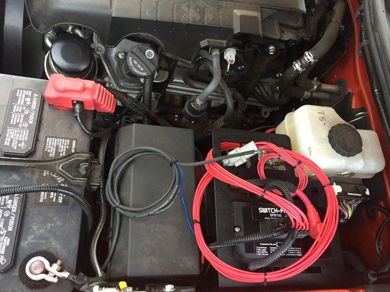

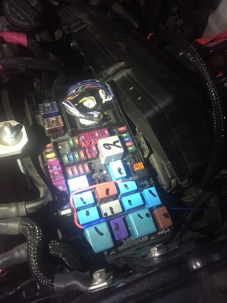

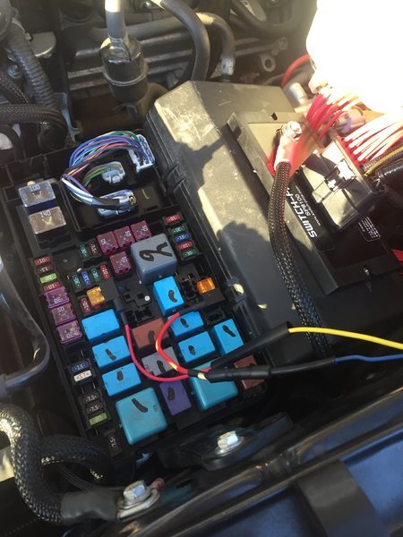

    Great news. Installed the blue wire into the ACC fuse under the driver side fuse panel, and the yellow wire on the Low Headlight fuse on the main engine bay fuse panel. Dims and brighten as suppose to :thumbsup: Also finally got it to program.

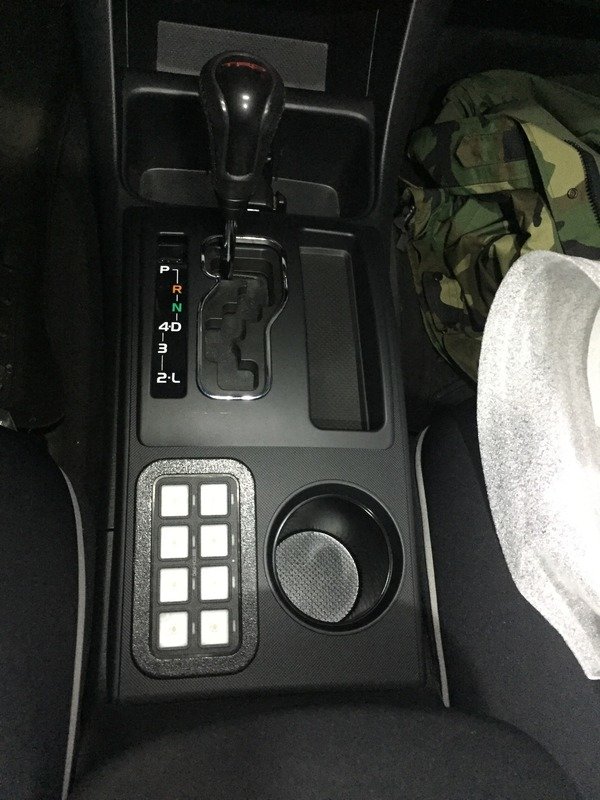

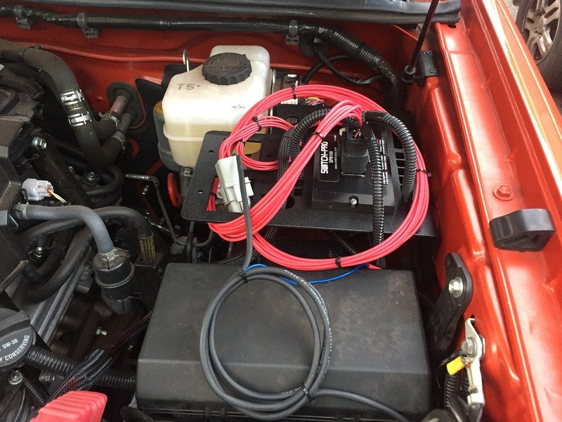

    That flush mount from @XPOTRPR makes everything flow together. 3 coats of self etching primer, and 3 light coats of Rustoleum bed coating. Has that textured feel to it.
    49DD96A6-9A07-45DD-88C7-EA2F1AE90062_zps_84fcd496bfc4bb2117642f56a371dd33e829b143.jpg
    4C391A9C-71AB-4B72-8A2C-CABD8549AC74_zps_2ac608b263d26197c791b129dd2773ab581a4e17.jpg
    It ain't as clean as some ya'll but it'll do for now, looks like a freackin spider web haha. It's pretty organized though. Used an 8 pin Deutsch waterproof connector just to organize all the wires into 1 simple connector. Fuse panel from Pelfreybilt bolted up with no problem.

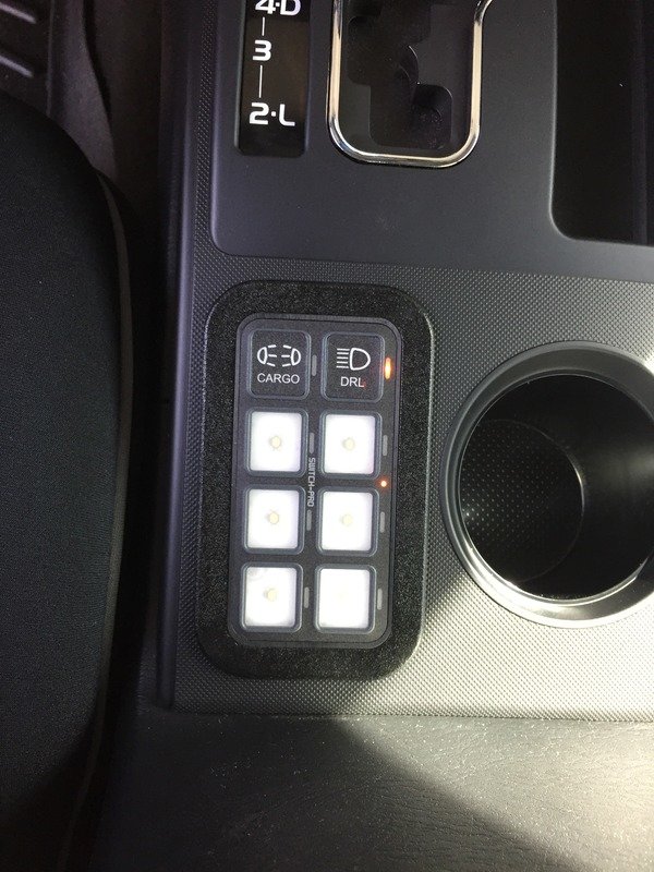

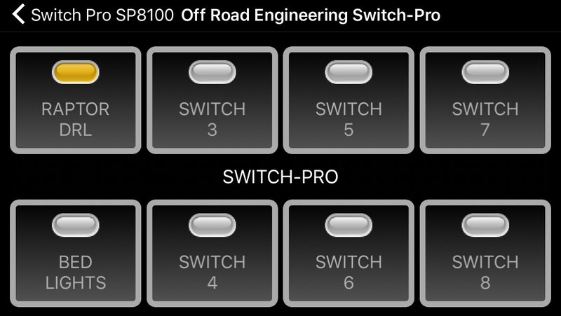

    Update, BT works with my iPhone 6 :thumbsup:. It's actually a lot easier now to program the switches.
