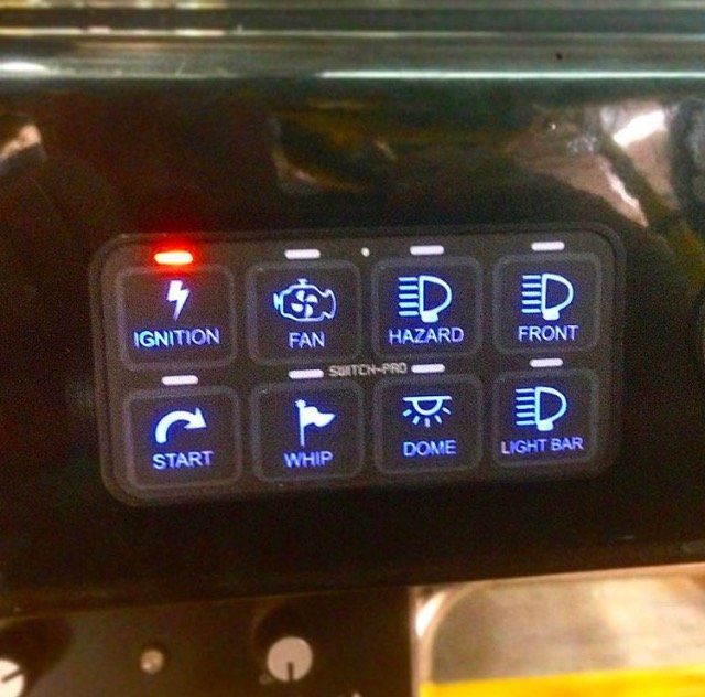

    Seen this on IG last week. They'll make it in blue, but not in cool/pure white, c'mon man!! I've asked them why not, their only excuse is that their not currently working on white background. Which is probably BS imho. For that price at least give us options on colors. If there's a way to take apart that switch panel and change those led's out I would, but it looks like the panel is sealed.
    Funny thing is this ain't even available on their main website, they have certain dealers that only carries them.
    C269AF0E-B56C-4816-850B-3F84235E8988_zps_4a2d3d3ff834ba67b7a54c3b78f35e0cf1177c0e.jpg

    Just got the new blue switch panel installed. The TRD sport has a perfect place for it as you can see. No cutting necessary.
    IMG_0937.jpg Love this company, awesome customer service!
