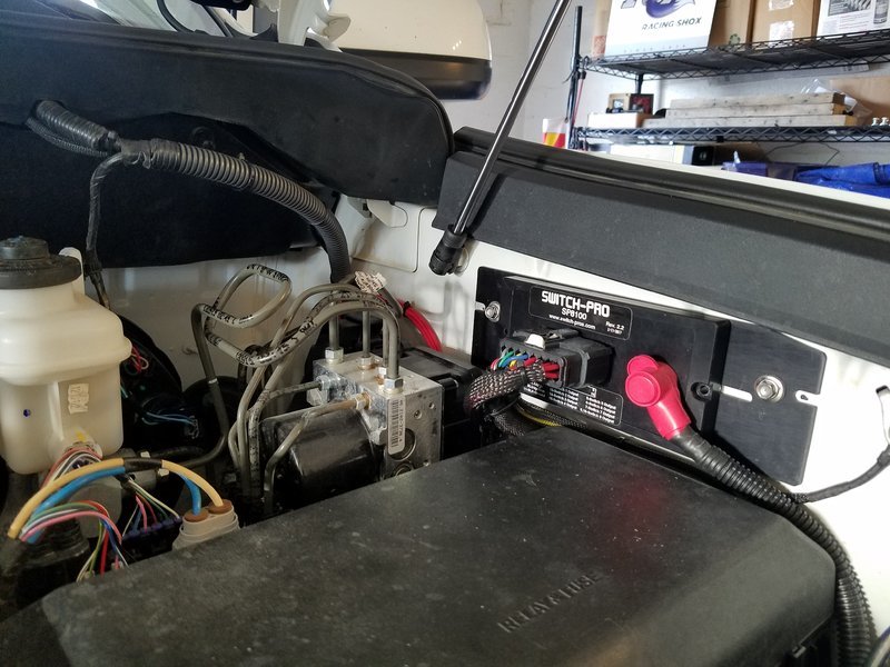

    JerryTaco
    JerryTaco Well-Known Member
    Jan 28, 2013
    #96315
    6,862

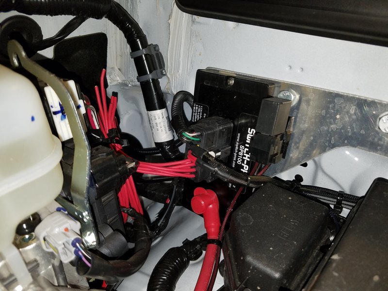

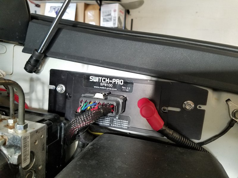

    Pretty cool thread! Here's a few pics from an install I did this weekend. I'll get some.pics from my truck as well.
