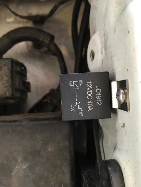

    Ok guys, so I tried various things and still with the same problem. However, I did successfully get through a bomber of Goose Island BCBS last night, so that's a positive. The relay is mounted on the quarter panel. Included a picture of the relay. So here's where I'm getting confused despite all of the great support I have received so far. I honestly can't thank you guys enough, I know I'll get this figured out eventually.
    The relay provided to me from @CaliRaisedLed has 3 bundles of wire. One (87), going to the light bar. Two (30), a red and black wire going to I assume, the positive terminal on the battery and a ground. Three (86) has 3 wires, a white, red and black that go through the firewall and into the cab to work the switch. I have wired the switch according to the schematic provided by @windsor and the switch still has power regardless if red 2 is attached to the fuse box. The switch even has power if the truck is off. I tried putting the tap in to the fuse box in the cab, 1 left (guage) and the icon on the switch stays lit but the lettering "bumper light bar" turns off and on with the headlights / drl etc. However, the switch still has power regardless truck on or off. I'm assuming I need to move the red wire that is currently attached to the positive terminal of the battery to correct this? I have not tried to connect the green wire on the switch to anything else either. If I do attach it to the fuse box, what do I do with the white wire coming from the relay?

    @PlankRider6 First, your description of the harness has me a little confused. Can you take a picture of the bottom of the relay plug (where the wires go into the plug).
    Ok. I'm working heavily medicated, so this may take me a bit to figure out. Unplug the harness from the switch. Set your DMM to DC voltage (solid line above dashed line). Either hold or use alligator clip to ground the black lead to a good ground. Use the red lead to test each of the wires on the harness. What readings do you get with each color?

    I finally figured it out! Thanks to a lot of help from @windsor, can't thank you enough.
    1. The red wire from the relay should be connected to the green wire
    2. The white wire from the relay should be connected to red 1
    The fuse tap is connected to the tail light fuse as shown in the instructions or any other fuse that you choose that turns on with the ignition. The instructions provided by CaliRaised are INCORRECT. I notified them of this, I hope they correct it for other customers with the same problem. Clearly I wasn't the only one.
