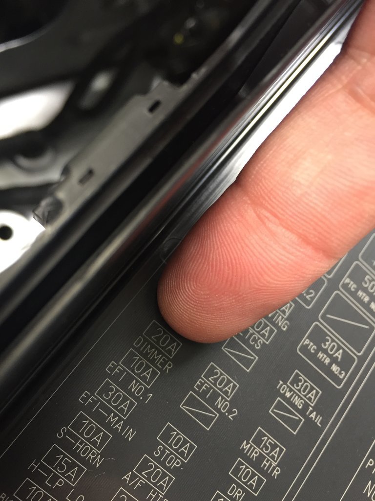

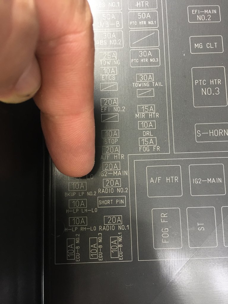

    So, it seems that the best ( only ) option is to tap into the tail light fuse under the driver's kick panel. yes? For now I'm going to leave it but I have it wired if I ever decide to hook it up.

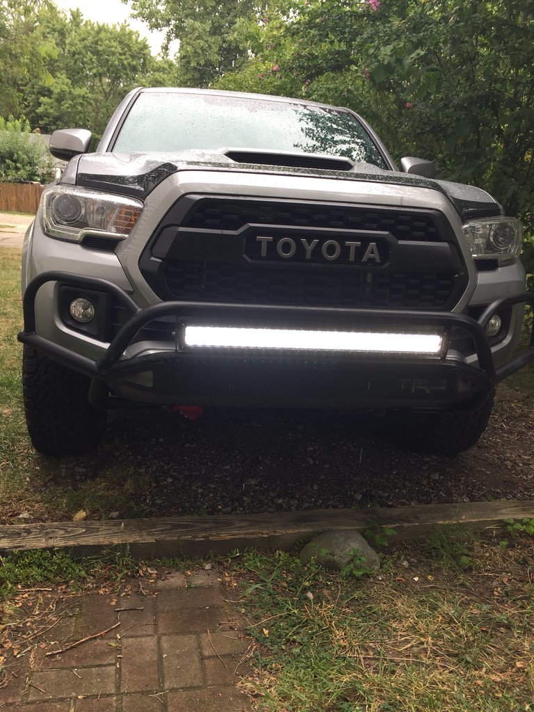

    Also - the Caliraised light bar came with a 30A inline fuse wired into the harness. That seems like overkill to me no? I swapped it for a 20A and it didn't blow. Is there any reason why this is a bad idea? OR... should I go even smaller? Thanks everyone for your help (knowledge, schematics, drawings, photos, input...)
    My light bar IS live even when the truck is off. Is that a bad thing?

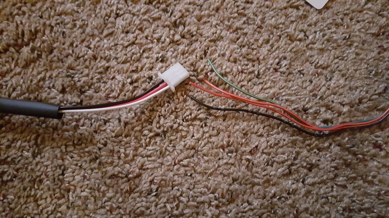

    Ok, from my playing around.
    1-Green/yellow= power from 12v source
    2- Red/yellow1 = ditch light symbol
    3 Red/yellow 2 = "ditch light" letters
    4- Ground
    1 is power, 4 ground hooked up.
    switch off, (not depressed) no illumination. UNLESS you were to wire pin 2 to an illumination (interior lights etc) , then you get the picture when the lights are on.
    switch depressed, "ditch light picture" lights up, NO illumination from the letters. (just pins 1 and 4) 12v
    switch depressed, both pin 2 and 3 are connected (combined out to relay coil +) ALL light up
    i ended up attaching the pin 3 (ditch lights lettering) to the green wire from the dome light switch near by so when the lights come on, the lettering lights up like the rest of the stock switches.
    i used Pin 2 to activate the relay to turn on the lights.
